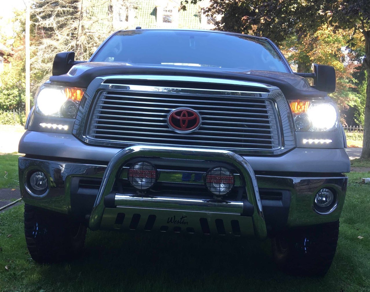

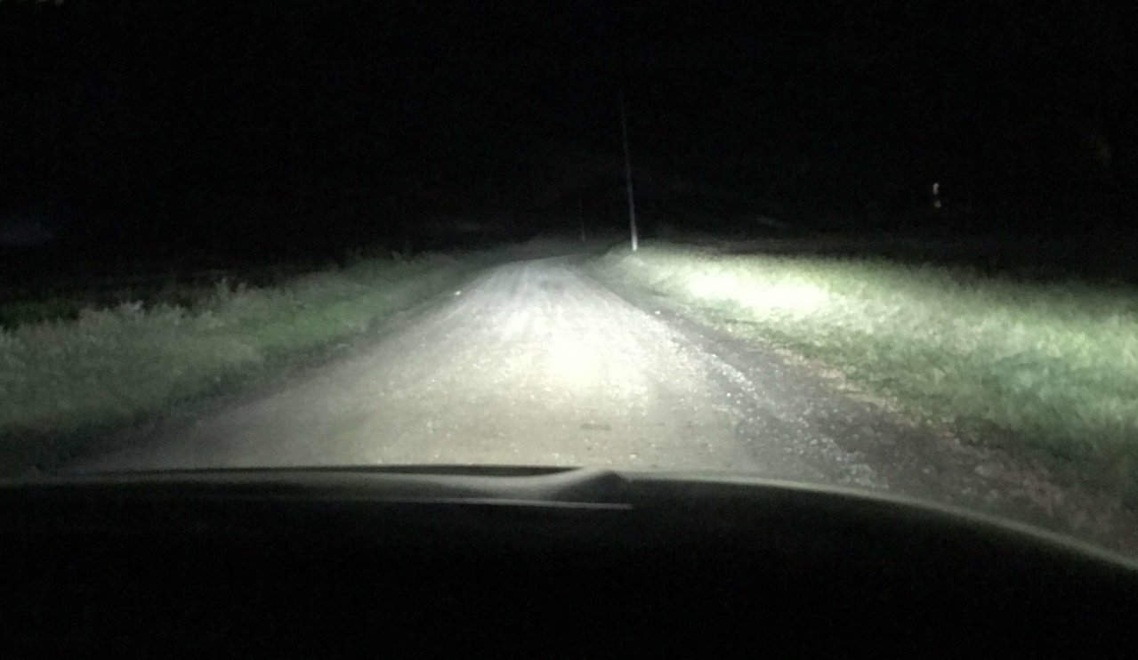

    I installed Hikari Ultra LED bulbs (H 11) on my truck. (I find that it is impossible to install these without taking the headlight unit off the truck. The back side is just a bit too long compared to the stock bulbs) I like the look and they do seem to illuminate quite well.
