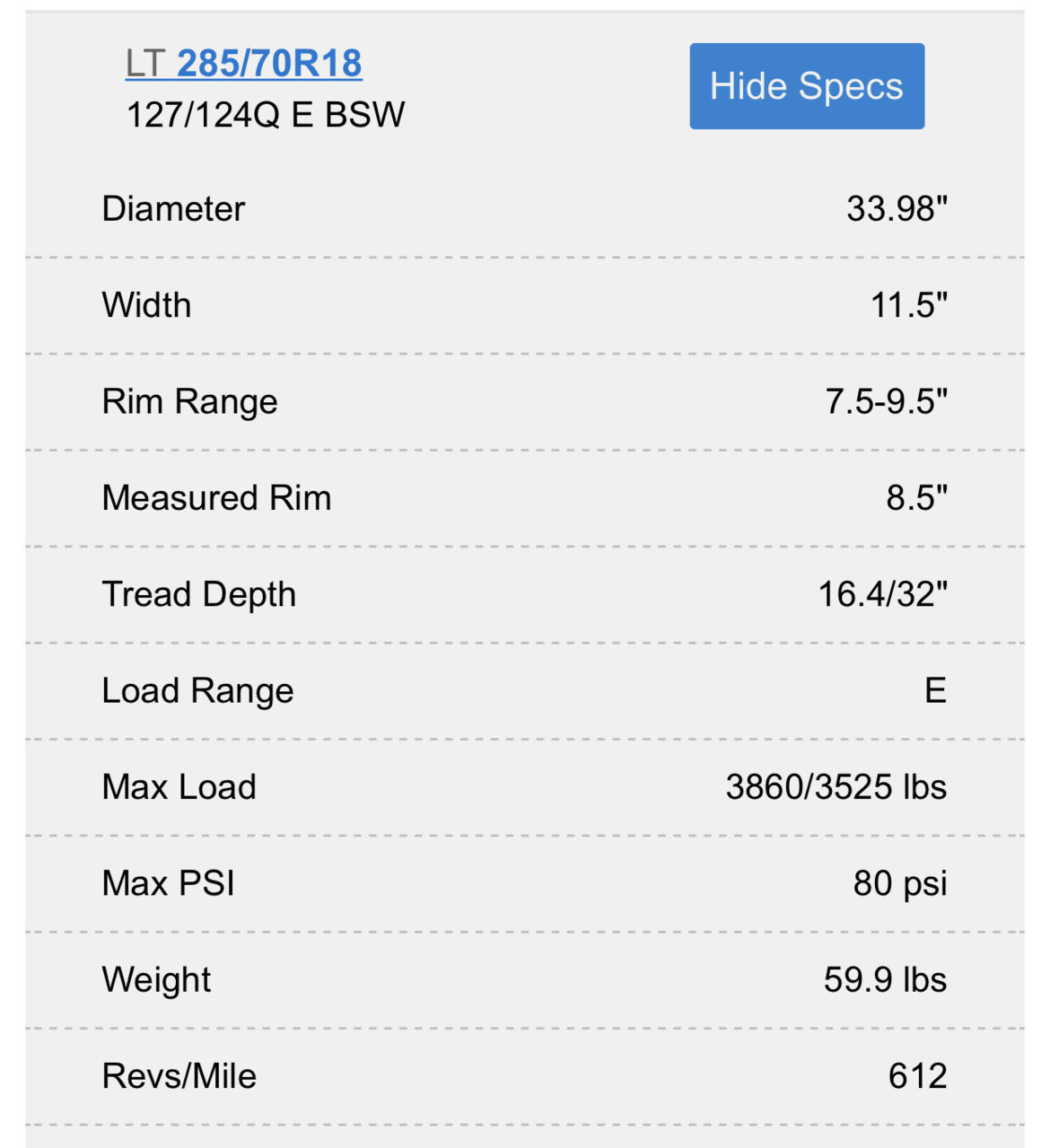

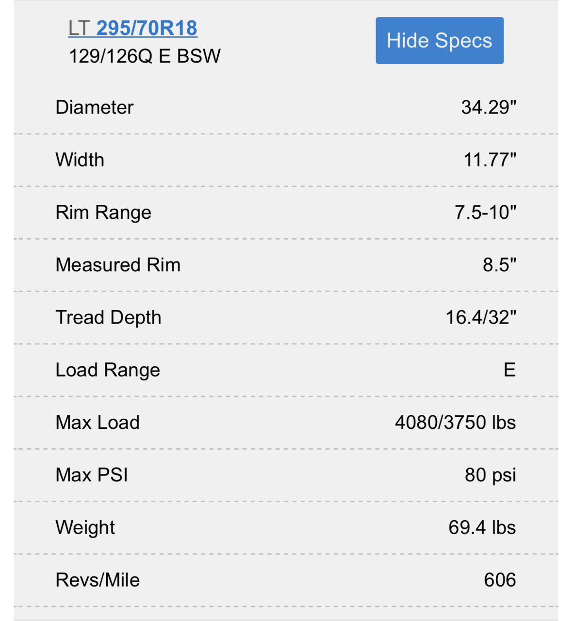

    I’m caught in the vortex.... going to buy tires and rims tomorrow and I can’t decide between 285 or 295.
    I have decided on Nitto RG and Method NV305 Bronze tho.
    285’s look to be close in size (see Nitto chart) and lighter.
    Again, my setup is 6112 top setting.
    Can anyone see a big difference im missing and go for 295?

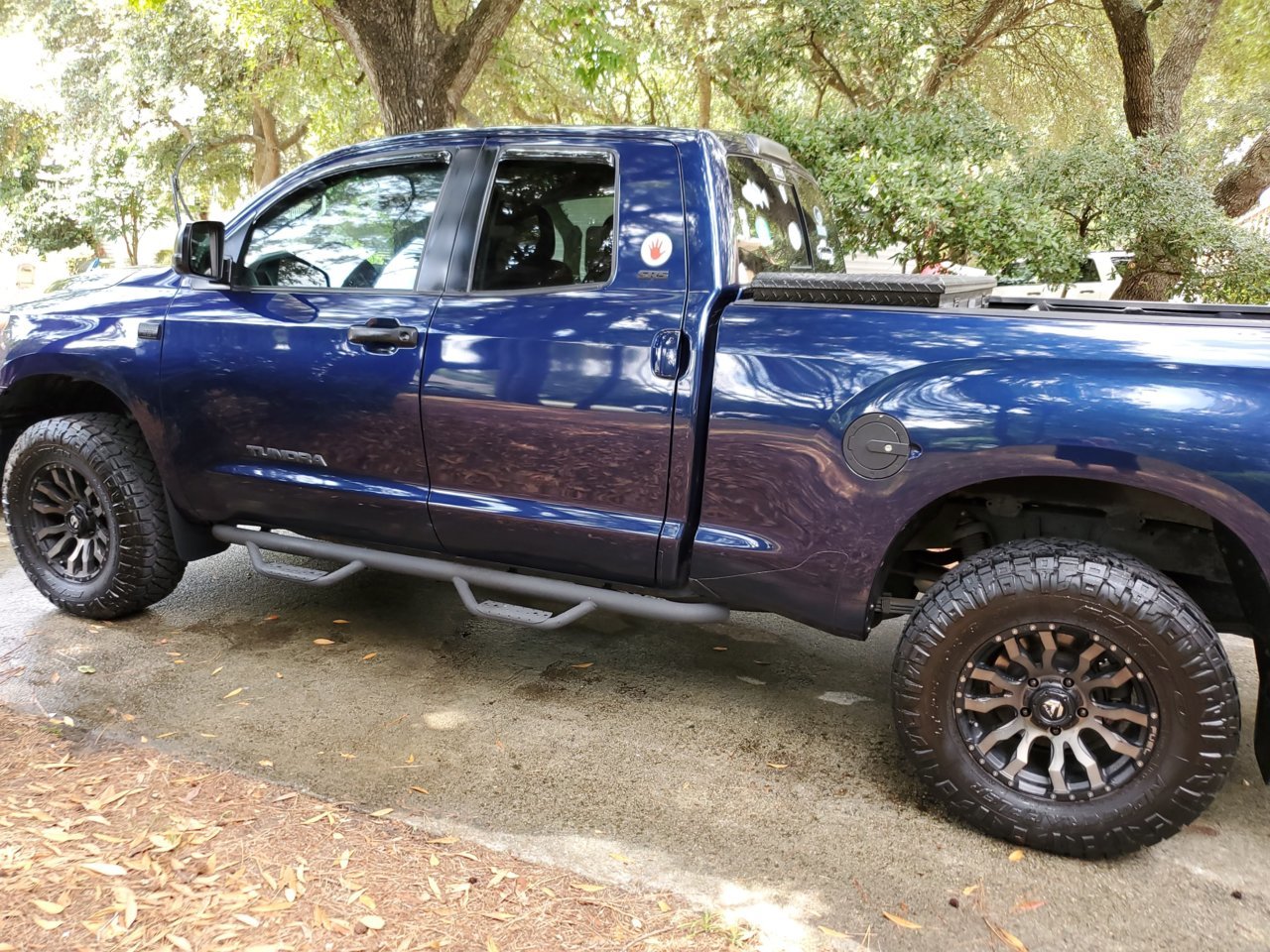

    Either or. I went with the 295/70/18 Ridge Grapplers. 6112's top setting, 5100's in rear. Fuel Blitz wheels are +20. slight rub passenger side front. Most members are running the 295, haven't heard a lot on the 285?

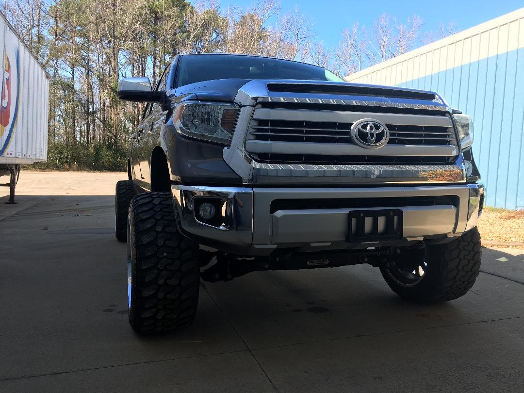

    1794 Lifted
    35's on 22x14 with 6inch lift
