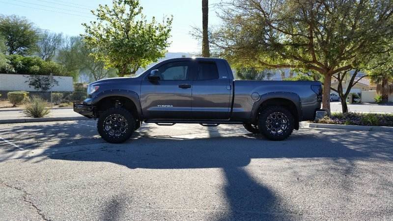

    164,655
    What's the height difference in the front from the rear?

    5" front, 2" rear.
    I'd like to bring the rear up 1", but that'll mean either: replacing the new shocks for some w/ longer pistons, or a bracket moving the existing shock foot, higher.
    Reason being, I'll be close to locking out the rear if I go another inch higher.
    IF...if she settles about a 1/2" (as to be expected) in the front, I won't worry about the rear.
    Any suggestions???

    Nice. Yea I would crank the coils down in the front a 1/2" or so to be level and avoid additional cost in the rear.
