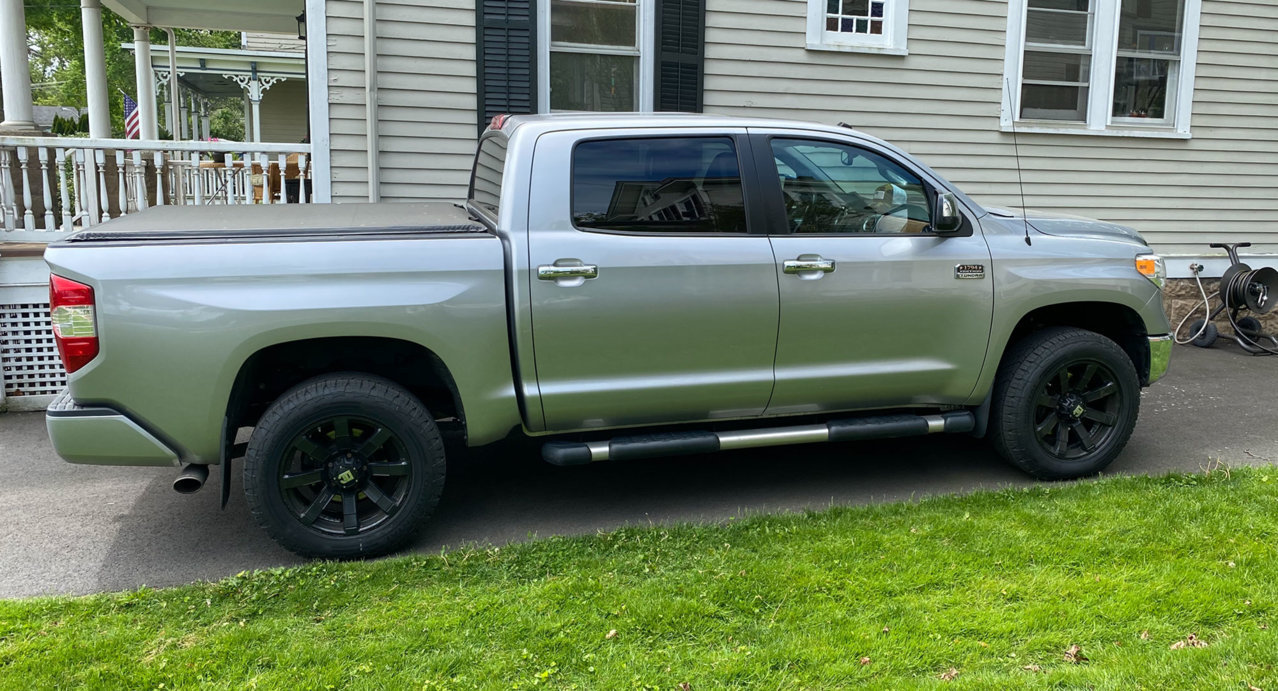

    hey guys, first post here. First of all I want to say thanks a bunch for all the knowledge, wisdom and experiences you all have taken the time to post on this forum. Incredibly helpful, and also incredibly dangerous...on the wallet! But you already know that so....
    Anyhow I have a '16 1794 and wanted to lift the front a little/decrease the rake -- not totally level because I tow a boat. I also wanted bigger tires on the 20" rims -- I had the stock 275/55R20s on the Dick Cepek wheels I took off my old Sequoia that had 240K miles. Wanted bigger tires for the visual and for a slightly softer ride, which was my big goal with this whole thing because I have a lower back that flares up -- under the knife for it a while back.
    Anyhow:
    I bought Bilstein shocks with 12K miles on them from a guy who I believe is a member here because I found out he knows it's a dangerous place too lol (thanks Phillip!). Got the okay to buy 'em from a mechanic buddy of mine -- 6112s up front (1.3 setting), 5100s on the back.
    Had them professionally installed. With the stock shocks the truck was level or close to it (I didn't measure that exact), but when the Bilsteins were installed it was 1/4" low on the driver's side. Honestly it might have been the same before the install (1/4" is tiny) and I would have let it go after the Bilstein install. But since I have the big gas tank that was almost empty and got some CoachBuilder shims in the deal, the shop recommended putting 1 of those on the driver's side -- no charge so how could I refuse.
    Driving impressions after a week+:
    - Everything seems better with a more-level truck except for maybe a little mpg. Looks better, feels better, rides better. Yep some of it's the "new' shocks and tires, not just the more-level stance, just giving you my impression.
    - The Bilsteins make the truck feel a lot more solid...maybe "heavier" but not in a bad way. I've read here that Bilsteins make the truck feel "planted" to the road and it does. Not as much bounce and softness, but also NOT stiff, though bear in mind these shocks did not need to break in.
    - The truck takes bumps and potholes way better now, which like I said was one of my goals because of my lower back. I'd been feeling the bumps and potholes way too much.
    - I am not a shock expert by any means, but can say that whenever my next truck happens it will have Bilsteins or similar aftermarket shocks on it. No doubt. Haven't towed with it yet but I can't wait. I should add that I always buy used vehicles....
    Now to the tires:
    - I wanted to go up a size -- to 275/60R20s. Mostly for more air/a little softer ride, but also for looks. Actually I strongly considered going down to 18s for much more air but can't afford the wheels I want.
    - I did way too much research on tires. I've been a Michelin guy, usually the best in my experience (sometimes they wear too fast), but I wanted to try something different -- mostly an A/T tire that also looked better.
    - I am a 90% highway/road and 10% everything else guy so I needed that kind of tire. I considered the Michelin LTX (what I had before), a Pirelli Scorpion A/T and the Continental TerrainContact A/T.
    - Really the Michelin was my backup if I got red-flagged out of the other 2. After way too much interwebz research, finally asked my mechanic/body bud which one he'd get between the Conti and Pirelli and he said Conti. Done. That tire also has great reviews on TireRack.
    - So far the tire is exactly as reviewed, though no rain to speak of since I got them. They're solid, comfy, look good and they're quiet on the highway which was a big concern for me because I'm a little OCD about noises.
    - From a video by the Campus Automotive guy on YT it looks like this Conti tire is taller than other similarly-sized tires. So even though this tire I guess should fit no problem with stock suspension (and I believe it will), the front tire forward wind "flaps" had to go, and fully turning the wheel (like when reversing out of a driveway) will get some loud rubbing on the actual mudflap. Not a big deal.
    - Never had an issue with Michelins on those rims but the shop had the truck for a couple days because the Contis didn't want to stay put location-wise on the back wheels. The shop finally had to mount them with no tire lube (whatever it's called) so they wouldn't slip. So far so good.
    I think that's everything I can think of. Please lmk if you have any questions about any of this.
    Trying to not do anything else to my truck...except next are the 2018-19 headlights/harness, and maybe lower-pro black running boards. Would love to get rid of all the chrome on the nose but that's lower down on the list -- honestly doesn't look too terrible with the silver color of the truck.
    Thanks again fellas!
    - Jay
    Sorry not the greatest pic, will take a better one soon

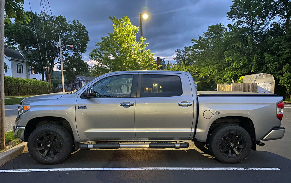

    Better pic from this eve. On flat ground, to my eye the truck looks almost level at the 1.3 on the Bilsteins
