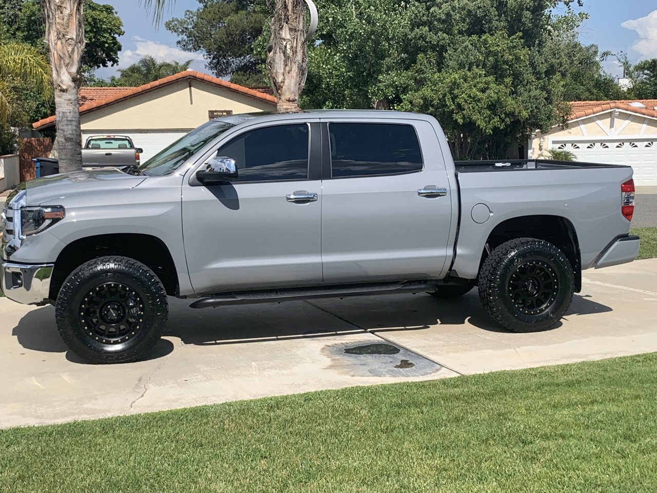

    1E2683DD-A4A2-4616-9D49-194E91C4B756.jpg I have the Toytec BOSS kit with SPC UCA’s, 18x9 Method NV at +25 offset and 295/70/18 Toyo AT2 Extremes. I did the install myself and I am right below your $4k mark. I also left about 3/4 inch of rake in the rear for towing and the cruise control radar and collision sensor. All sensors work fine.

    Good to hear all the electronics work with that little of a rake. Newbie question....Is positive or negative offset outside the fender? Think one could clear with 295/70/18s with 0 offset? I don't want all the road grime slinging up on the side of the truck.

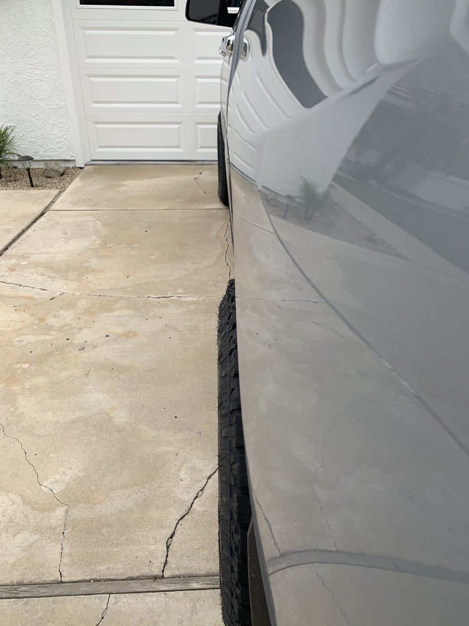

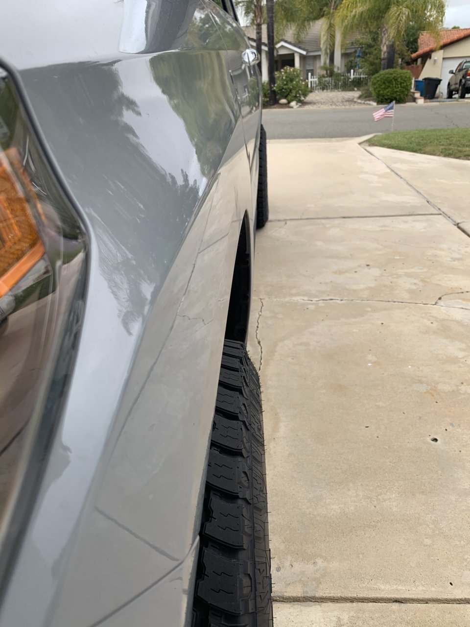

    0 Offset would still clear but you will get grim all up and down the sides. I would do anything with a +18 to +30 offset. The + offset brings the tires in more into the finder well. This this my +25 offset.
