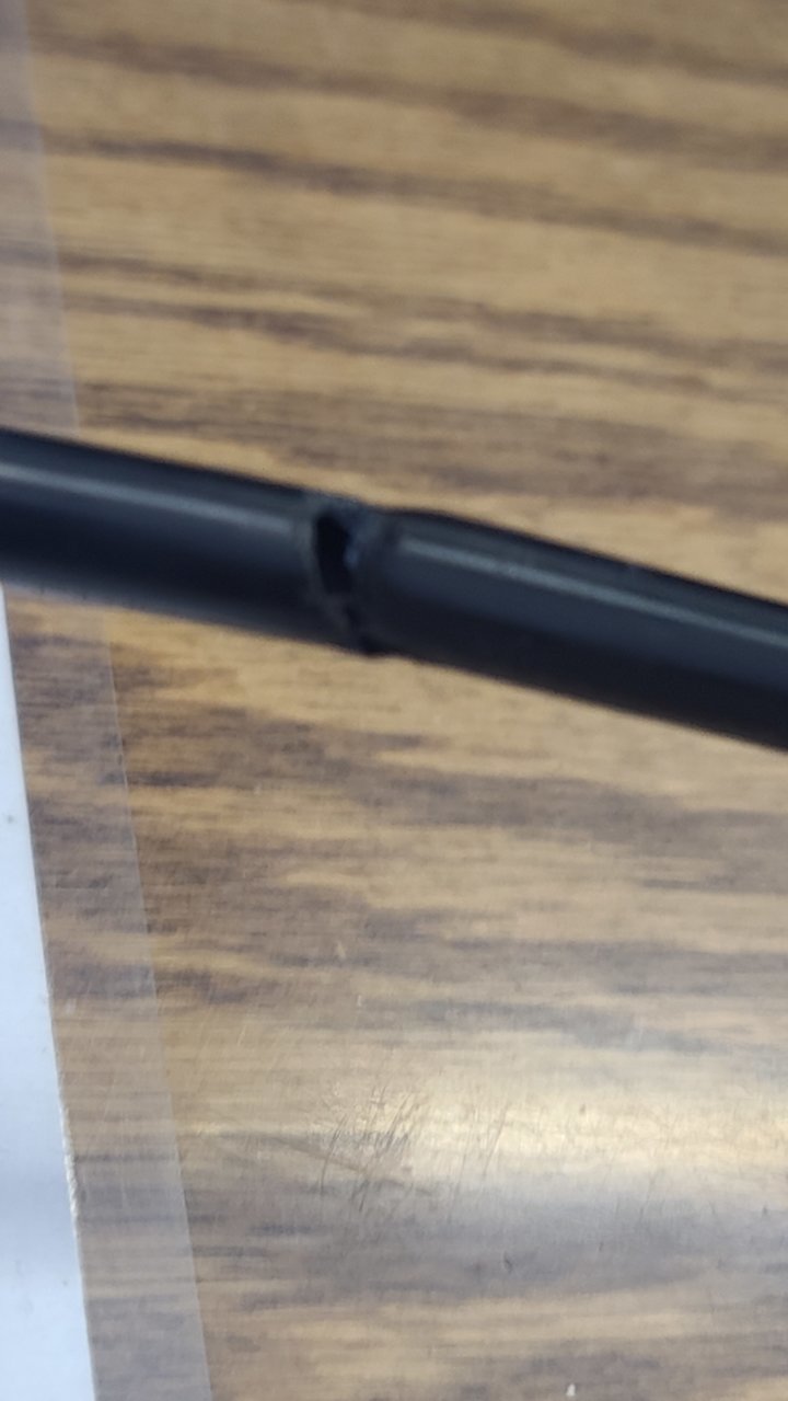

    Does this appear to be rodent chewed or cut?
    Kind of grainy and is hard to tell but I’m leaning towards cut…
  15. Sep 8, 2022 at 8:39 AM
    Shifless Joe
    Shifless Joe New Member
    Nov 28, 2019
    #39259
    76
    Mesa AZ
    2016 TRD Off-Road
    Either cut or fluke road debris damage.
  16. Sep 8, 2022 at 8:48 AM
    e30cabrio
    Oct 20, 2017
    #10410
    6,218
    West Valley, Phoenix, Az.
    Boosted 2013 Sequoia TRD FAUX
    Not rodent. My parents had a '14 Focus hybrid, the battery died at 4x,xxx well inside warranty, Ford tried to claim rodent damage, it took threatening lawsuit to get it fixed. (there was no rodent damage)
