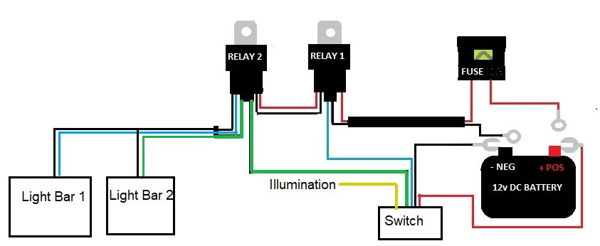

    The website for your switch could use a better diagram, but what you're describing should be possible.
    The red wire included on the switch goes to your battery or wherever you're tapping in for power
    Yellow wire can go to your dash lights or ignition, where the switch will be illuminated when your dash lights are turned on. You can also leave this unwired if you don't want the switch to ever be illuminated
    Black is the ground
    Green will go to the red wire for either the white light bar or the amber light bar
    Blue will go to the red wire for either the white light bar or the amber light bar
    You'll have to figure out for yourself whether the green wire is for white or amber, and vice verse. I'd use a multi-meter and see what color wire gets power when the amber switch is pressed to confirm, rather than the lights. Also confirm which color wire gets power when the white switch is pressed.

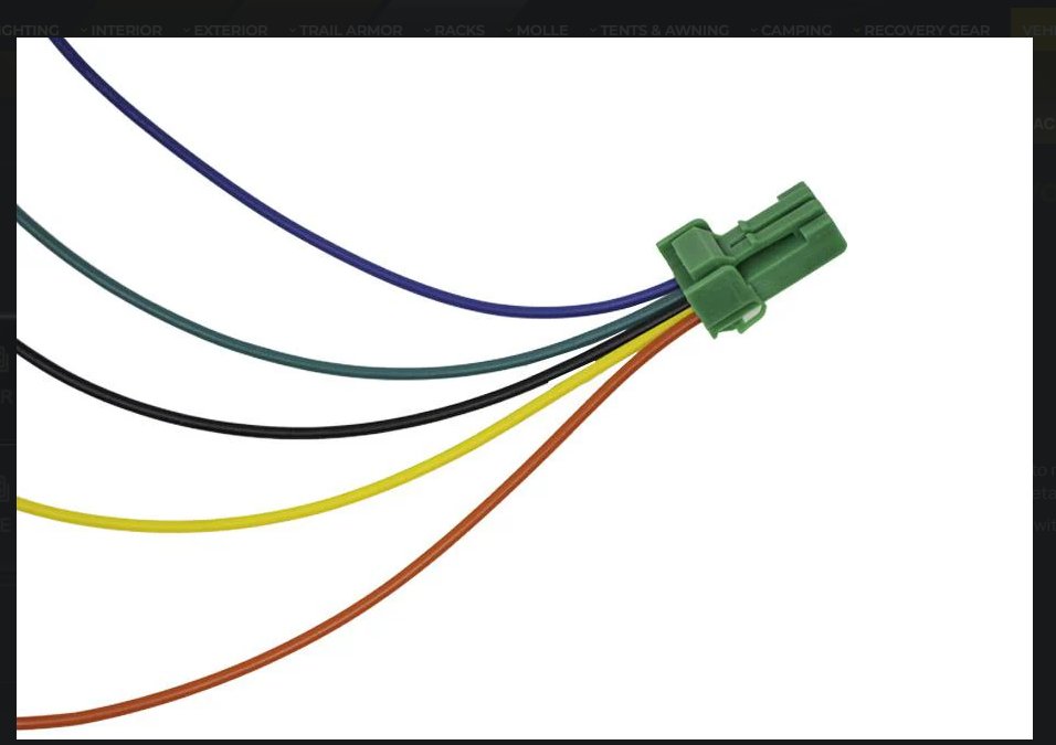

    Anyone had this? Thinking of getting this along with the two harnesses for the lights
    would this work

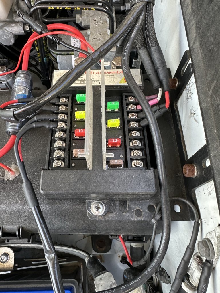

    Auxbeam for a budget option. I have the Auxbeam switch and I wire my ditch, chase, hood light bar, and lower valence light bar all to the Auxbeam.

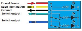

  20. Oct 22, 2024 at 2:05 PM
    des2mtn
    Jul 1, 2020
    #48721
    4,429
    SW
    2004 Black DC Limited 4x4
    Tonto cover

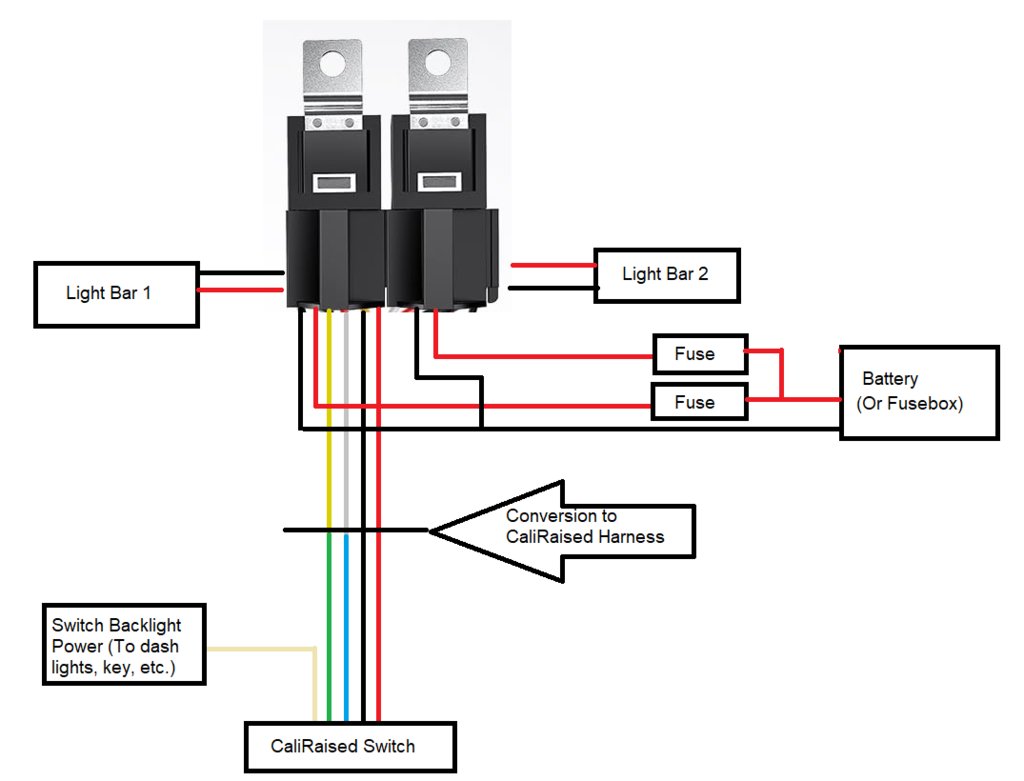

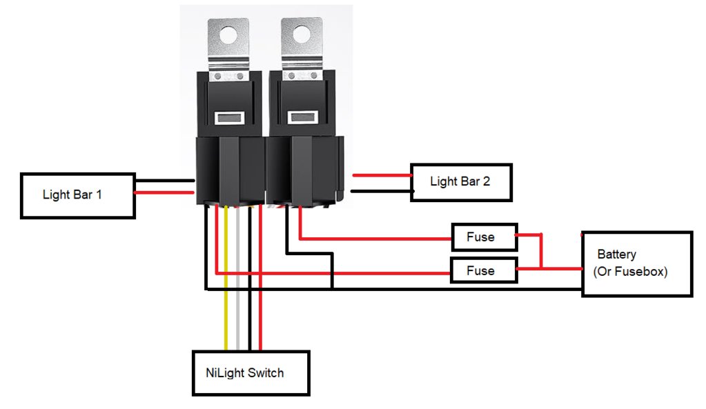

    It depends. Are you buying an Auxbeam or a Switchpro, or going to work out a cheaper switch? If you are going to work out a cheaper switch, you definitely need to add in relays. The harness you linked adds in the relays.
    If you're still wanting to use the Cali-Raised Switch, you can buy the Nilight Harness with the Relays included, and wire it up to the Cali-Raised Switch. I personally don't like to run things off the OEM fuse box or fuse taps, but that's just me.
    Otherwise the NiLight switch goes as follows.
    pyrite12 likes this.

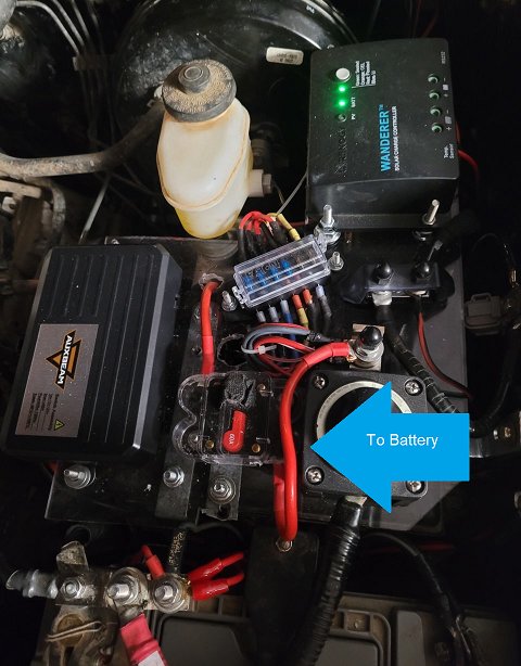

    If you get the Auxbeam, all you’ll do is wire the control box to your battery, run the switch panel into your cab through the firewall grommet, and you can just cut off to desired length of wiring (you’ll only need the posi/neg wires to connect into the control box).
    Here’s a photo for reference

    If you get the Auxbeam, then you just have to run the black and red wires from both the light bars and plug them directly into the Auxbeam. The Auxbeam has relays built into it. If the light bars do not come with enough wiring, I would buy a roll of 16 AWG wire and some butt connectors, then extend the wires from the light bars to the Auxbeam that way (requires a crimping tool and a way to strip the ends of the wires)
    Depending on where you put the brains of the Auxbeam module, you may have to extend the cables that run from your battery to the Auxbeam module as well. You'll definitely need thicker wire here, especially if you plan to use all six of the Auxbeam switches.
    Additionally, if you put the actual Auxbeam switch too far from the brains of the Auxbeam module, you may have to extend the wires to the switch.
