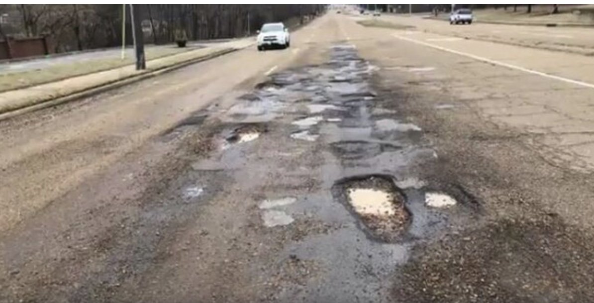

    I threw the picture in just as proof of how bad the roads around here can be. Majority of the time it’s just small bumps, patches and warped roads. But the eibach coilsprings won’t work, the bottoms aren’t flat. These tires are new and not cheap but have about as much sidewall as the stock tires On 18’s id imagine.

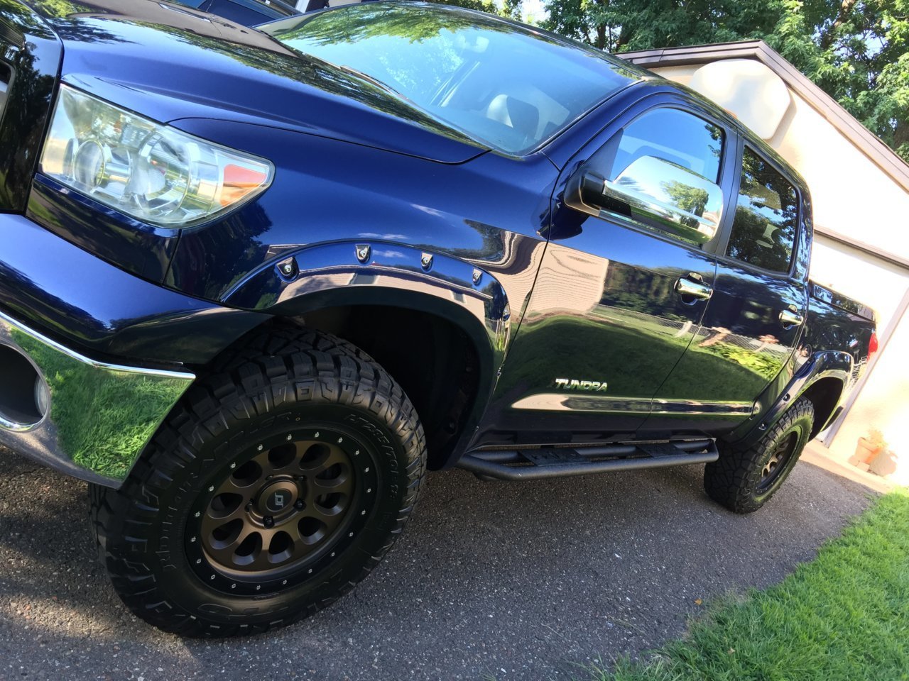

    E7671FF1-D831-4A02-9B00-864709E7F510.jpg I have the Toytech Boss kit in front. Bilstein 5100 in rear with shackles. Ridge Grapplers 285/75/18 , 55 psi. 4x4. A little bumpy at times on bad roads. Way better than the stock set up it came with. IMHO. I feel like I am floating in the lap of luxury most of the time.
    Good luck. D

    @Dabutcher why do you choose to run such high tire pressure? I run E rated 295's and run 34 psi, I couldn't imagine the ride with 55 psi

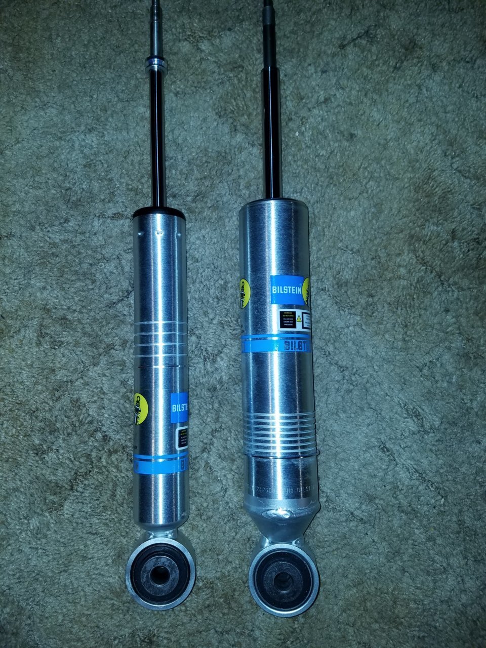

    Although I’ve got a 1st gen, it’s my third and I’ve used many Bilstein products over the years. The 6112/5160 combo is the best setup I’ve had. It truly soaks up the bumps on and off-road.

    BTW here are comparison pics of the Bilstein 5100 vs 6112
