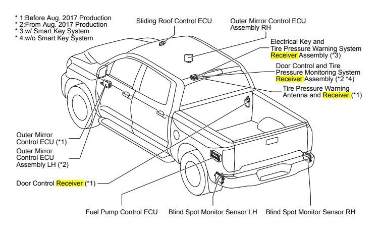

    I've been having an issue with unlocking my truck with my key fob. For about the last 6 months, not only has the range of my key fob diminished, but it's been acting weird as well. Unless I am withing a few feet of my doors when I hit the key fob twice, it will only unlock the driver's door no matter how many times I hit the unlock button.
    I've changed the battery in my key fob twice with no luck and also used the other set of keys with no luck either.
    Does anyone know where the receiver for the key fob is on the truck? That's the only thing I can think of at the moment.
