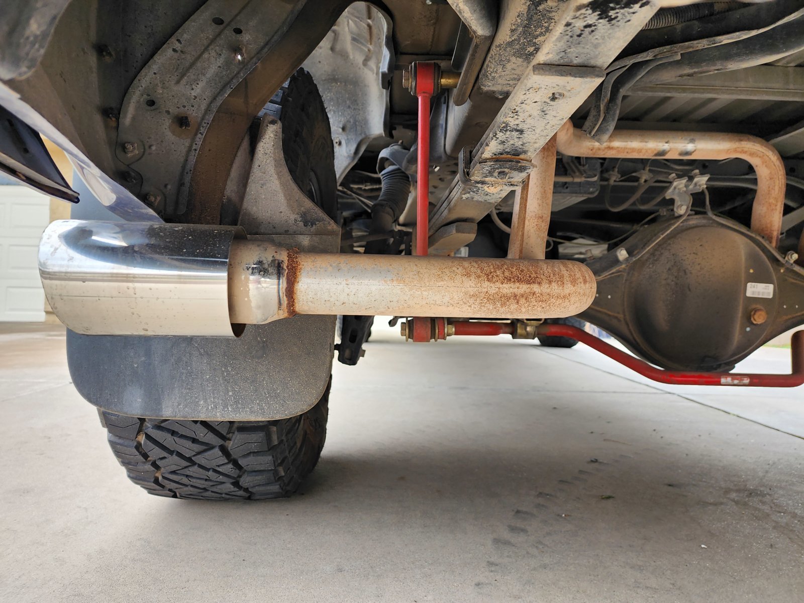

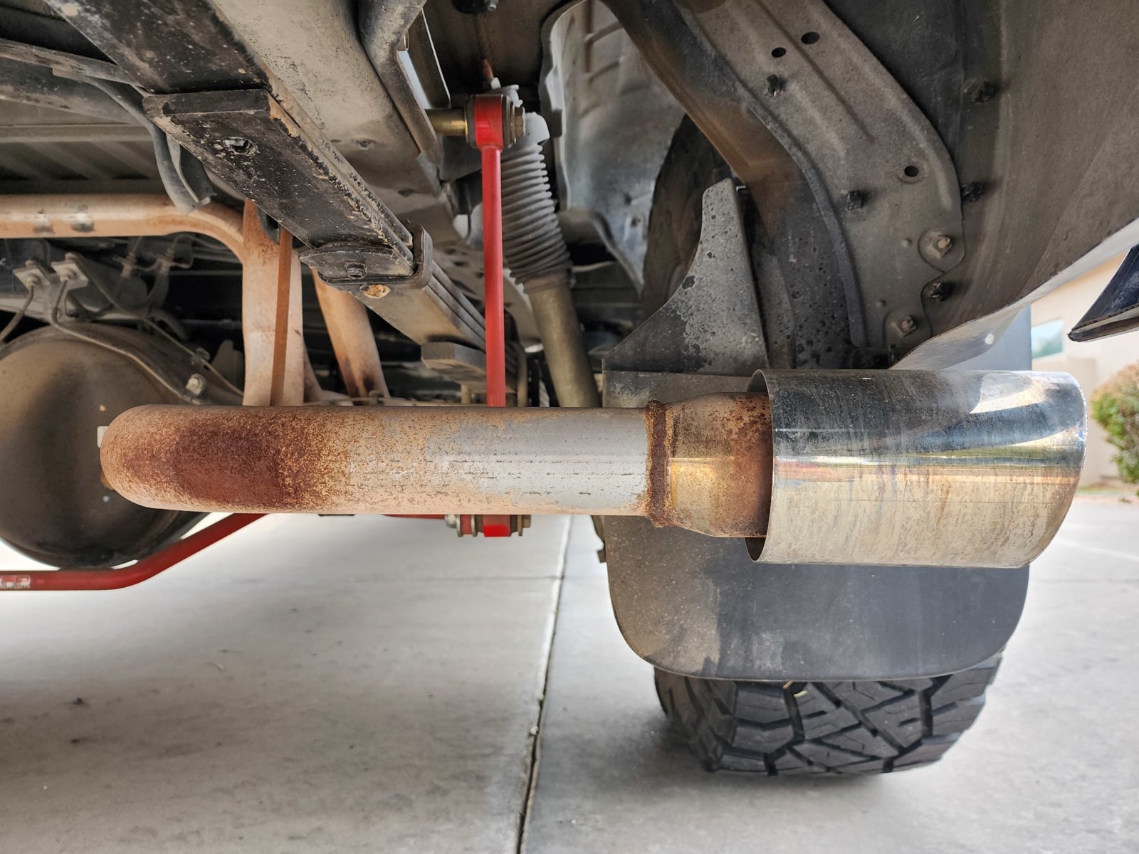

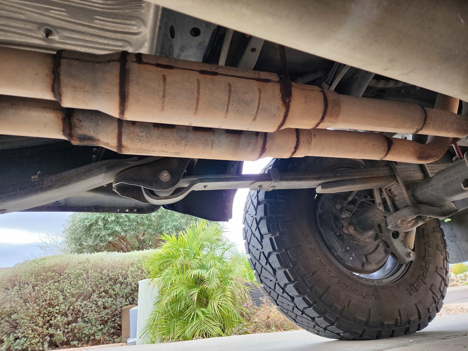

    TL;DR: Bought the truck in October, 2014 w/65k mi. Truck has an exhaust on it but the dealer couldn't tell me anything about it. Id prefer a cleaner install, but it does sound good to me. Paired with SABM, AFE filter and Banks PM.
    I've been unable to find any identifiers on it to cross reference:

    Looks like a pair of bullets with an X-pipe.

    They sound good to me, I'm sure some would say they are too loud. A little crackling when I get on it hard and I've had a few friends tell me they can hear me in the distance on the gas.
    Don't care for the tips and would've done it differently, but will leave it for now.
    No drone issue to speak of.

    Your trucks vvti, tune, heads, exhaust manifolds, etc were designed and engineered by Toyota to work with a single exhaust. Not duals. And more specifically a single 2 3/4” tailpipe.
    Your current system and any other dual exhaust hurts your low end. This causes a sluggish driving truck at highway speeds. It downshifts for the slightest hill. It sucks down more fuel than necessary.
    A proper single exhaust will also have a flow thru style muffler. The stock muffler is the restriction, it’s restrictive on purpose. The tubing is not the restriction. If you install long tube headers then the tubing is a restriction.
