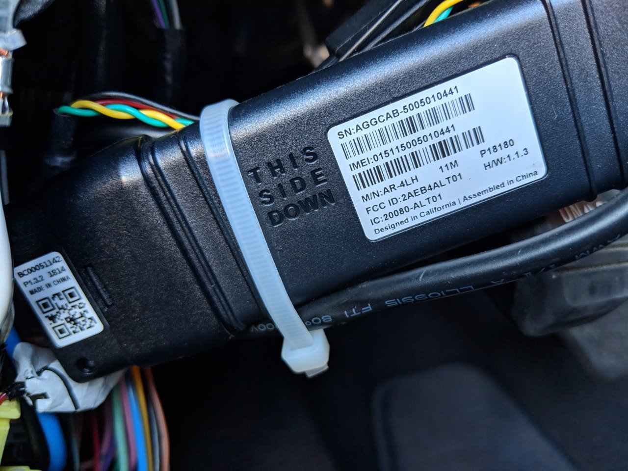

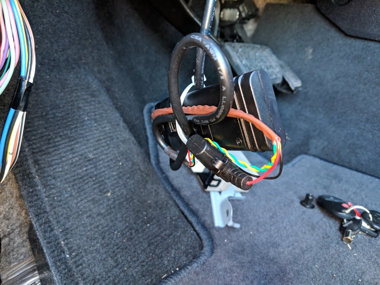

    Hello all. First post and a odd question for you all. I went to install the Non DRL flasher module and when I removed the panel..this device fell down. It looks to be aftermarket. Any thoughts as to what this might be?

    Whatever it is, it transmits. It has an FCC ID, see if you can Google it.

    Did you Google search those numbers on it?

    Well, I guess I might need to follow the wire and see where the other end might leed to.

    I see an imei as well so it’s got a sim in it

    There may be other reasons for it being there. It seems to have been more thought out than usual. Most suspicious spouses just use the ones with the magnets on them, and put them on the outside of the vehicle. It needs to be easy to remove and recharge.
    That said, it’s hard to tell from the picture, but are any of those wires actually part of the device, or is it just zip tied to them? It also looks like there may be a spot for a charger to attach.
    @jlaval , don’t be surprised if you come across a VAR in there also.

    That’s a mycarcontrol module, it works with aftermarket remote starters like the Evo one, it will let you start your vehicle from an app on your phone. What is it connected to ?

    Sure as hell it is. Great eye. After researching, if the OP can't get control of it, someone else can unlock doors and what not with it. Since it is GPS'd, that would come the hell out quickly if it ever sits outside.
    https://mycarcontrols.com/support/
