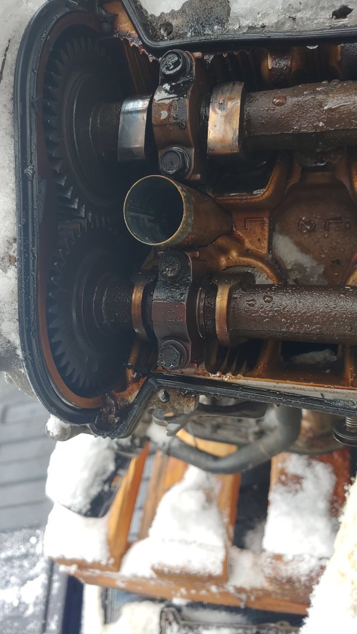

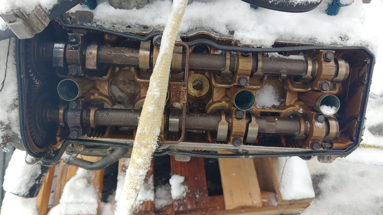

    Fast forward to this year April I was coming back from a trip picking up a old rusted delta table saw from a friend. The truck was sitting at ~130k miles and on the highway I started to hear a whistling noise. I looked around at the cab while driving for any open windows or cracks to which the truck started to jerk. I quickly started to pull over and the truck came to an extreme sudden stop.
    I opened the hood and saw the left cam shaft per the images attached. When I checked the oil dip stick it was completely dry, I tripled checked it. The last oil change was done 2,500 miles ago. I got the truck towed to the nearest mechanic. I came back 3 months later to get some things out of the truck and re-checked the oil dip stick and there was oil at a nominal level. It made me think that maybe the oil pump at the time stopped and oil was moved somewhere and stuck?

    Someone didnt check the oil and a bearing siezed. Happens all the time.

    Yup. The whistle you heard was the bearing siezing. The fact there was no oil when you checked it immediately and a little bit when you checked it later tells me it was low to begin with. Oil pump could have seized but that wouldn't cause there to be no oil on the dipstick.

    Well that’s a bummer. But you are right - the stars must have aligned for you to get that motor installed for $3500.
    A spun bearing is usually caused by one of two things - lack of proper lubrication or excess heat. Usually the latter is caused by the former, but sometimes simply overheating the motor can cause it - the reason being it messes up the tolerances and the proper film of oil can’t be maintained (so really, it’s just improper lubrication).
    As for a lack of lubrication, this can be due to several factors: wrong oil weight, old or dirty oil, letting a vehicle sit for long periods of time, overly extended OCI’s, fuel leaks washing the cylinders or diluting the oil, a bad or clogged oil pump, sludge, etc. I’m not going to necessarily point at the marvel mystery oil, but it thins out the oil introduces excess solvent in to the system; could dilute it to the point that it didn’t provide proper lubrication at some point or dislodge some gunk in the motor that eventually found it’s way in to an oil passage or galley and starved the bearing. Sometimes that damaged bearing can limp along for months or even years before catastrophically self destructing. Had a friend with a 90’s Chevy with a diagnosed bad bearing that we drive for years afterwards. It was used kind of as a gentleman’s farm truck and we continued to bucked hay and fixed fences with it.
    I’ve also not a fan of yearly oil changes even with low miles, but we get four seasons which can be tough on oil. I‘ve also decided that the 10k OCI for the 5.7 with 0w20 (I know, not the same motor or platform as yours) is only good for a very particular use case - and that’s not my use case despite what Toyota may claim (though, if you read carefully, they don’t recommend that OCI for all 5.7 vehicles depending on usage).
    Anyways, sorry for your trouble. I would guess that either the yearly OCI with over 5k miles, occasional use with longer periods of sitting, and perhaps the MMO treatment culminated to lead to its untimely demise. Or the oil pump decided to fail. With an empty dipstick, the oil was either very low or oil passages were clogged in the block, causing the pump to run dry, and the bearing to starve and die an ignominious death.
