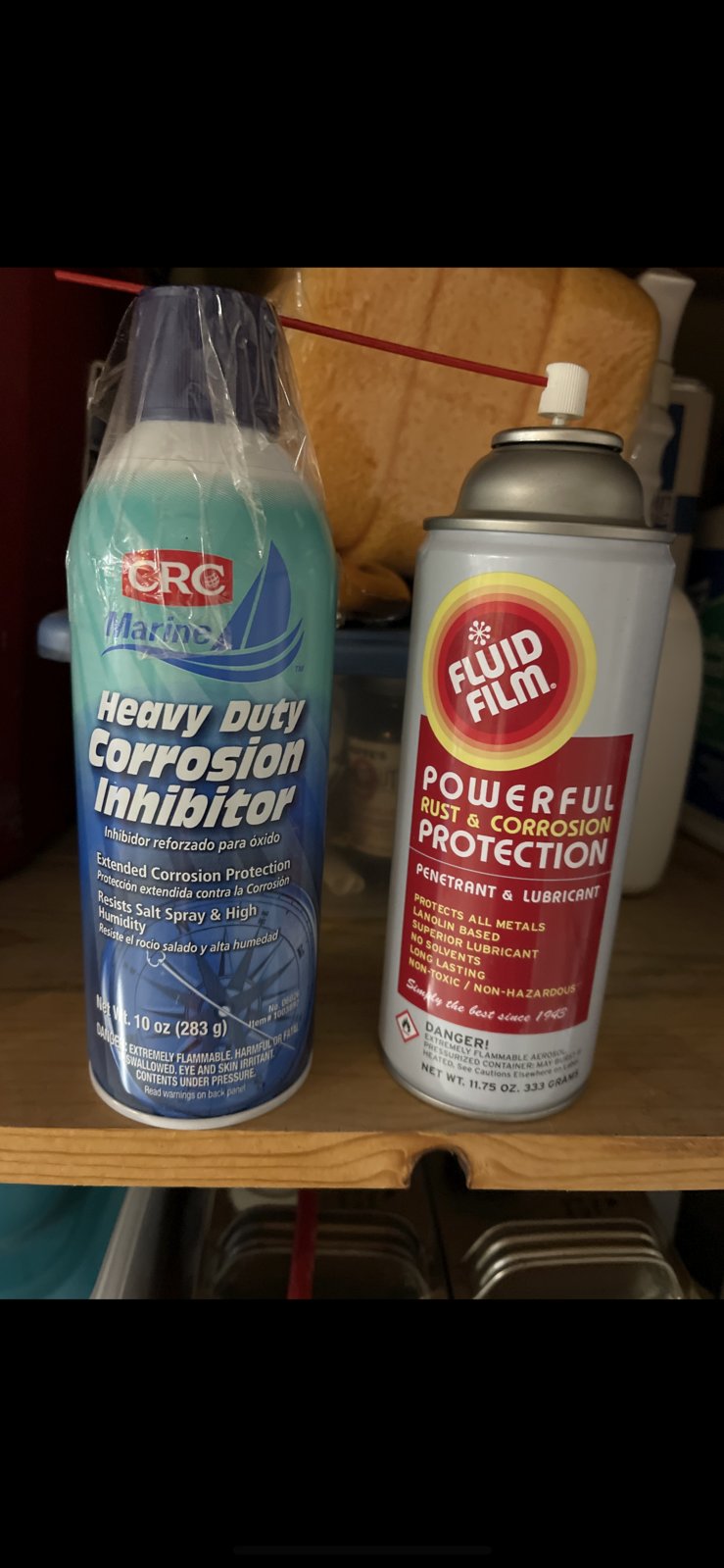

    Check out CRC Marine coating. I use fluid film in some areas, but the CRC is better for exposed areas. It’s similar to cosmoline. Dries to form a tougher barrier than fluid film that will not wash off easily. I use it on my camper as well.
