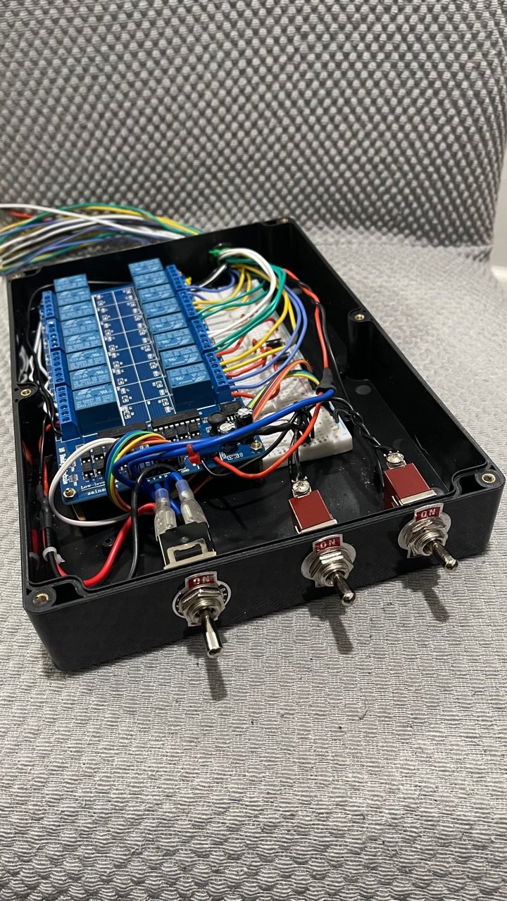

    Correct, the tunes do not do anything when you drop into 4Lo. I tried messing with all sorts of parameters with my HPTuner.
    The only way I got around it was to make a device that tricked the 4WD ECU into thinking it was still in 2wd and then modifying the Tow/Haul button with a considerably more open throttle. Tow button is programmable but only works in 2wd.
    Toyota put the limiter there so you don’t end up breaking shit. First thing to snap will be the CV axles and if you get lucky you’ll snap the stub shaft inside the front diff. At the end of the day the only real way to resolve this is with a lower geared aftermarket transfer case, which is the route I’m taking, which will crawl up with little help from the skinny pedal.
