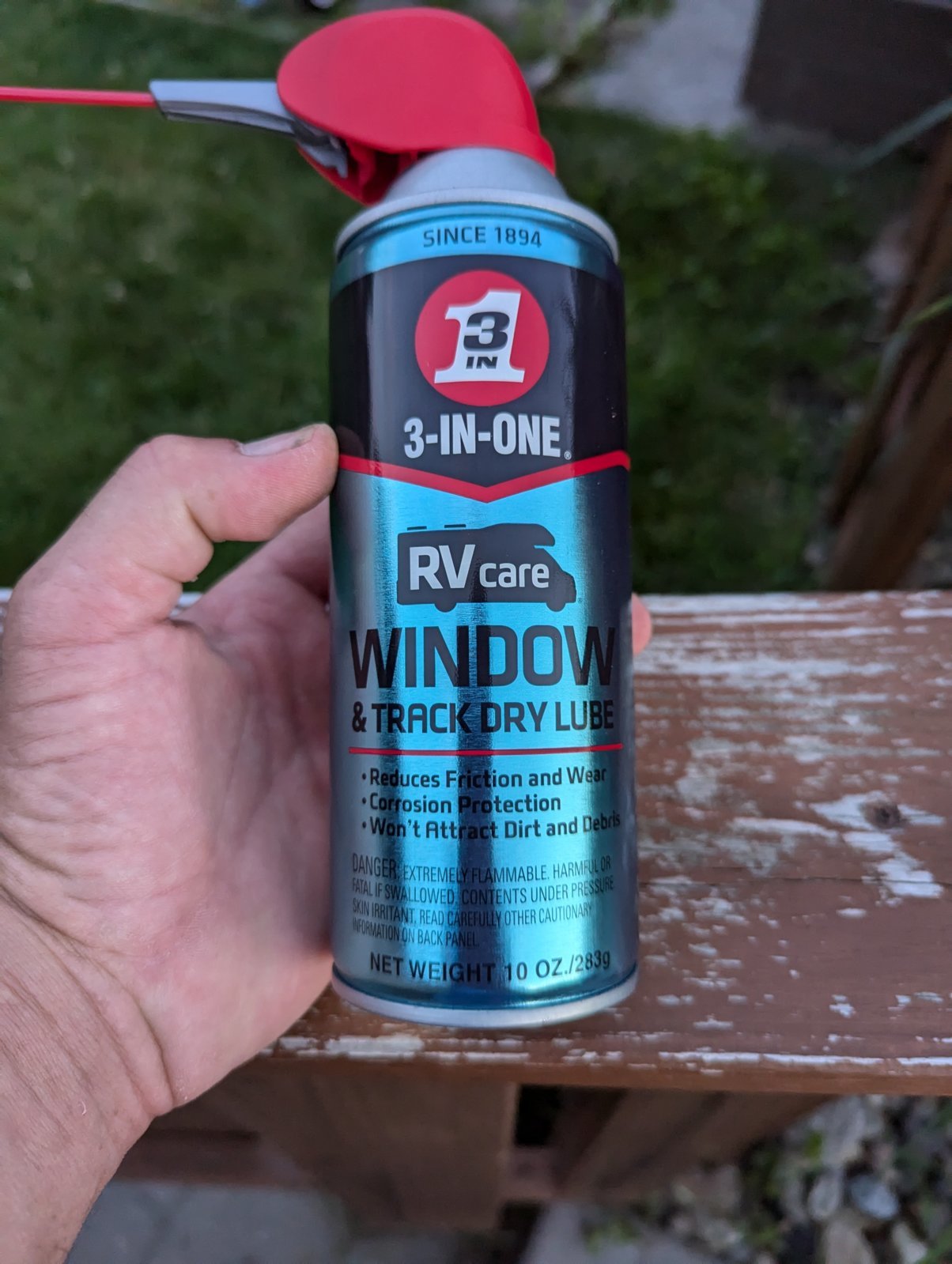

    After what feels like a fucking eternity this is actually solved. Unfortunately I don't know exactly what did the magic trick but I did order a brand new window run from Toyota and installed it today. After putting the glass back in the window when the new window run was in and testing the window, it's still seemed as slow as as it was with all of the other things that I've tried. What I did notice when looking to see what the hell could be the problem. When I had put the glass back in it was not in between the two pieces of rubber by the door hinge side. It was in between the metal guide and the rubber. When I remove the window again and put it in between the rubber it now is the same speed as the passenger window. I do not believe that as many times as I've had this window in and out trying to fix this that it was like that the entire time , every time but I could be wrong. If you have slow windows and anybody has ever been in there or you have, check to make sure window is in between /sandwich by the rubber and not between the rubber and the actual window guide, this could very well be your cause for slow windows. Don't open the parts Cannon like I did LOL.
