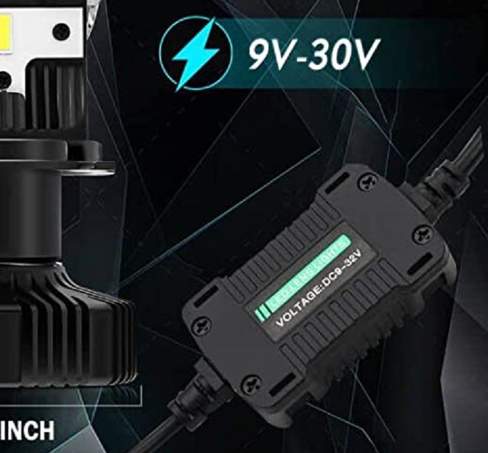

    So, the projectors I got already have a mini-box attached. That doesn't quite do it huh?..lol
    Linky... https://www.amazon.com/Upgraded-Hea...4&sprefix=co+li,aps,73&sr=8-20&language=en_US

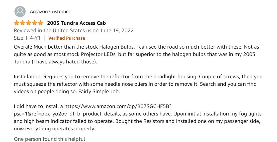

    Literally one of the reviews for this product.....
    AWilliams[OP] and shifty` like this.

    Don't confuse the LED driver (pictured) with a resistor. They're not the same thing, I don't recall any cheapo LED headlights ever coming with a resistor integrated into the driver. That'd be a cool add-on, but could cause probs with other stuff. Meanwhile, note the questions section on scAmazon where someone is asking about an '04 Tundra, and someone complains high beams don't work or cast right, here's a video, but it looks like it's a Passat they're demonstrating it on.

    Thanks Shifty....you've been a real help with all my questions. I assumed that box was a resistor...not a driver. I'm not very up to date on lighting requirements.
