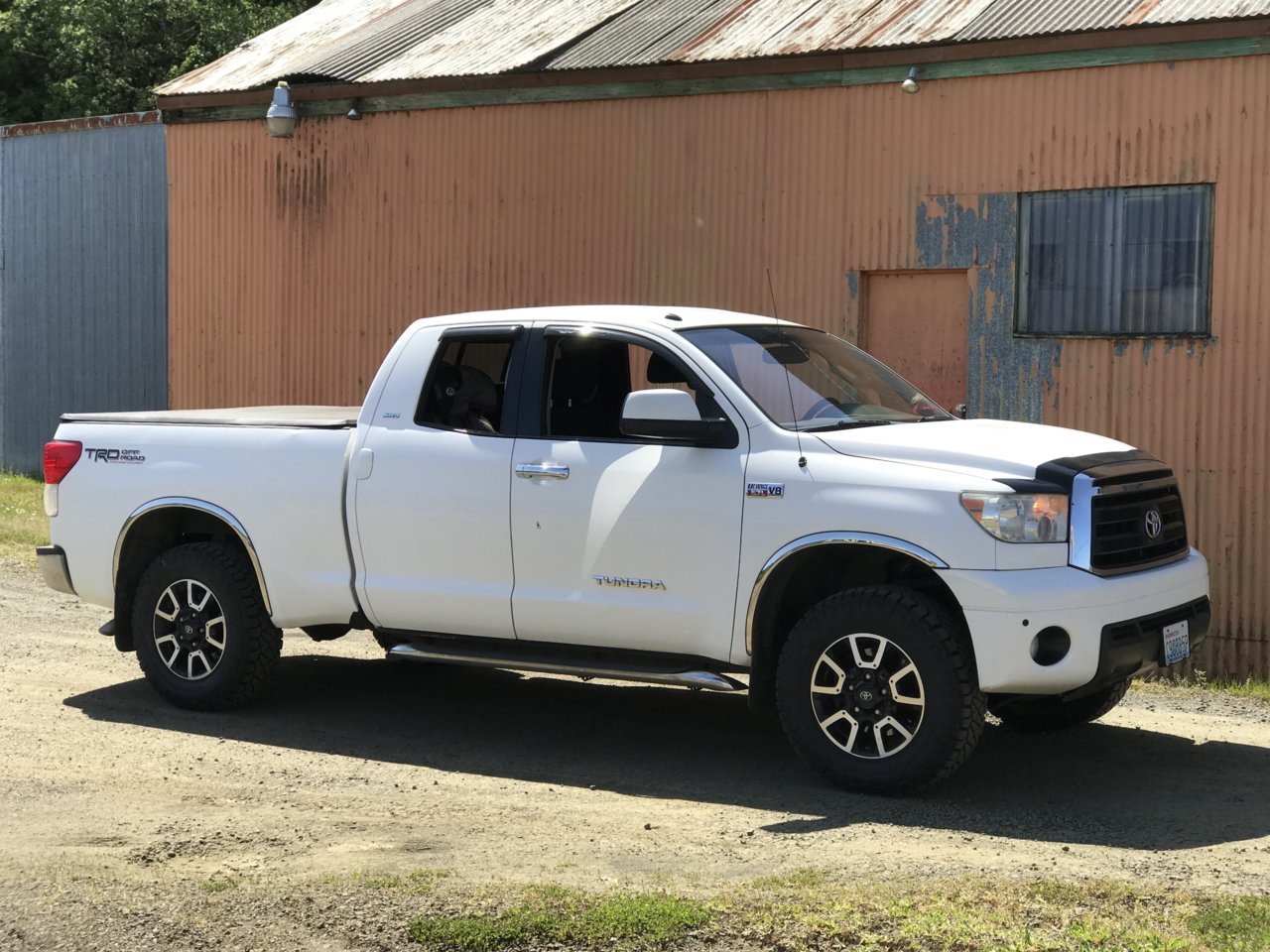

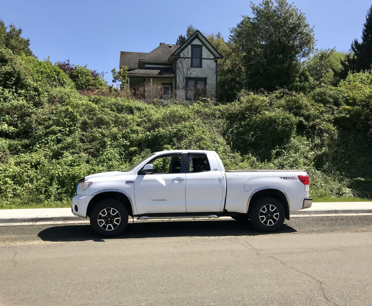

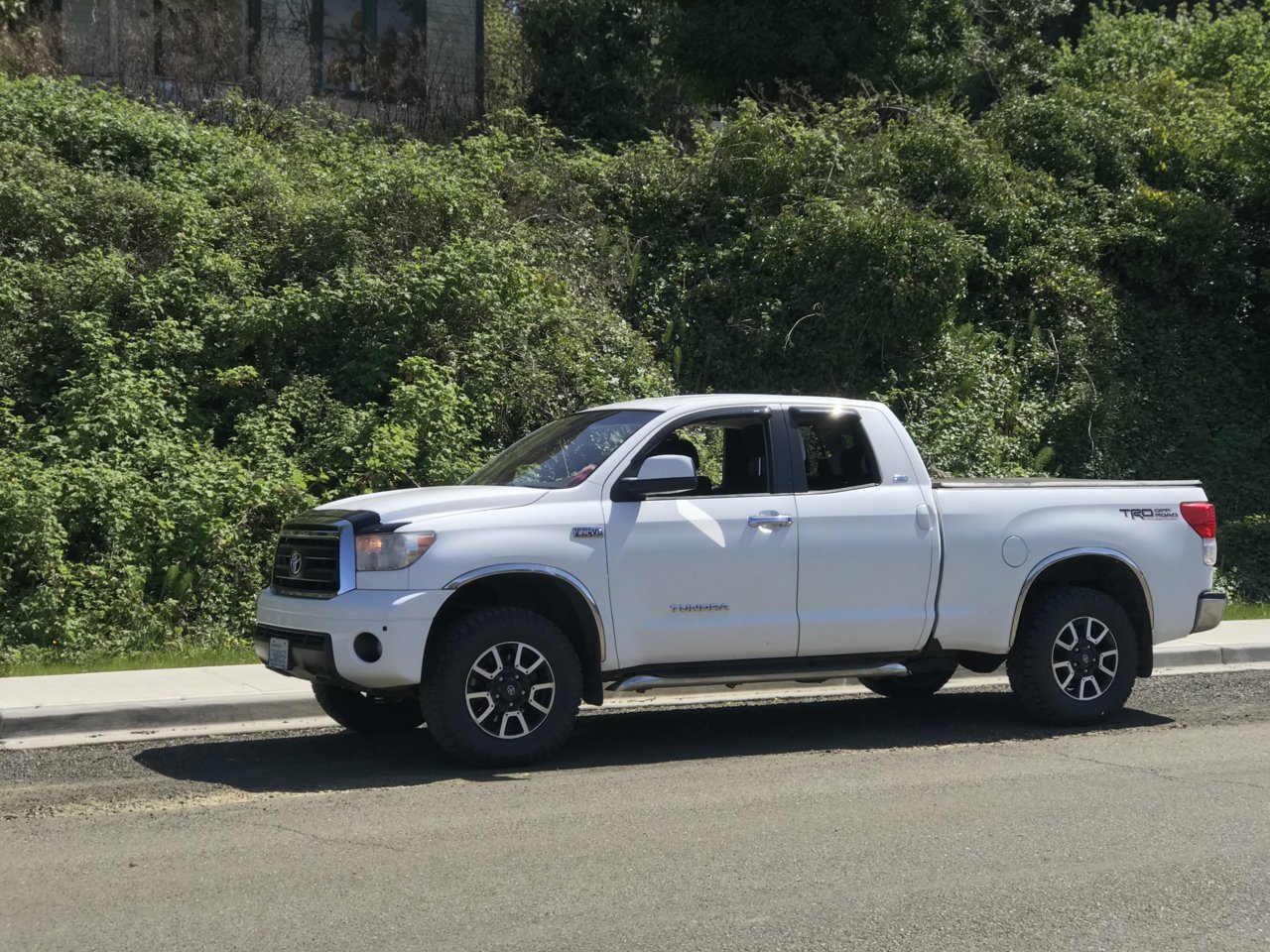

    I just got it back from the shop and I feel like its too high in the front. I went with 5100s on middle setting with 2 coach builder shims on each side with a new set of Ridge Grapplers 275-70-r18. Does it look level to you guys? Maybe i'm just crazy?

    From the pics, it looks level to me.

    Looks fine to me.

    Personally would want more rake. But it is close to level. You’ll probably be the only one to notice. In 3 months you probably won’t notice as much anymore. Also front coils can settle a little.

    well it looks good to me .. I see above that you spent all you had .. but if you’re truly unhappy down the road can always upgrade rear shackles, which will get some better handling out of it, and get the rear a little higher again if it’s still bothering you

    It’s a tad taller in the front. Not obnoxiously so, but it is. When you do the rear shackles you’ll be much happier. Looks good to me though (except those chrome fender things!)

    Your running boards look level, but the body lines say otherwise (lower in the rear). If you see it now, you will ALWAYS see it. Shackles are relatively inexpensive go for CB +2 if total front lift is <2.5". Go CB+3 if total front lift is >2.5"
    Simply put: Your truck has more front wheelwell space than the rear and it's swaying you to see if it as higher in the front, regardless of whether the running boards are level

    From the side pics, it looks pretty level. But with the big hood these things have, it can look like the front is too high from inside. That being said, I like a bit of rake myself.

    looks level to me, looks good!

    Looks level to me also. Put a bubble level on the bed rail and see what it says. I would be curious to see a pic of that. Of coarse you need to be on level ground also.

    Looks pretty close to level to me. What are the measurements?

    Maybe pull the shims and you’ll like the slight rake

    its level. however, all the "accents" you have done, throw the eyes off
