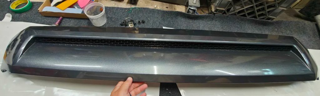

    so I laid down some mgm chrome begone :) (AKA Orcal 937 Vinyl ) damn near paint match, tomorrow ill finish the lower grill part

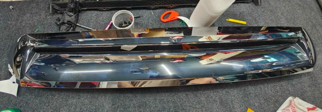

    Pre
    Post

    its dark here now, so will snap one in the morning. but its a damn near perfect match
    I do have to probably re-do it since im so anal about things, but I did an inlay for the vertical sides, but then in my haste last night (it was past 1am est) I forgot to lay down knifeless tape to cut out where i did the inlays & just heated & stretched the main piece into those corners but there was so much tension that it lifted a little bit.. I then attempted to cut out that area to leave the inlay, but I went a bit too deep w/ my knife & cut through the inlay exposing the chrome a tinnnny bit

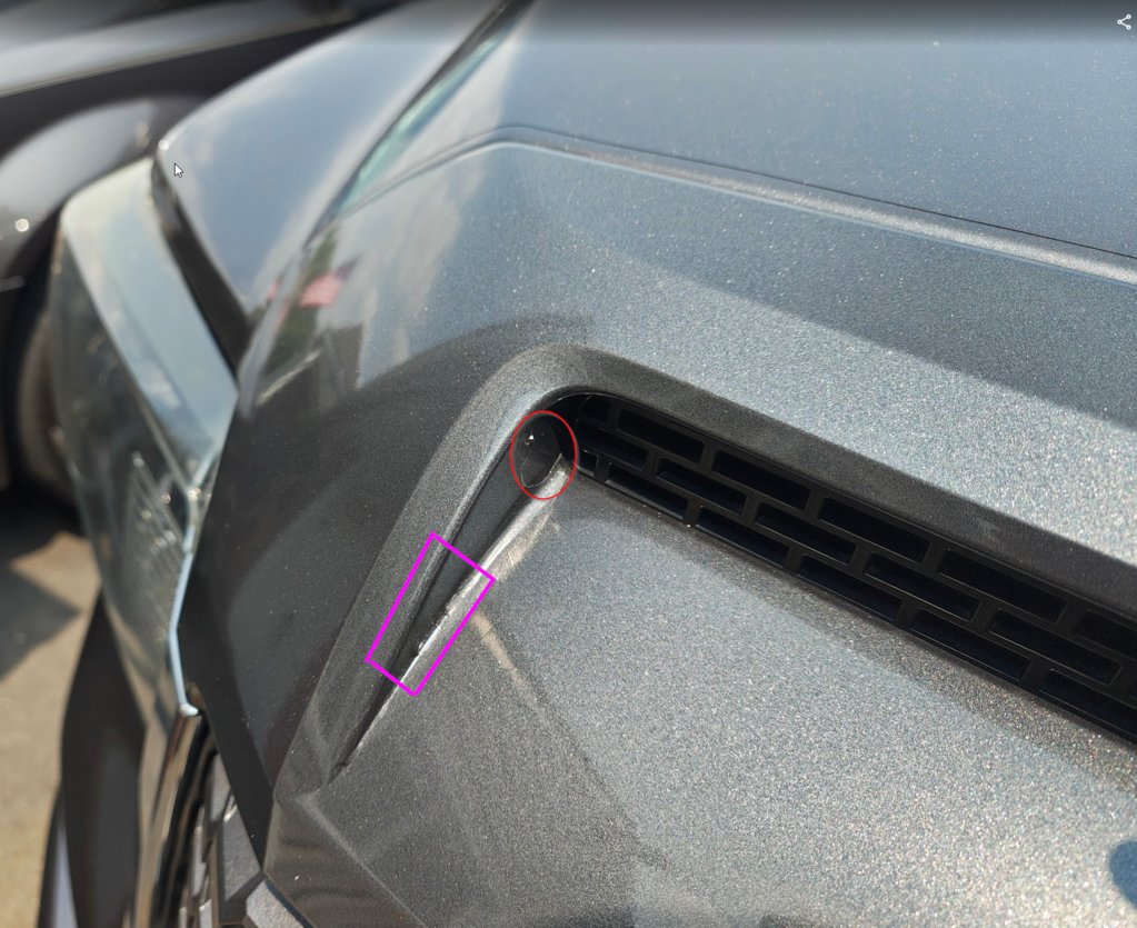

    and here is my mess up (the red shows the inlay I did behind the circle chunk missing) & then the pink square shows where I cut the bridging in the vinyl but went a bit deeper & cut through the inlay (its behind the main piece) down to the chrome

    No one else will know and that looks soo much better than chrome I wouldn't even stress. Good job!

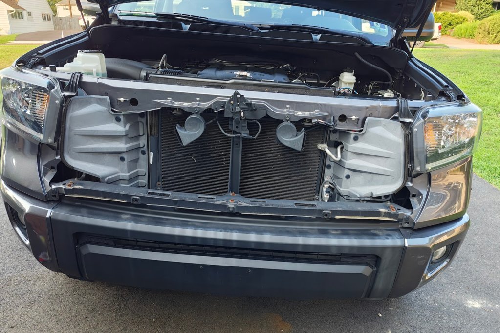

    lower grill time
    also in case anyone else goes down this route, just keep in my there are ALOT of sharp edges both on the grill & the hood buldge from the molding process/excess flashing. With the chrome , this makes it a PITA to try to sand flat/smooth w/ just sandpaper (since chrome is basically metal, but just a thin layer)
    I used my Dremel to get them all smooth /flat, then used some 220 to smooth further.
    I should have the final pic up shortly ... grill is hanging/drying after a thorough wash w/ some dawn dish soap
