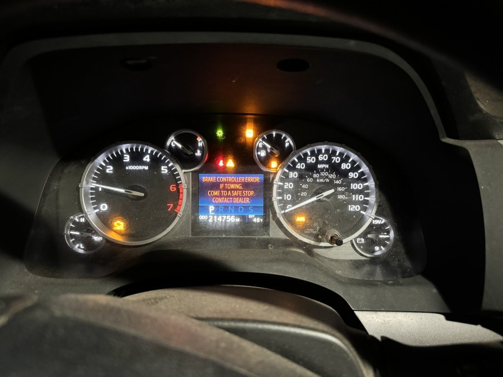

    Morning all, I drove my Tundra for the first time in about a week this morning. Backing out of the driveway, all gauges went to zero momentarily, I got a Christmas tree of warning lights, CEL, ABS, TRAC, warning, and the center display showed "Brake controller error. If Towing, come to a safe stop."
    I scanned the truck with my Scanguage III and got a U0155 Lost communication with instrument panel cluster (IPC) control module. The only other code was some generic that didn't have a number about all monitors completed, IE the emissions monitors like misfire and EVAP. I cleared the code, and on my 22 mile drive to work I had no other issues, no repeats of the cluster. I even stopped for fuel.
    I haven't had anything like this happen prior, just curious if anyone else has experienced it? I do have a hypertech speedo calibrator installed, and when I went to reset it for my new tire size a few months ago it failed to update, so I am suspecting it may be an issue. I plan on removing it tonight after work, and I was going to replace it since it didn't update, so this might be the boot to the ass to do it. The truck does have a fair few of modifications to it but the speedo calibrator is the only one that I can see that may be related.

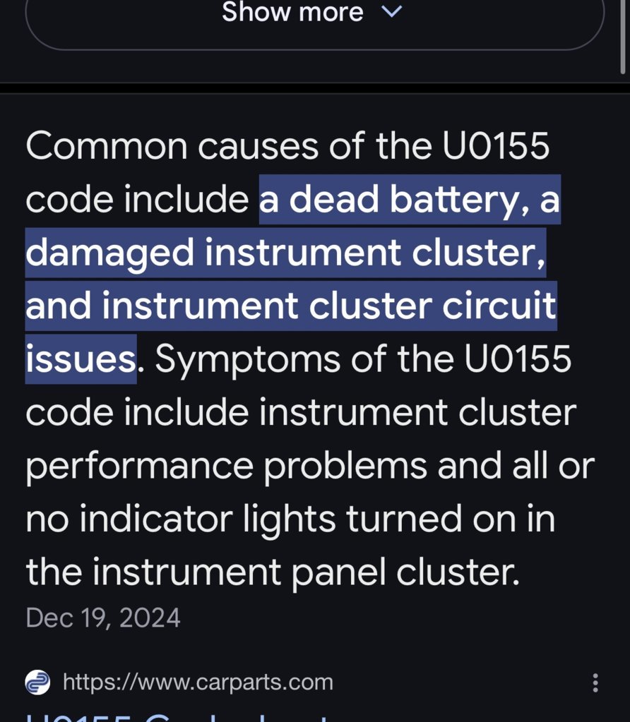

    Ai is never wrong.
