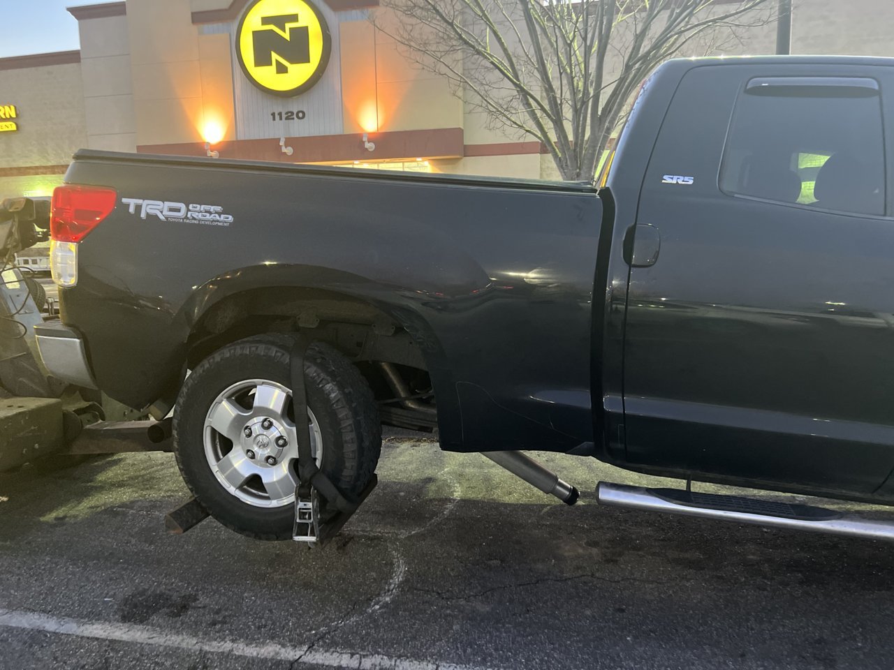

    97ABF725-33FD-440A-93F4-BAEB345A8173.jpg This is the results of ubolt being reused. One of them snapped off. I bought the truck with what looked like ubolt that came from a big lift kit. Drive shaft snapped after parking it.

    I had no load luckily when it happened. Took off from a traffic light and heard a big clunk in the bed. Pulled over and saw a snapped ubolt. Went into a parking lot and brushed the curb pulling into a parking spot. Rear axle shifted and the bed dropped from my spacer block falling off. $2500 later it is fixed.
