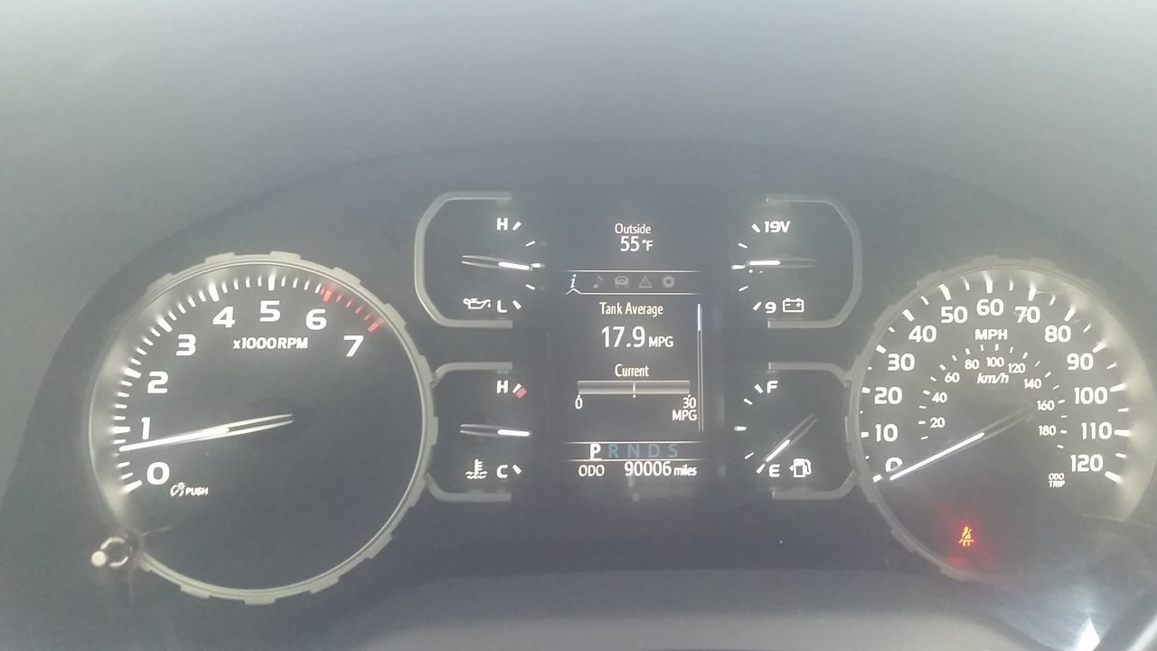

    My truck rolled over to 90K this week. Everything is stock except the suspension and tires. I drained and filled the transmission for the third time last weekend. I changed the oil, cleaned the mass air flow sensor, and throttle body this weekend. When I hit 100K I think I'll change the spark plugs and brakes. The next time I need tires I'll probably go up a size from 275/70r18 to 285/75r18. Everything is good with the tundra. Typical toyota, not much to report.

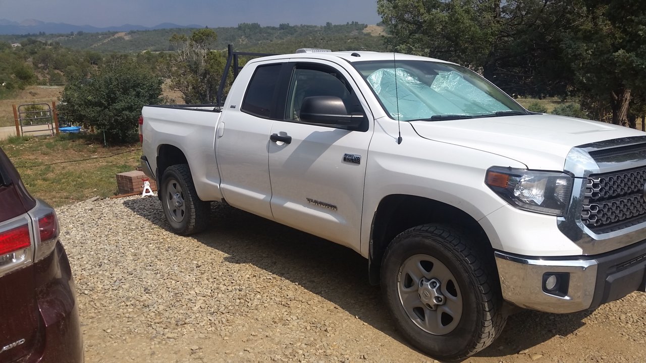

    Good to here with all the negativity lately. Lets see a picture of the truck as she sits!

    dude, how the hell are you getting such high mpg? o_O
    BlackSheep and YardBird like this.

    going to assume it was reset with the battery being disconnected

    That’s about what I get

    Me too....my 2015 sits at 14.8 - 15.0

    Wasnt much worried about my MPG at all....just saw there was a a bog difference between mine and his.....wondering what i could do

    Fastest color, best mpg.... I drive a lot of highway miles. Normally on a tank of gas I get about 17 mpg. About once a week I go over wolf creek. For some reason my truck really likes that drive and I usually get 18 or 19 mpg. I've never been too concerned with fuel milage. A lot of guys I work with drive half tons from other manufacturers . They will get slightly better fuel economy then I do but they also usually start having problems when they start getting close to 100K and dump them. I can buy a lot of gas for the price of a new truck. My last tundra was a 2003. I had my first problem with it just shy of 200k miles when the starter relay went out. Fixing it consisted of opening the hood, opening the fuse box, pulling out the old relay, plugging in the new relay, and closing it up. I traded that truck for an fj when it had about 240k miles on it. The starter relay was the only problem I ever had.

    So, what's the secret to this mpg I keep hearing about?

    Only thing I see is fuel level needs adjustment with moar gas!
    also...where the heck are you with 55F temps in August?

    Southwest colorado in the mornings it's usually high 50's or low 60s
