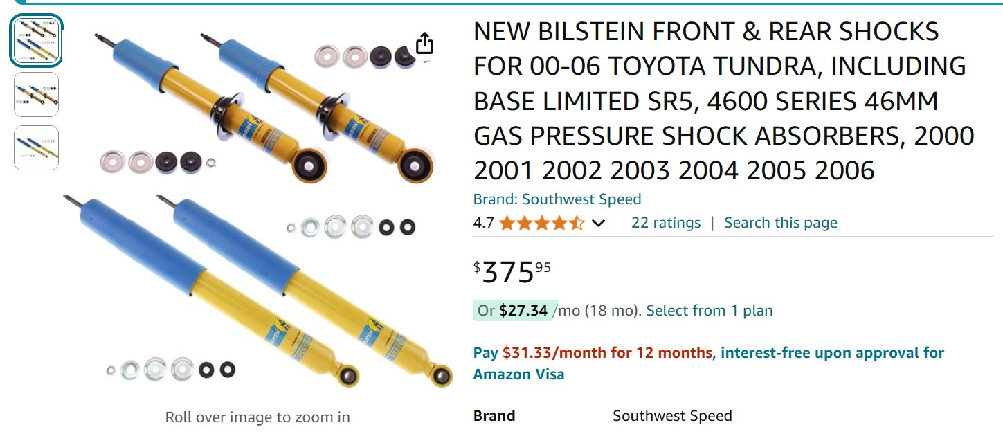

    For our year trucks, the Bilsteins come with everything you need. My rears came with rubber bushings, washers, nuts. Everything needed.
    Fronts also came with everything I needed, assuming I didn't want to replace the upper mount. Which, while many people will tell you is a good idea to replace (and they're right), it's not critical. Not like the hardware on the rear shocks. That front upper mount is just one of those "might as well replace it while you're there" sort of things. Not 100% necessary. Unless you find that it's trashed.
    I didn't even realize you could get the rubber and metal as separate pieces, so I have no advice on that. I guess if your metal is good and it's a lot cheaper to get just the rubber, that's as good a reason as any...
    I took a chance buying from scAmazon, and we all know you can't trust the photo to tell you exactly what will come in the package, but in this case the photo was accurate. My shocks came with all the pictured hardware. I remember reading threads from later gen installs and it seems correct that for later gens, the shocks don't come with everything you need.

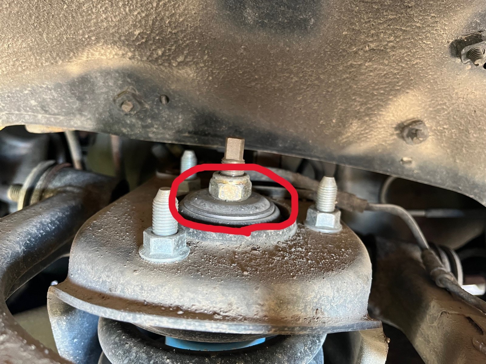

    Sooooooooooooo, here's one more question... some of the pics of the shock mounts show center rubber on the bottom side. Is that actually one of the two bushing pieces included with the shock? It makes sense that it would be, since some of the mounts don't appear to come with the lower center rubber piece.
    I just crosschecked part numbers and the $19 isolators at NAPA are actually the Monroe Strut-Mate units Rock sells for five bucks.

    Pictures? Center rubber? Bottom side? I know you know exactly what you're talking about, but I can't picture which part. Front or rear? And I assume we're talking the top of the shock, not the bottom.
    My Bilstein 4600s came with everything, everything I needed except the front shock top "hats"/mounts, whatever. I reused zero washers, bushings, or nuts on the top end of either front or rear shock. Only thing I reused was the bottom shock bolt and nut.
    Don't trust product photos. Maybe trust descriptions, but even then be suspect. The rear shocks go something like: metal washer, rubber spacer, metal washer, nylock nut. The scAmazon photo shows a lock washer between the large top washer and nut, but I can't remember if that's actually necessary/included or not.

    I'm talking about the spring side (the bottom) of the front upper shock mount.
