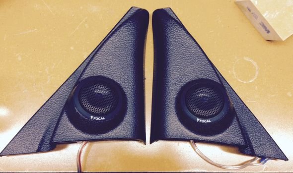

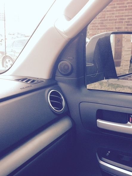

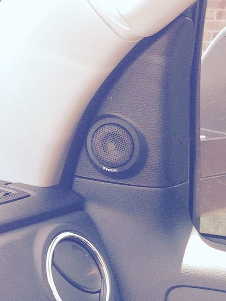

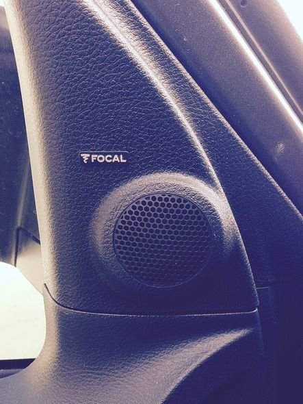

    I bought JBL door sails for my non-JBL audio upgrade.
    67491-0C060 - Door Mirror Trim Ring (Right, Front, Lower) - 2014-2021 Toyota Tundra | OEM Genuine Toyota Parts (oemgenuineparts.com)
    67492-0C060 - Garnish, Front Door Lower Frame Bracket, Left - OEM Genuine Toyota Parts (oemgenuineparts.com)
    I tried to mount my Focal tweeters behind them, but they wouldn't match up and center under it.
    I ended up cutting the grille out and modding them in.
    4722186B-4A98-402F-9187-27B837DBCA56_zps_64e1c69fc04fe00d8bb6032bbdd2464dc7a82c2e.jpg 227B70AE-6728-4330-BBFB-1FCE1A74A9A7_zps_513f6bcf9a1c7f214d22c23c31f3bf29e39b1ecb.jpg
    Don't ever notice they are there anymore..
    B5767B44-33BF-42E9-ACEC-7ED59E995713_zps_9a7cc9d6571b9e5c713a961936f0ad41b12b686e.jpg
    689D6A5A-12D7-46ED-8E04-46779903642B_zps_ec06daeec9143225b884120e612be11b9a378271.jpg
    If you wanted the tweeters totally stealth, mount them in the side dash.
    I ended up disconnecting all 3 OEM dash speakers when I installed the Focal 2-way door components.
    Although I'm running an aftermarket HU and 5-channel amp.
    The dash speakers running off the HU mucked up the sound stage....

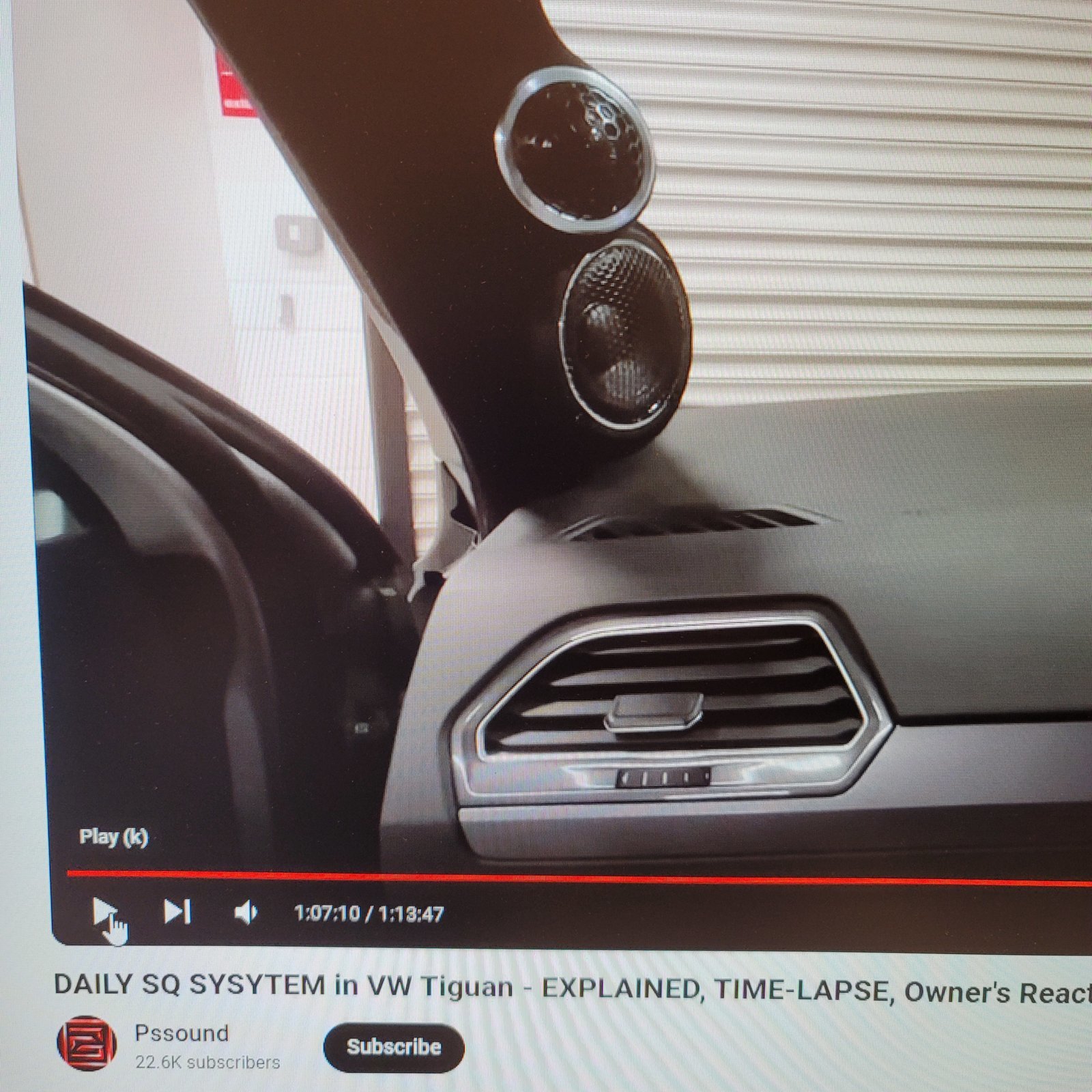

    Some of the best sound quality car stereo I have seen is from PSSound on youtube. He has alot of videos on installation and tuning in a car.
    In most cases the tweeter needs to be in some type of pod setup somewhat on axis.
    Same with the midrange.
    On my tundra I am using the factory locations.
    With a dsp and rta tuning you can get the factory locations to sound good. But I know If I changed speaker locations I could get more out of the system. Just depends on how far you want to go and how much factory look we want to keep.
    Almost every sound quality car stereo system has some type of setup like this on the dash upfront.17146723279371483979359713232167.jpg

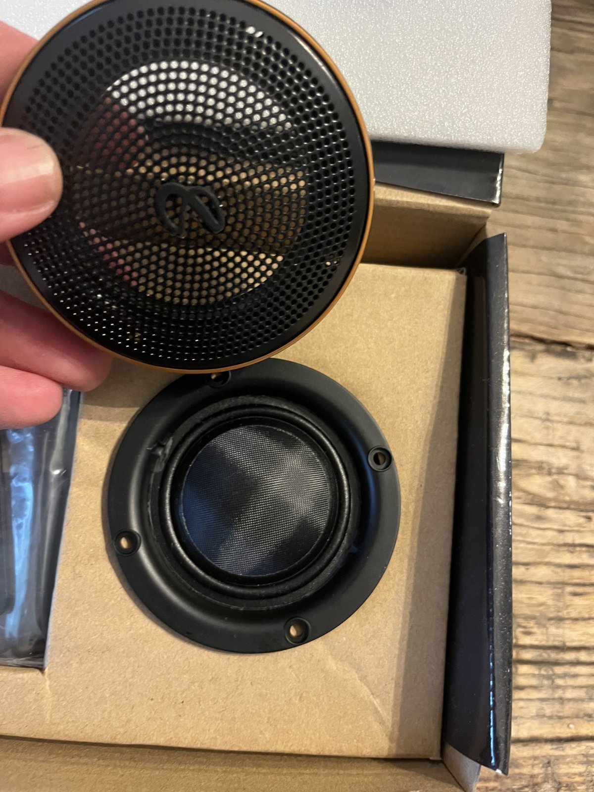

    So these showed up today. I guess Alexa ordered them as I have been talking about them. Lol
    Fit perfectly in stock cradle.
    oddly enough the face plate and grill come off on these.
