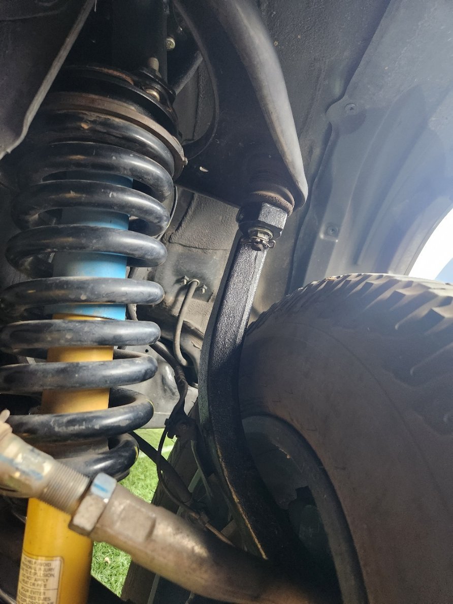

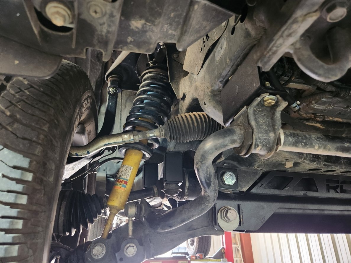

    Here are some photos of the lift- around the front driver side wheel.

    This was super helpful Frank. I can see where the stops are hitting. There is extra steel there so I may be able to grind some off and get some turning radius back.
    Thanks! Will report back when I get to it.

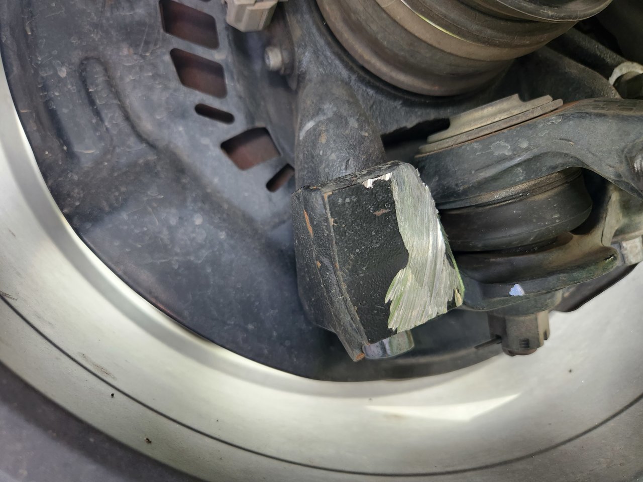

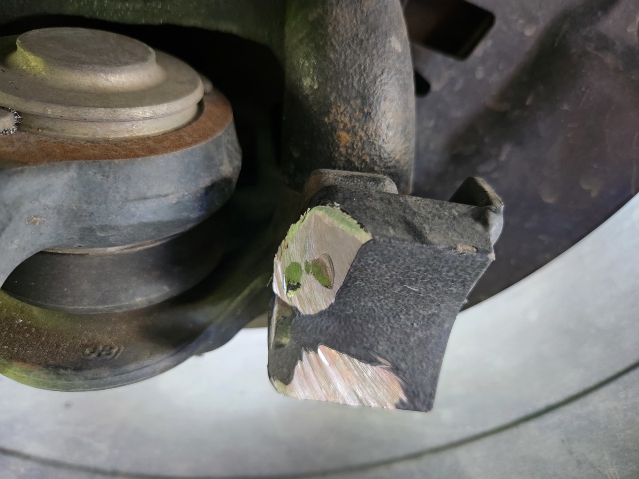

    I was able to grind a quarter inch of metal off the thick side of the stops and gained back alot of the original steering radius. I appreciate all of your input to help me solve this issue. 20230218_135529.jpg20230218_135817.jpg

    rdogg1 you may want to look at the turning stops and see if you can do what I did on mine. The turning radius has improved by at least 6 feet! I didn't measure except by making a U-turn in the same place in the street. At first I had to back up and do the Y turn in order to make the U-turn. By the time I was finished, I could make the U-Turn with 3 feet to spare without hitting the curb.
