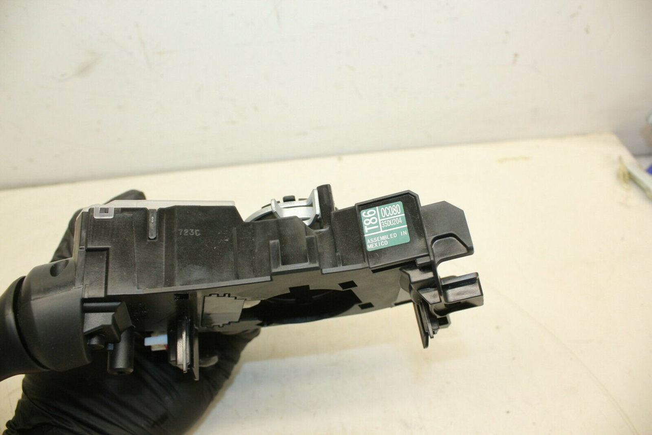

    Looking to add fog lights to my 2018 SR. Was shopping for a turn signal switch and came across a used one at an affordable price. Now I don't know what exactly I'm looking for or is compatible with my vehicle. Couple questions:
    1) The switch comes with power tilt controls. Does anyone know if all Tundra models are equip with this feature?
    2) If not, can I just remove the power tilt module from the signal switch assembly?
    3) Does the pictured switch look like the correct one for a 2018 Tundra? Seems different than other switches I'm seeing for sale
    Thanks

    That’s a lot of work just for fog lights.
    Just use a wire harness with a trigger switch coming from a 12v accessory and install your own switch.

    The switch won’t do anything because the control is in the motor. You will need to change the motor too to gain the function.

    And, while you're in there...I'm not sure about the SR, but there is an auto headlight mod I did on my SR5. All you need is the switch stalk, which you're buying anyway, and to buy the sensor and wire it into the dash. I think it's doable on the SR, but you have to add wires for the sensor where the wiring harness provides for the sensor in an SR5. I note that switch you have also has the auto lights position, but I agree with @NewImprovedRon, get another switch.
    IIRC, the auto headlight switch (with fog position) is only about $105 new. The auto headlights sensor was about $115, but unbranded or used are cheaper on ebay.
