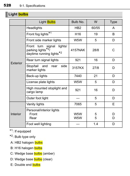

    Make sure you get the right bulb..
    Amazon.com: Toyota Genuine Bulb for Front Turn Signal Lamp : Automotive
