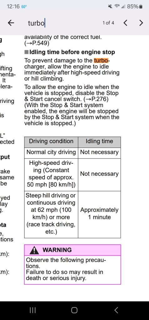

    FYI from the manual..

    DRP, what page in the owners manual is that “ idle before shut down “ info?

    Was 176 in mine. I just searched "turbo" on the pdf version. There's only a few entries so it was easy to find.
