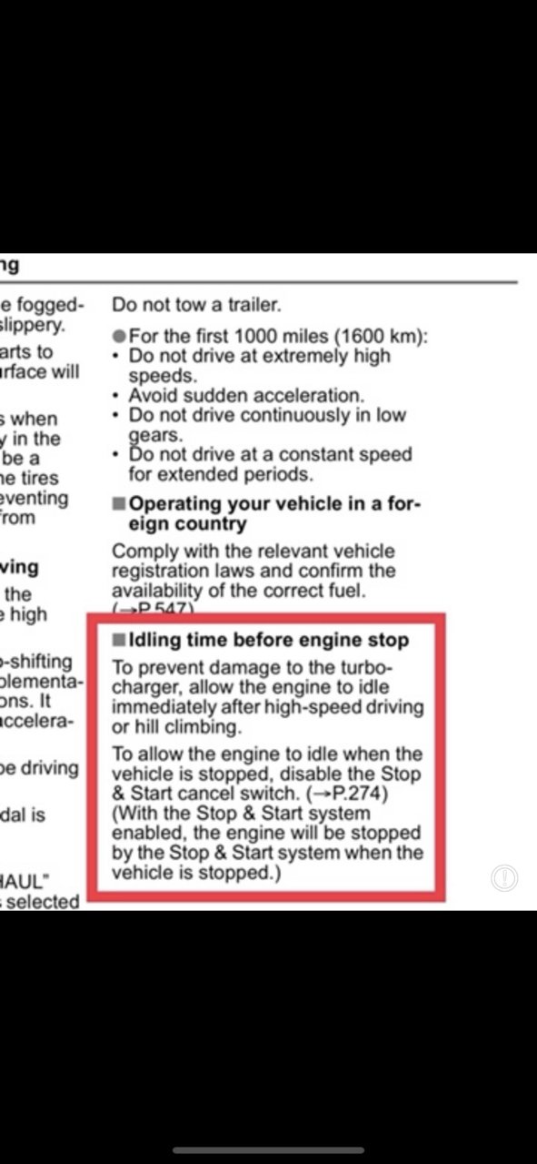

    It’s weird cause the 2022 owners manual does mention turbo cool down time, but only after driving under a high load. I’m guessing they’re mainly just covering their butts though.

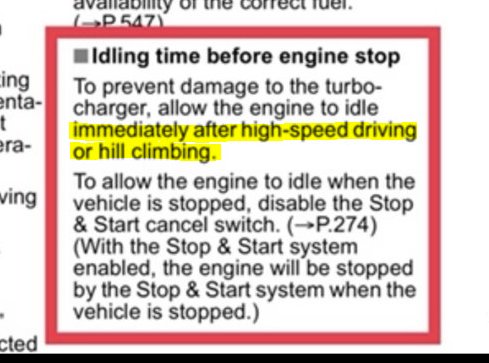

    They all say that, but the highlighted portion is important.
    Yes, don't climb a mountain and immediately shut it off. Don't run 80 down the interstate and then immediately shut it off. If you ran an hour on the interstate to get to a different city and then spend 20 minutes at less than 50 MPH to get to the movie theater, grocer, etc. then you are fine to shut it down.
