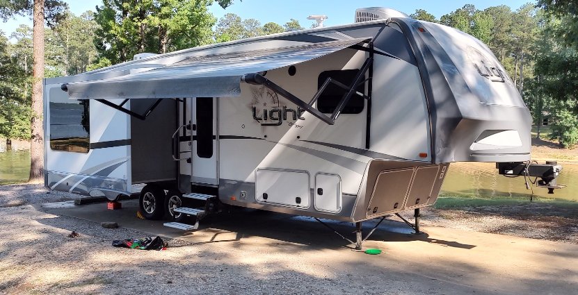

    I recently bought a 34' Open Range fifth wheel that's 7800 lbs. Our Tundra pulls it up any incline I've found yet without skipping a beat. By that I mean I usually have the cruise set at 67 and it goes right up without losing even 1 MPH. Now she drops a few gears and runs up to about 3500 RPM but has no trouble pulling it at all. Just yesterday we replaced the crap Bridgestone passenger car tires with 10 ply All Terrains. Other than that I plan on putting Timbren Suspension Springs between the leaf springs and the frame. For some reason the approach to every bridge or overpass is like a ramp and for some reason these engineers can not make a smooth approach to an overpass. It really bottoms out the suspension. The Timbrens are a big fat rubber spring that replaces your bump stop. Well... I just created my account and can't wait to see how many other Tundra peeps are towing fifth wheels. I drive a truck for a living so it just seemed a fifth wheel was the next step in this long camper progression. I've seen the guy on YouTube and it looks smaller and lighter than mine although his truck is the same color
    Let's see more Tundras pulling some fifth wheels y'all!!

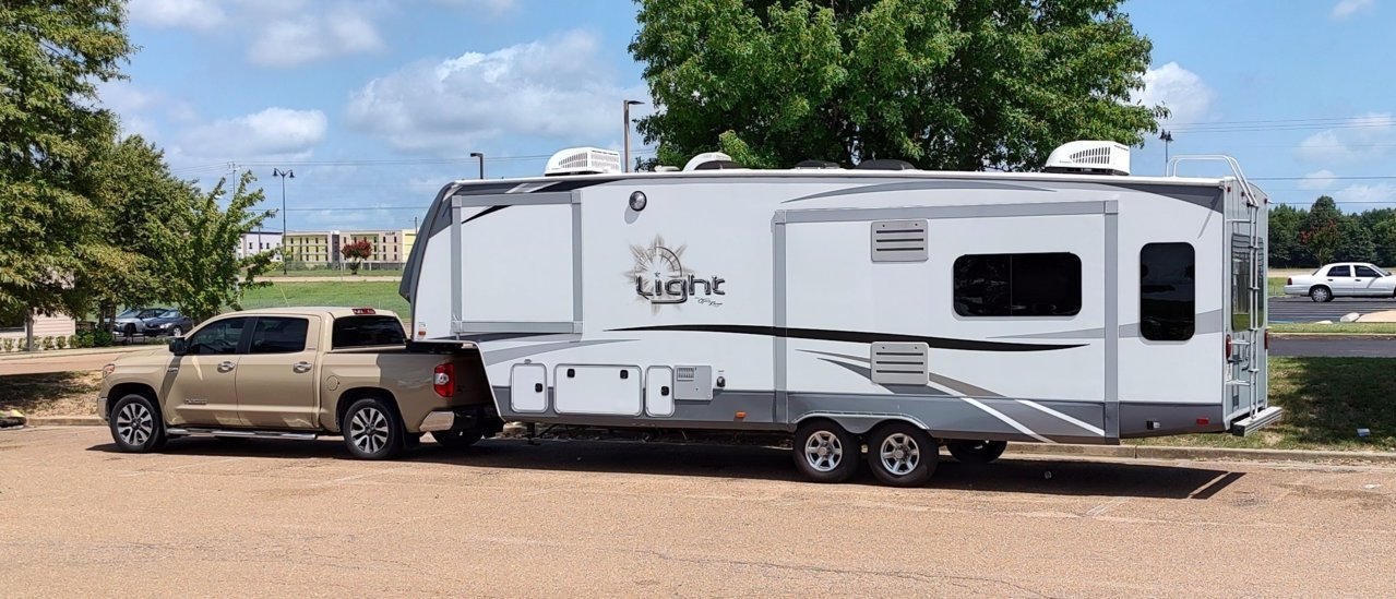

    It's designed for a short bed half ton... See the notch outs in the front corners so you don't smack the cab when you turn sharp? You're supposed to be able to turn 90° to the trailer without touching. I haven't turned that sharp yet.

    Got a CDL myself, and part of doing that job correctly is not overloading your rig. The "designed for a 1/2 ton" is all well and good for the shape, but not the weight on a 2007 truck design. It's designed for a 1/2 ton based on payload numbers given by the big 3, which are significantly higher than the Tundra's. You may as well make the argument that it is okay to hitch that up to a 1950 Chevy stepside because it's "designed for a 1/2 ton."
    The empty pin on that trailer is best case 920 lbs, you have a Tundra Crewmax with more options than my truck so best case a 1260 ish payload capacity. You've got maybe 340 lbs, but lets be generous and say 400 lbs of payload to cover the added weight of the driver, passengers, gear in the truck, 5th wheel hitch in the truck, your extra springs in the truck, and any added pin weight of filling tanks, batteries, propane, and supplies in the trailer. There is no way you can scale that truck as you tow it and be within the manufacturer's limits.
    You do you, but please don't encourage others to do this.
