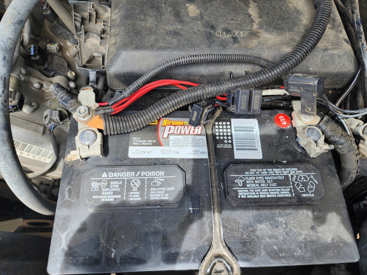

    Picked up a new to me 19 tundra 5.7l about 2 months ago. Had about 2 weeks and it wouldn't start. (Dead battery) took it to schwabs and got a new one. Today the same issue, schwabs replaced the battery. So now I'm thinking alternator. Dug out the meter and with it running it reads 13.5volts. Isn't this within reason or should it be higher? I'm stumped

    Not super mechanically inclined but the fuse looked fine, terminals in good shape. Looks like it has a parasitic draw. Pulled the negative cable and tested it with the meter. Was hovering at 1amp to 90mil amps. Is that the culprit for dead batterys? The previous owner had installed after market stereo,Amp, subs. Running board lights, 6 different light bars.. viper alarm. Going to assume one of these is the issue.

    Yeah, I'd start by disconnecting one at a time and measuring to isolate the culprit.

    Are there any additional wires added to your battery terminals? If the main power to the amp or subs was connected directly to the positive terminal, my guess is your problem lies there. You mentioned 90 ma to 1 amp? 90 isn't too bad but 1,000ma is a real problem.

    It was only about 90 to 100ma. It took roughly a month to kill the last battery. There's several other wires hooked up to the positive terminal. I went thru and disconnected everything 'extra' that was on the battery. Still had a draw...the only way I got it to stop. Theres a heavier gage wire hooked up to the battery that goes to the fuse box I believe to power it. So I pulled fuses for radio, alternator etc..no luck. It's a bit beyond my capabilities of figuring out.
