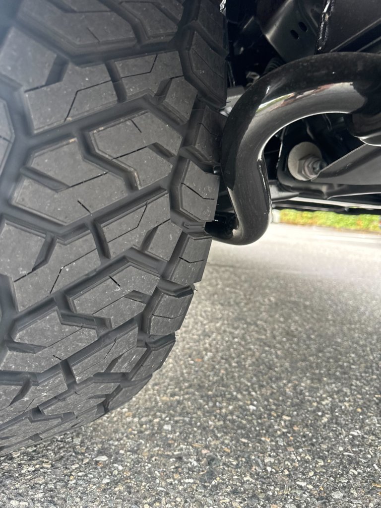

    Hello all - I recently purchased a 2024 Tundra Limited with TRD off-road and factory 3” lift. The dealer installed 35s (295x65x20, Toyo Open Country R/T Trail) on the 20” TRD off-road wheels. However, due to inner anti-sway bar rubbing, I had to get 1.25” spacers from Spidertrax, yet, still rub when in doing full lock to the left going straight. I'd assumed that since the TRD wheels are +50mm offset and with the 1.25 inch (-31.75mm) spacers, the adjusted offset should be around +18.25 offset but was surprised that it still rubs on the inner anti-sway bars. I am reaching out for help, to see what wheels / tires / offset combo works for those who have the same 3" factory lift that fit 35s successfully, without any body mount chop / modifications.
    After much research, I am thinking of doing either a 0 or +18 (most likely 0 offset at this point) offset Method 305NV 18" wheels with BFG KO2s in 35x12.5x18 tires. Will this work? Any insights or help here would be MUCH appreciated, thanks!

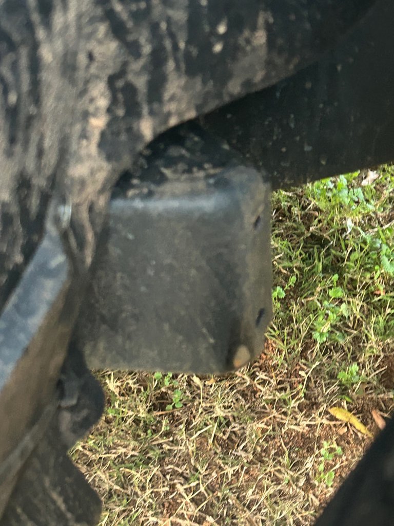

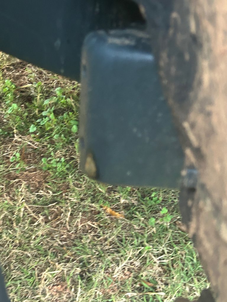

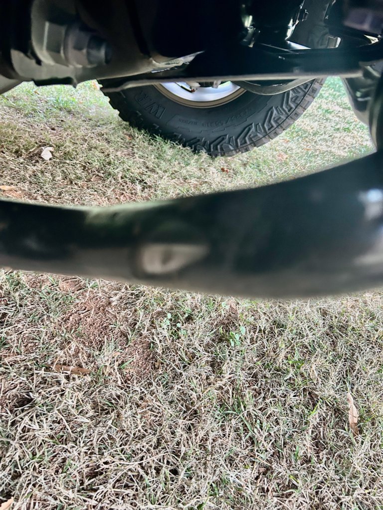

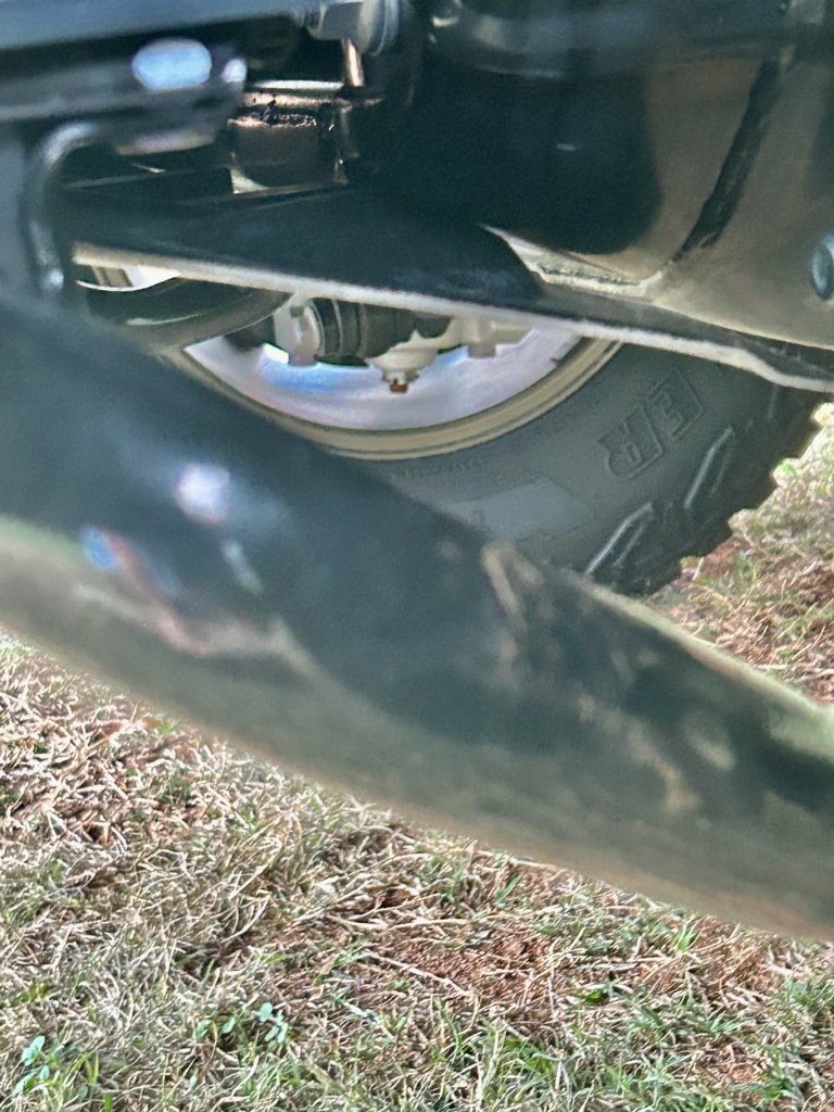

    6x12.8same here my 2024 platinium with the trd 3" lift rubs greatly on the sway bar due to the not only drop but the TRD kit moves it forward about 3-4" that is what is preventing me from going to 37x12.50 BFG KO3's. I have a +25 offset ICON Rebounds (18x9) with GY Wrangler Territory RT tires 325/65R18 (34.6x12.8") and they rub. I tried a Method 18x9 with 0 offset it rubbed worse on the fender liners front and back but not the swaybar that I could remember but I only got one mounted and they checked and rubbed so bad I sold the methods and bought these ICONs with +25 off set. Still rubbing as pics below show, but not on fender felt since removed the one brackets and pinned back liner on both sides, cut mud flaps a little but still there.
    trying to find a different drop only like ICON or FOX kits, and or moving back to stock position as I can't understand why it needed to move forward, down 2-3" maybe I could understand, as the suspension dropped roughly 3" for the lift (in respect to the LCA, but it didn't move forward or backward)? even then I don't understand why they didn't just change the links connecting it to the LCA vs moving it forward and down. I haven't checked if anything hits or would hit if moved back. I also like above recommendation of checking out the TRD PRO sway bar is it same just red vs. black or different size. Also the weird shape of the sway bar is bizarre nothing like my side by side or FJ cruiser. Will edit and post picks shortly.
    Passenger side:
    Driver side.
