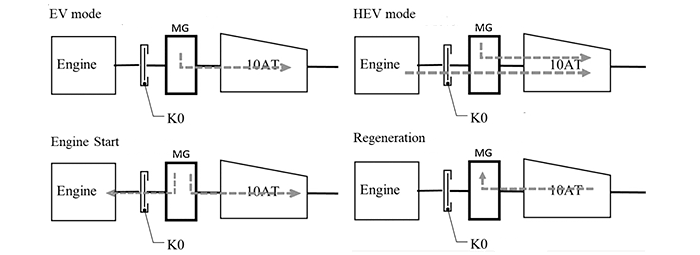

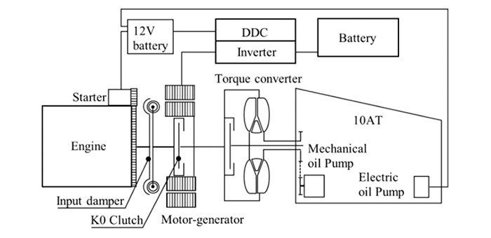

    Yes Sir there is no torque converter on hybrid's.

    There is a torque converter on the hybrid. The engine is connected to the electric motor via a clutch which is connected to the transmission via a torque converter.

    I was pretty sure there had to be something there, or else the truck would stall at a complete stop. Much like a manual trans vehicle.

    You can’t stall electric motors.

    The Tundra is not all electric. So.....the gas still needs a disconnect for the trans. Or it will stall.
    Addin. Your CAN stall an electric motor. Just the more power it is, the harder.
