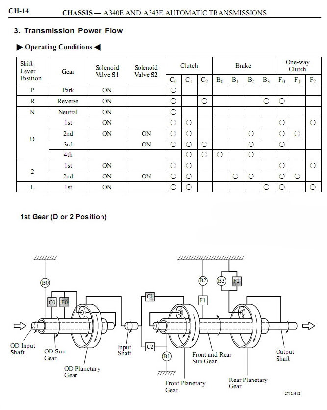

    Whats the fluid look like? I'd lean to a burnt clutch pack if the fluid was recently changed. But maybe a stuck ball.
    If it was a solenoid, it would try to jump into 3rd when you put it in drive.
