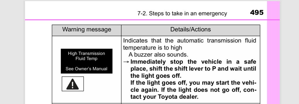

    No indication while towing?

    That warning never came up.
