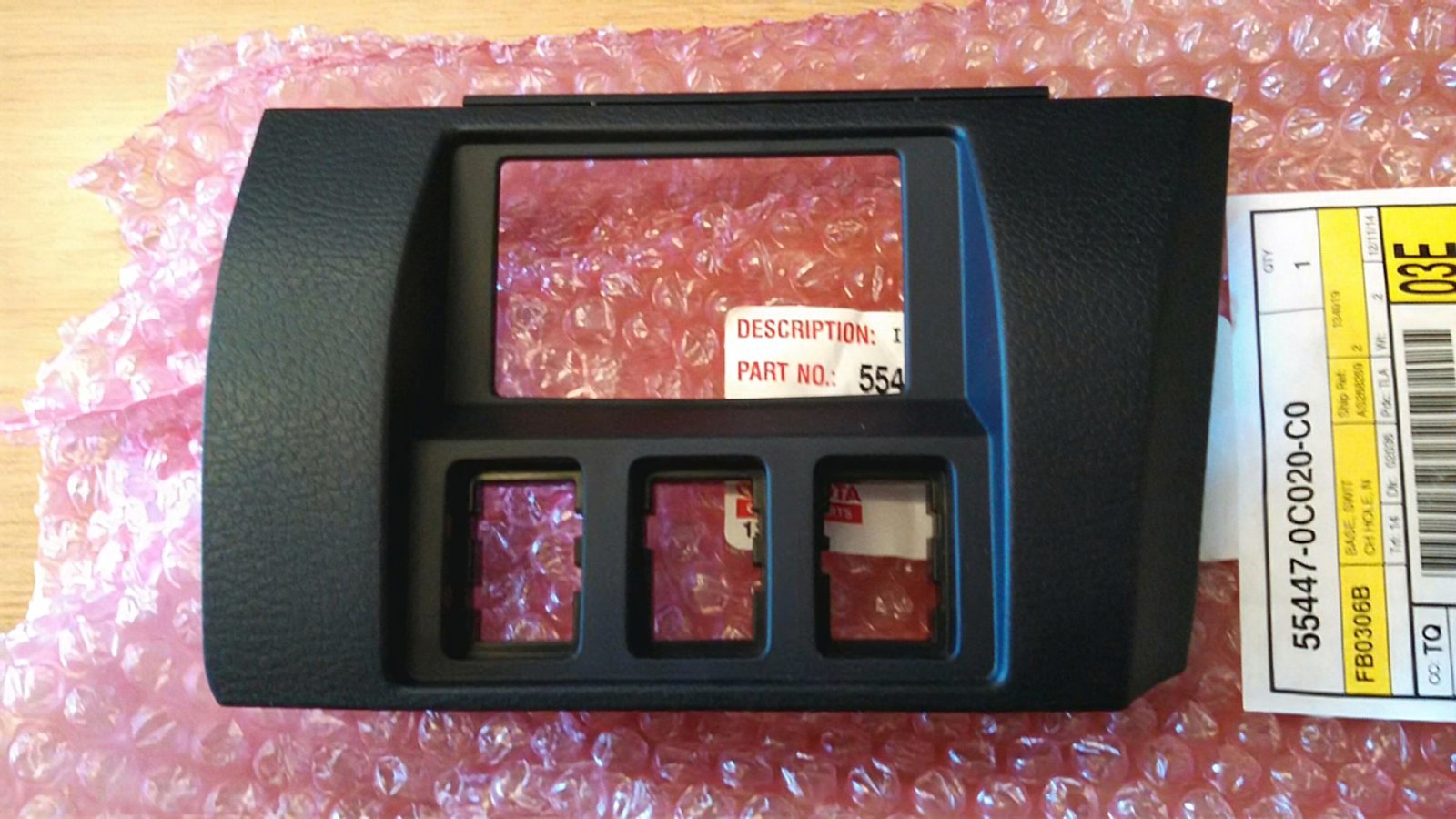

    Your 3015 SR does not have a trailer brake controller from the factory. I have a 2015 SR5 and installed a Tekonsha P3. It was an easy install using the dealer purchased OEM switch panel. You can see the Toyota part number in the photo.
