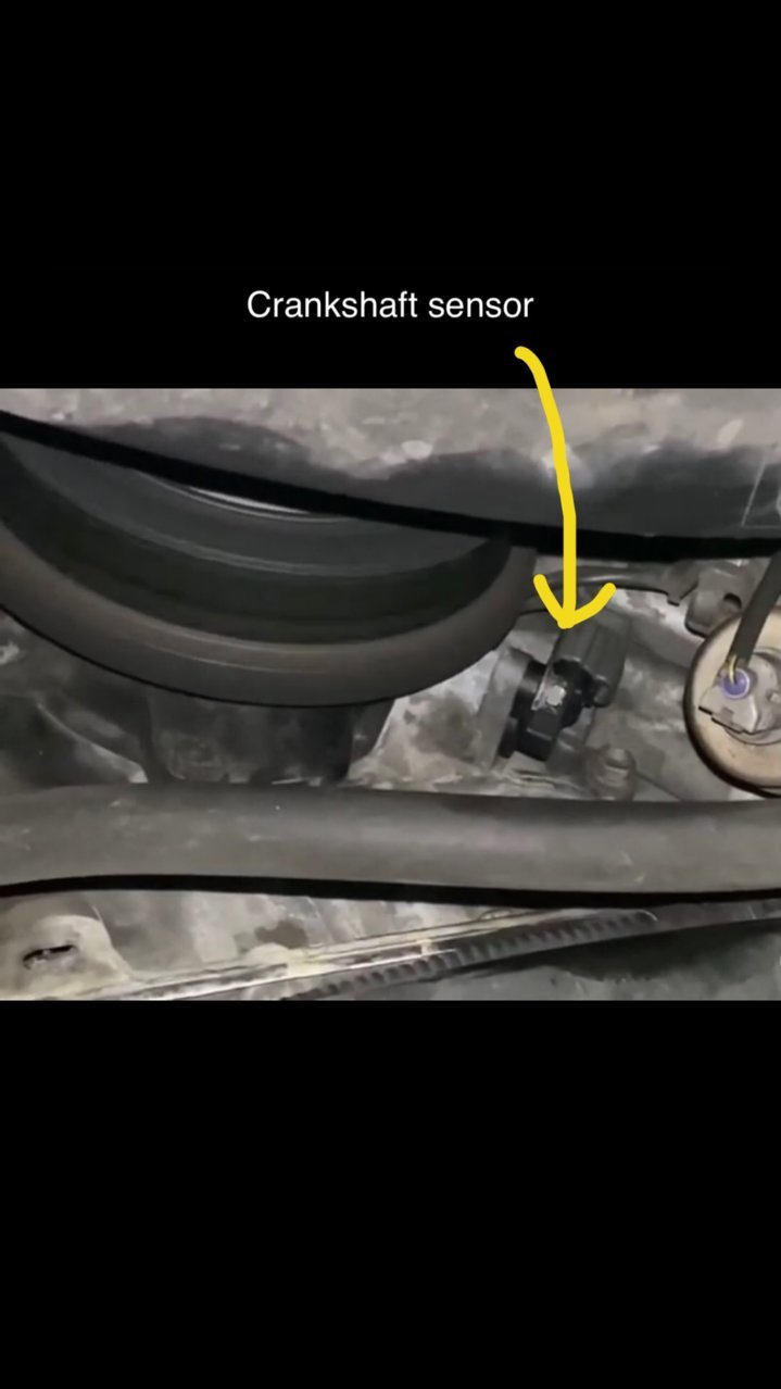

    So a really good mechanic went through it, CPS(crankshaft position) is damaged non functioning, RPM is not being read by snap-on computer, battery is screwed as well

    That’s a pretty easy fix. The Crank shaft sensor is located on front of the engine right behind the crank pulley, remove your skid plate and fan shroud for easier access, btw I recommend getting OEM part.

    Crank sensor was changed and fixed our issues, oil leaks are up next to be patched up! Thanks for the help guys!
