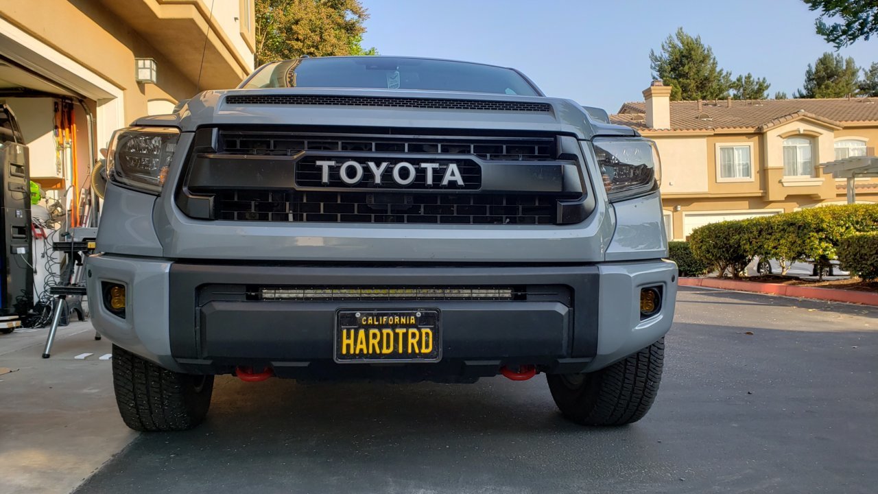

    Paint matched mirror caps, grill surround, hood bulge, and Bumper Shellz Wireless phone charger in center consule TRD rear sway bar Black painted TRD off road wheels with TRD center caps Black emblems TRD air filter Tyger roll up tonneau cover Extra USB plugs in cab TRD Pro grill Paint matched Bumper Shellz 1.25" Spider Trax spacers Lamin-x fog light covers yellow-removed Diode Dynamics SS3 amber fogs Bilstein 5160 rear shocks DIY bed rail system AJT TSS relocation bracket AJT interior chrome delete bits and pieces Caliraised LED 32" light bar bracket GG Lighting 32" light bar
    What year grill did you buy? If it was for a 2020 it should work with your current sensor. Just need to swap them. I have a 2019 truck with the sensor. I bought a pro grill for a 2017. It does not have a place for the sensor but I bought the relocation bracket from AJT and it works perfect. No issues
