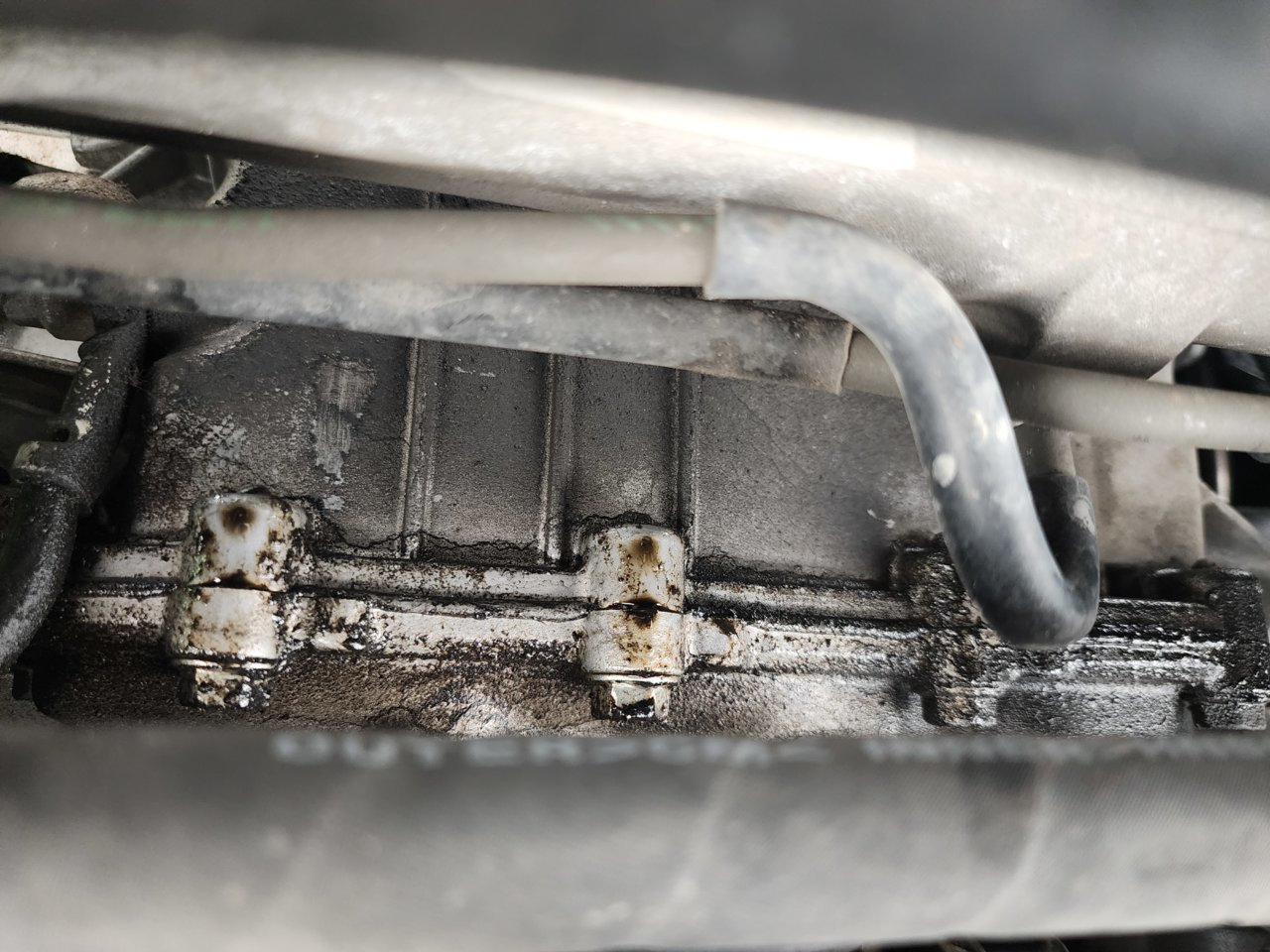

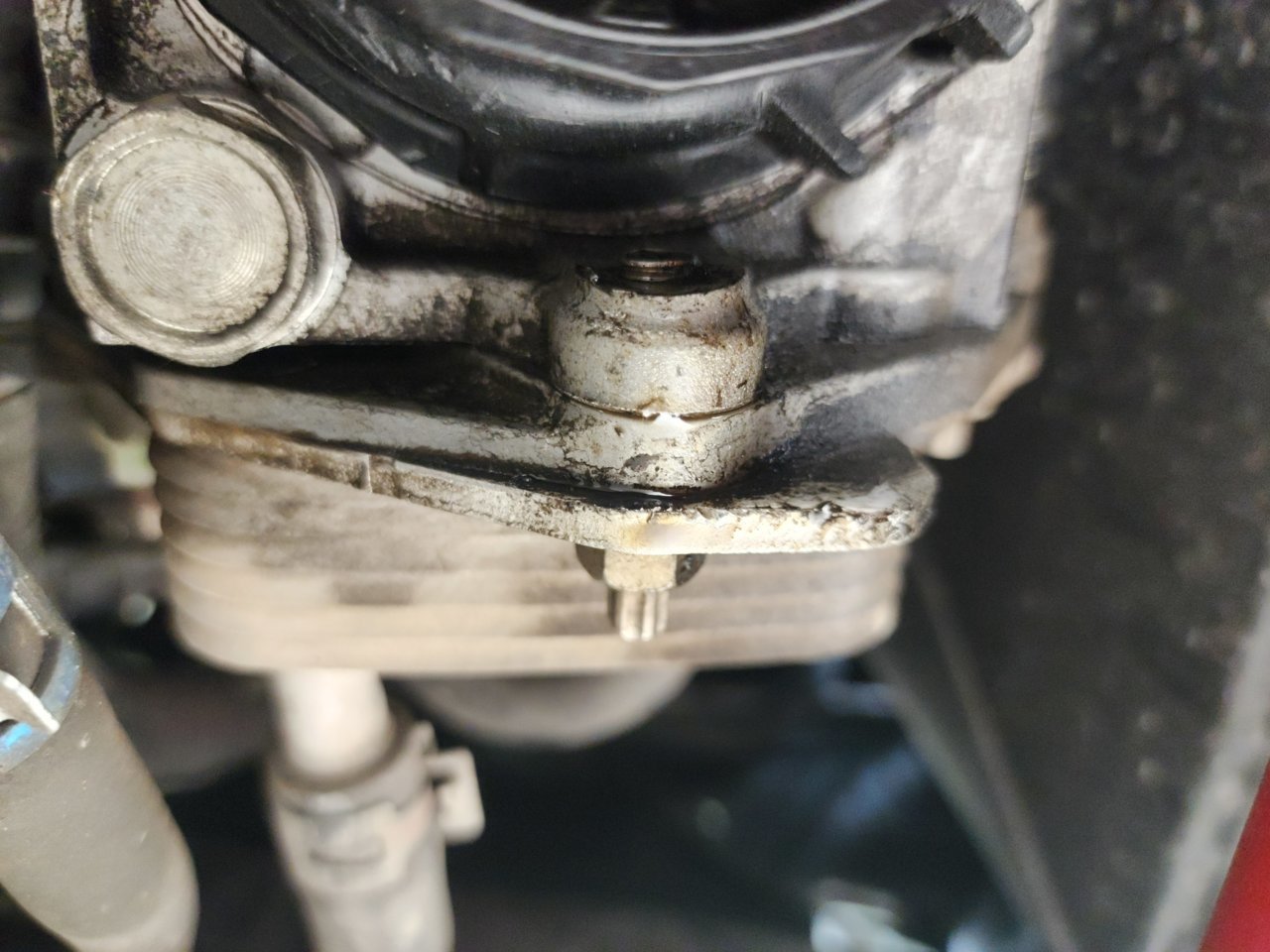

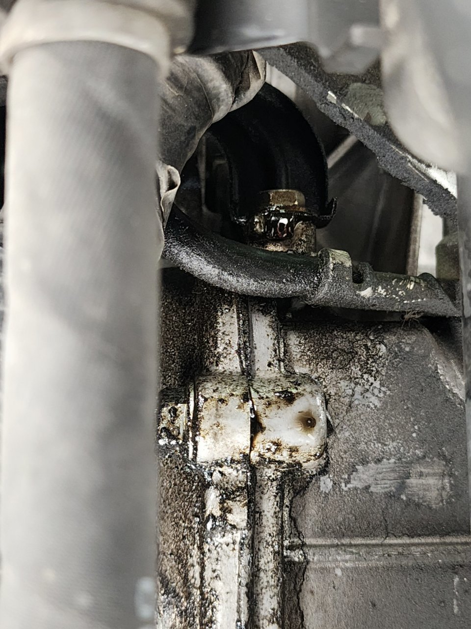

    Hey I'm looking for some input on this issue. I am already taking it to a shop June 1st but wanting some extra opinions on the issue. I am having some oil seepage, still haven't had any oil spots on my driveway yet.

    The oil seems to be fairly widely dispersed, which might make it difficult to determine a source. I would humbly recommend cleaning the affected areas, then check it over the next few days/trips to see where it starts re-appearing first. That may help you to find out where it's coming from (without all the extra oil).

    Yeah, what he^ said. Start be degreasing it and then keep checking to see where it originates from. I believe we have had members with leaking oil coolers, easy fix.
