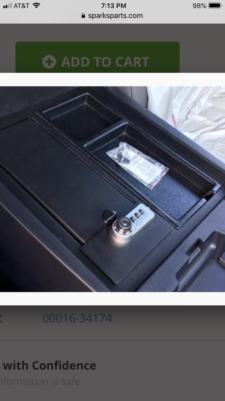

    Where do you live? Is your a like this one from Toyota? I have one of these and will let you try my key. I’m in DFW area of Texas50F19793-A684-443E-BB64-4FC019AB9152.jpg

    That's the one I have. I live in Miami. Did yours come with 2 keys? I cant remember if mines did.
