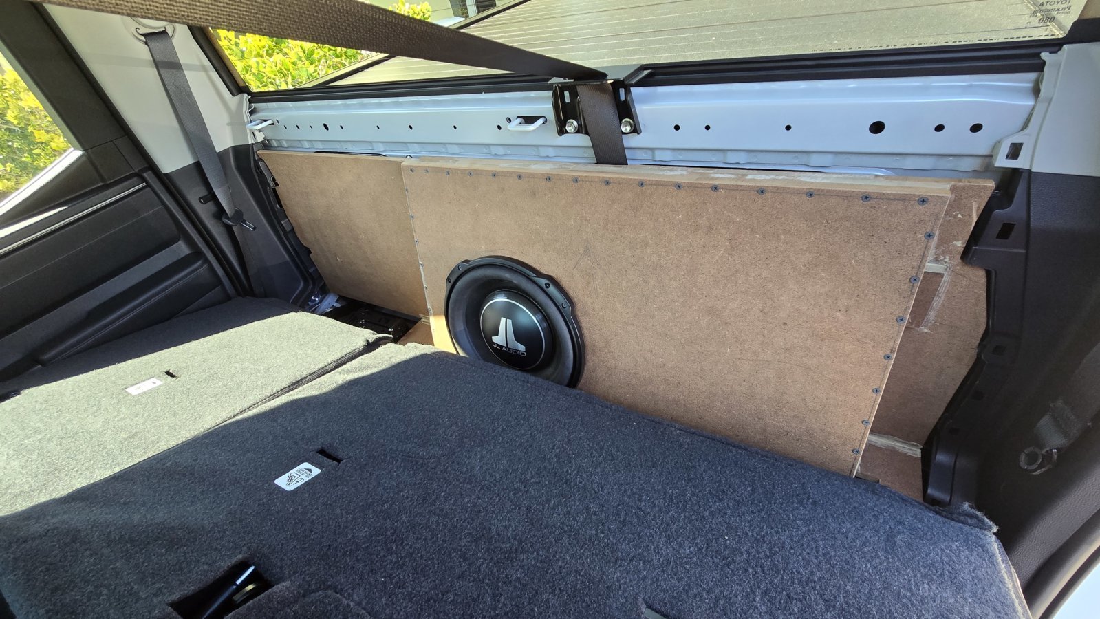

    Well, I haven't done much yet. Life keeps getting in the way of progress. I can't share any success stories until complete but I can share the journey.
    Picked up my Limited at the beginning of February. So far I have built a speaker box for the JL Audio 12TW3-D4 sub that I pulled out my Tacoma. I was hoping that I could just drop the box I had in the Tacoma into the Tundra. The fact is that there is not as much space behind the seats in the Tundra. The sub barely fit, if I can really say that, the ring touches the back of the seat when closed. Another disclosure that I was not happy about is that I had to use half inch MDF instead of the standard 3/4 inch due to the spacing. I didn't want to give up my under seat storage which is why I didn't go with the hybrid. I also decided against al the fancy/expensive DSP units to get the center channel dash speaker operational. The plan is to use Audio Control LC7i for the front speakers and LC2i Pro for the rear door speakers. I'll use the LC7i to combine the front three channels into one (tweeter, door driver and dash speaker) before routing to the amp. Similar for the LC2i Pro for the rears.
    My goal is to minimize the cutting of factory wiring, so I had my buddy in Japan or this harness that is supposed to connect the the factory harness and the factory JBL amplifier under the seat. I have not verified that it fits but it is supposed to allow access to take the speaker level inputs from the amp and feed them into the Audio Control units. The audio control units are then connected to the amplifier, in my case using an alpine PDX-V9. The output of the amplifier will feed to the wires of the other connector of the harness from Japan, which would allow me to attempt to use all of the factory speaker wiring. I don't yet see how I can run new wiring through the doors.
    So, still a few things to figure out and I'm sure hurdles to get over. Here is a pic of the mentioned enclosure with space on the passenger side for the amp and line converters. More to come...

    Breathing Borla
    Jan 21, 2020
    #41531
    6,596
    Northern Illinois
    you need more screws in the box, HA!
