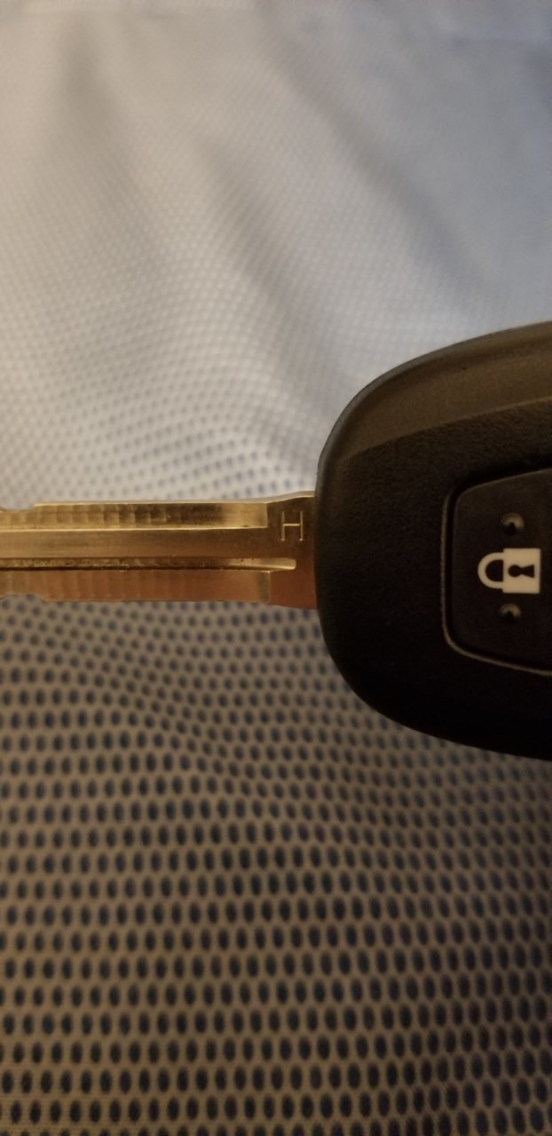

    What is the difference on the H-key, G-Key, and regular key for a 2019 tundra. I have a '19 platinum with the FOB integrated into the key and am trying to get a good answer before purchasing remote start.
    I have to assume the regular one has no FOB or security chip.

    Look where the key blade meets the plastic fob. On one side there will be a letter engraved on the key. My 2018 SR5 has an H and I'm going to assume yours does too.

    Yep! I noticed that not long after I posted this message. Thanks for your response.

    Mine is an "H". '19 Platinum.

    Nearest I can tell, the 2018+ have the fob intergrated and uses an "H" chip, 2017- is separate and uses a "G" chip.

    So I had a discussion about this with the parts guy at my local dealership when I there for service on the wife’s 4Runner. Both G and H keys have chips that are needed to start the truck. G and H don’t interchange, but you can buy the G key from a 4Runner, get it cut, program it and you will have an all in 1 key/fob for your 14-17 truck. They dealer wanted like $375 to do this. You can probably buy a key on eBay then use tech stream for much less.
