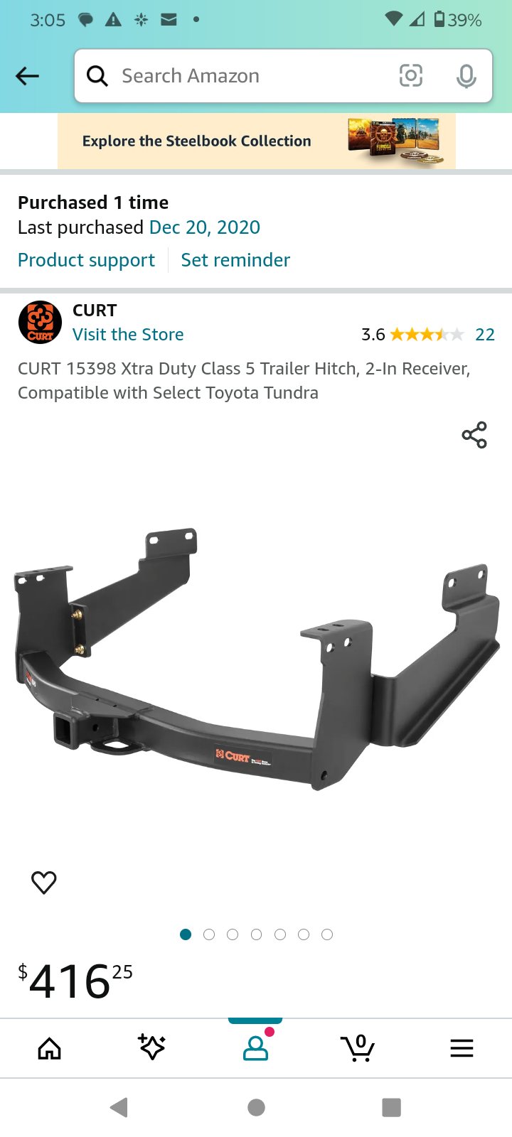

    What the hell did they do? Once steel reaches it's yield, welding becomes a band aid and often needs a little more than just a weld. It often becomes necessary to add gussets and such to compensate for material weakness. Curt makes a really heavy duty Tundra hitch, very nice product, she is heavy and around $400.
