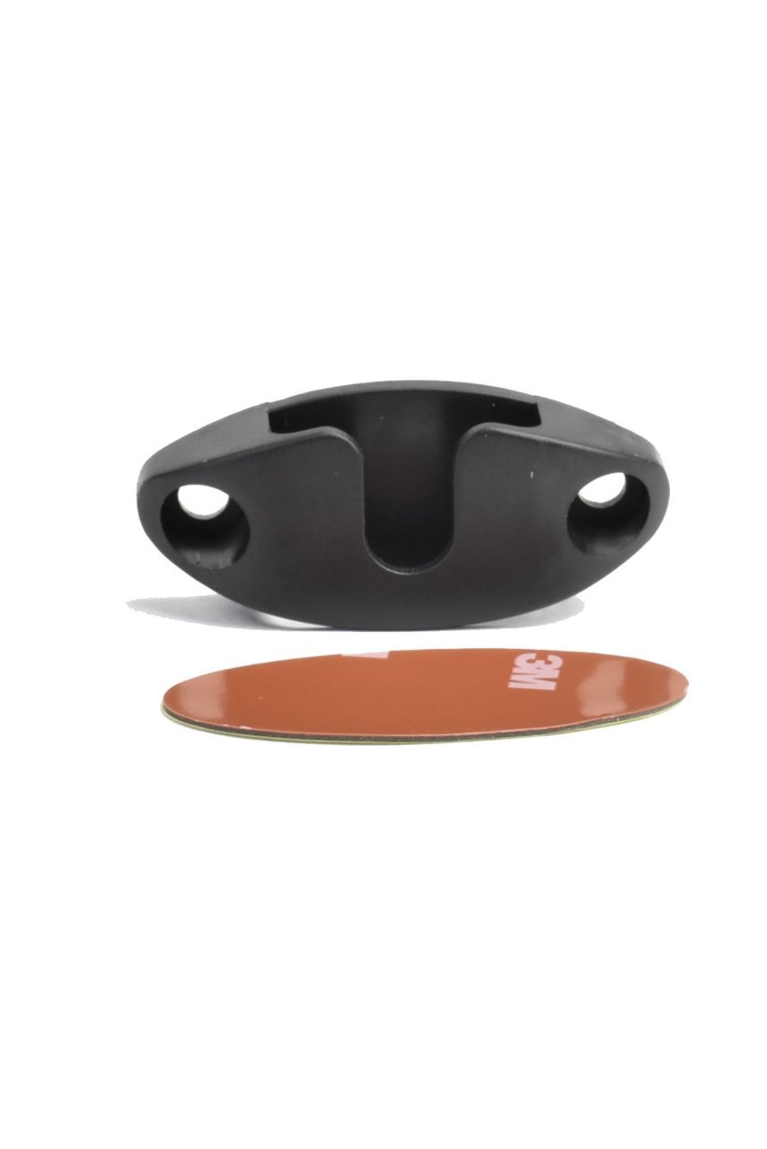

    They make a cup holder thing too for the mic and head. The yaesu suction mount seems to be working so far as @abomb60 has his.

    I got one of their cupholder mounts a few years ago and wasn't impressed with it, too much vibration.
