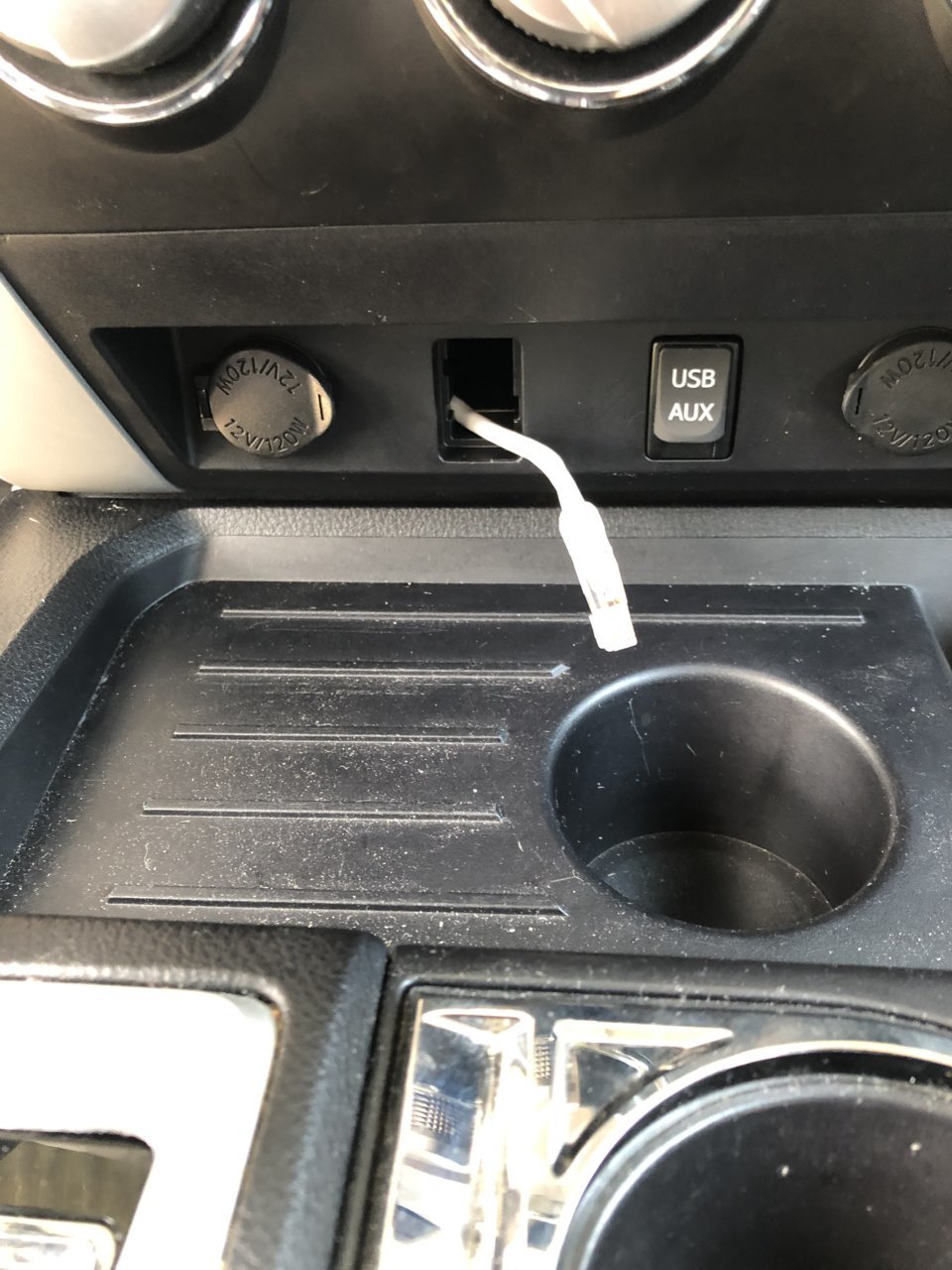

    My installation has begun. I’m installing a TM-7A in my 2015 Crewmax. My goal is to drill/cut on the truck as little as possible, minimize visible wires, and have no rattles or squeaks.
    I tracked down an old detach kit on QTH Classifieds and have started with mounting the chassis first. I tried a few ideas for under the driver’s seat, but I couldn’t find a way to mount it that worked for me. I decided to put it in the unused space behind the back seat. I tried and failed with a couple of homemade designs using what I have on hand. I ended up with this:
    I’m going to run the wire for the external speaker and the CAT5E cable for the mic under the carpet to the center console area, under the cupholders.
    I’m hoping to snake the speaker wire up behind the climate control panel and radio to the space where the center dash speaker is.
    The CAT5E cable will couple to this panel mount RJ45 connector. I was hoping it would fit in the blank space between the 12V sockets, but it is the wrong shape. I’m going to have to cut a square hole between the two rectangular spaces
    The backside of the panel and RJ45 connector...
    Any thoughts? If this won’t work or is not a good idea, I’d sure like to know before I get the Dremel out.

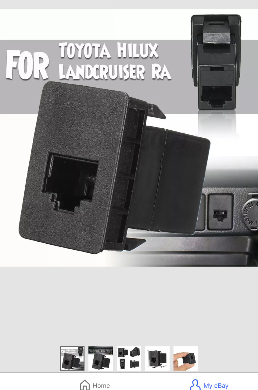

    I think if you get a standard Keystone style RJ connector and try it there may be one that just slides into the blank spot that yours will not?
    Have you looked for any other couplers?
    This one comes on a plate and looks like a close match to me

    Madman, I have the Kenwood DFK-4C kit. They are as rare as hen’s teeth, but I found one for sale on an online classified ad. It was missing the mic extension cord, but I have some CAT5E laying around and I bought a coupler and the panel mount in the picture.
    I didn’t even think to look for a RJ45 connector that matches the blanks on the panel, but sure enough, eBay has a few different flavors that are designed for Toyotas and appear to have the correct dimensions.

    I ran the mic and detach wires earlier this week. From behind the rear seat, under the rocker panel trim to the carpet overlap under the driver seat.
    From there I connected the coupler (I had two CAT5 cables laying around, but neither are long enough to stretch from the back to the front) and ran the wires under the center console.
    I ran the CAT5 cable down the left side of the transmission tunnel, around the screw that holds on the trim piece and back to the power bank area with the 12V outlets.
    As soon as the blanking plate with the RJ45 connector arrives, I’ll plug this in and snap in the blank and hopefully it will look like a factory option

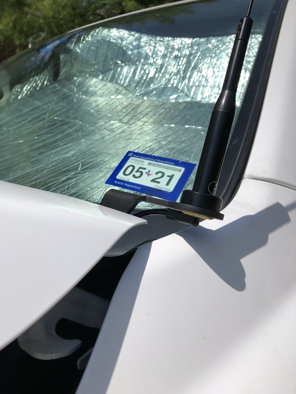

    I finished up the power wiring this morning. At the battery, I spliced in a waterproof 15A fuse holder to 10AWG wire and ran that to the driver’s side grommet in the fire wall. This may be obvious to everyone else, but I found out the hard way that pushing the wire from the cab to the engine bay is a million times easier than the reverse... I am going to secure that power wire to the fuse box later, just to keep it tidy.

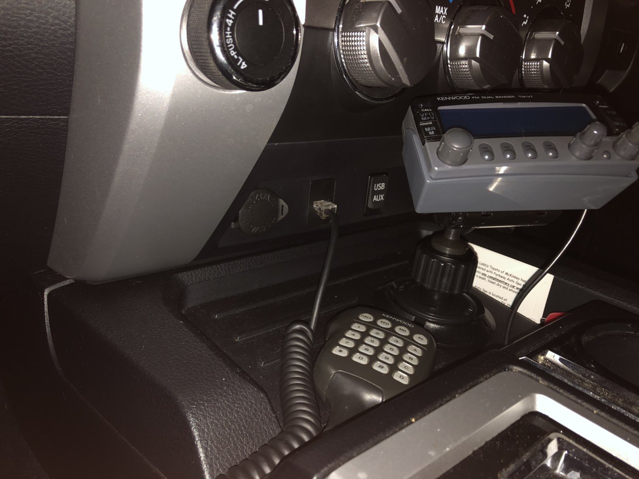

    I popped off the kick panel and the rocker panel trim and used 1/2" split loom conduit to run the power to the back of the cab behind the rear seat. I had to leave out the conduit at the space between the front and rear doors because I couldn’t make it fit through the space there.
    I got a LIDO 801EXP cupholder mount for the head unit, and I will probably drill a hole here, install a 5/8" grommet and feed the detach wire through.
    I have a borrowed mag mount antenna I used to test the rig so far. It all works.
    My next decision is antenna and mount type and location.

    Since this thread is still going, I’ll post up a few pics of my finished install. I have lots of pics and details of the process, but I’ll just attach the results here. I stole a bunch of ideas from this thread, so thanks to all who have contributed.
    Still looking for a good mic hanging solution...
    Side note:
    I had a hard time trying to push the PL-259 connector through the small hole I drilled in the floor grommet. I tried a few things that didn’t work, but what seemed to work really well was duct taping a 1/2"-drive T50 Torx bit to the connector (I wrapped the connector in painters tape first to keep the adhesive off of it) and it squeezed through without too much trouble

  30. Jul 29, 2020 at 1:14 PM
    #360
    SC_TRD
    SC_TRD Big BASTRD 4x4 Enthusiast
    Jun 14, 2019
    #31909
    1,182
    Colin
    Round Rock, Tx
    2012 CrewMax & 2008 Sequoia
    Looks Good!
    What type of bracket did you use? Is that just a standard Ditch light bracket, or does someone actually make an antenna specific mount for this location?
