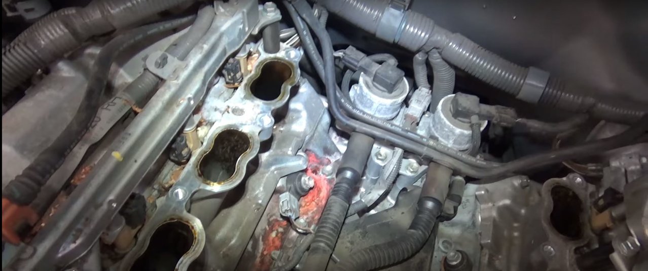

    I had the P033D Sensor 4 high bank 2, obviously zero knocking noises, little lifter rattle but at 181,xxx miles that's to be expected. So i read all about it and LOTS of write up about rodents chewing threw the wires and setting this off, delay, delay, delay (i'm too lazy for my own good). Today the intake manifold comes off and i find:
    PANIC SETS IN! Sh*t a cracked cylinder head or block!!! Thank god for forums, within 10 minutes realize it's not time for a new engine, thanks to this awesome dude!!

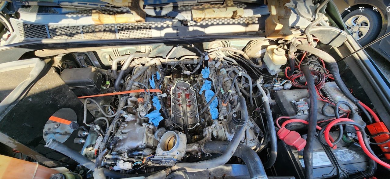

    and so the heart surgery commenced:
    She's ready to reassemble tomorrow morning!
    QUESTIONS:
    Should I pre-emptively replace the air injectors? since they're out already now...
    Any tips / anger management suggestions for installing them back?
    I thought It was just gonna be tedious and boring but has transformed into 2 DAYS so far! Strangely enough, my water pump failed this time last year also. :notsure:
