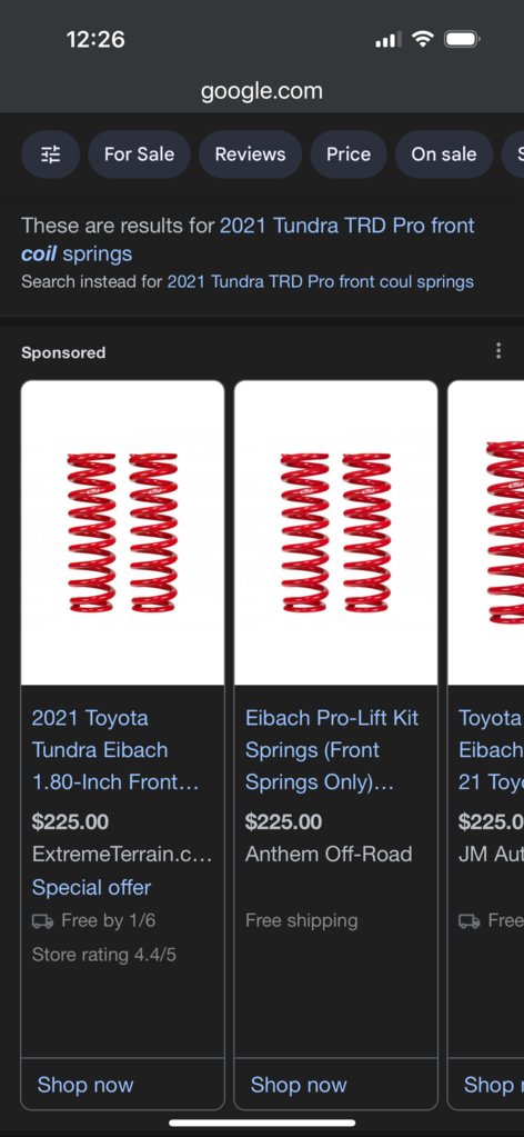

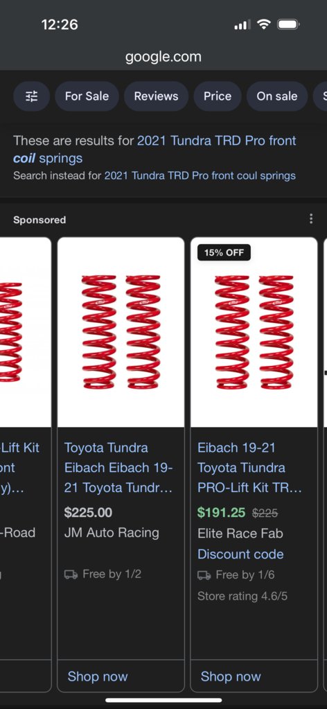

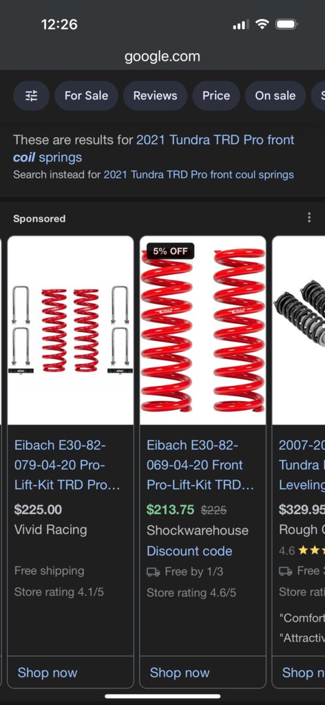

  16. Dec 30, 2024 at 11:28 AM
    ColoradoTJ
    Feb 24, 2016
    #2766
    40,247
    Plenty of options.
    Springs break. Seen it happen a bit.

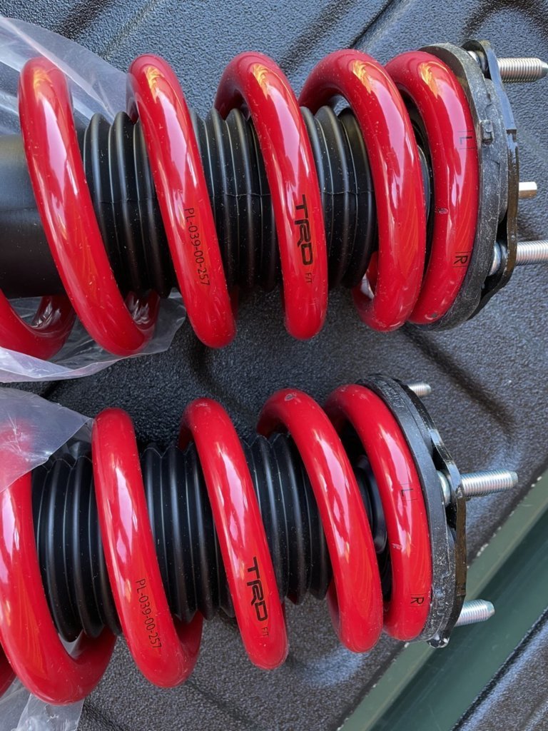

    Yep, they are the same springs. My bad. Here's a pic from when I installed mine. Same part numbers on the shocks:
    Maybe this p/n helps the OP?

    Are you able to get Toyota OEM PN for just replacement spring? I wouldn't be surprised if Toyota only sells the whole coil over assembly.
    I saw the image above showing a PL-039-00-257 part number printed on the spring, but that is not the PN toyota uses for ordering. Can your dealer provide the PN for the spring they claim they can't source?
