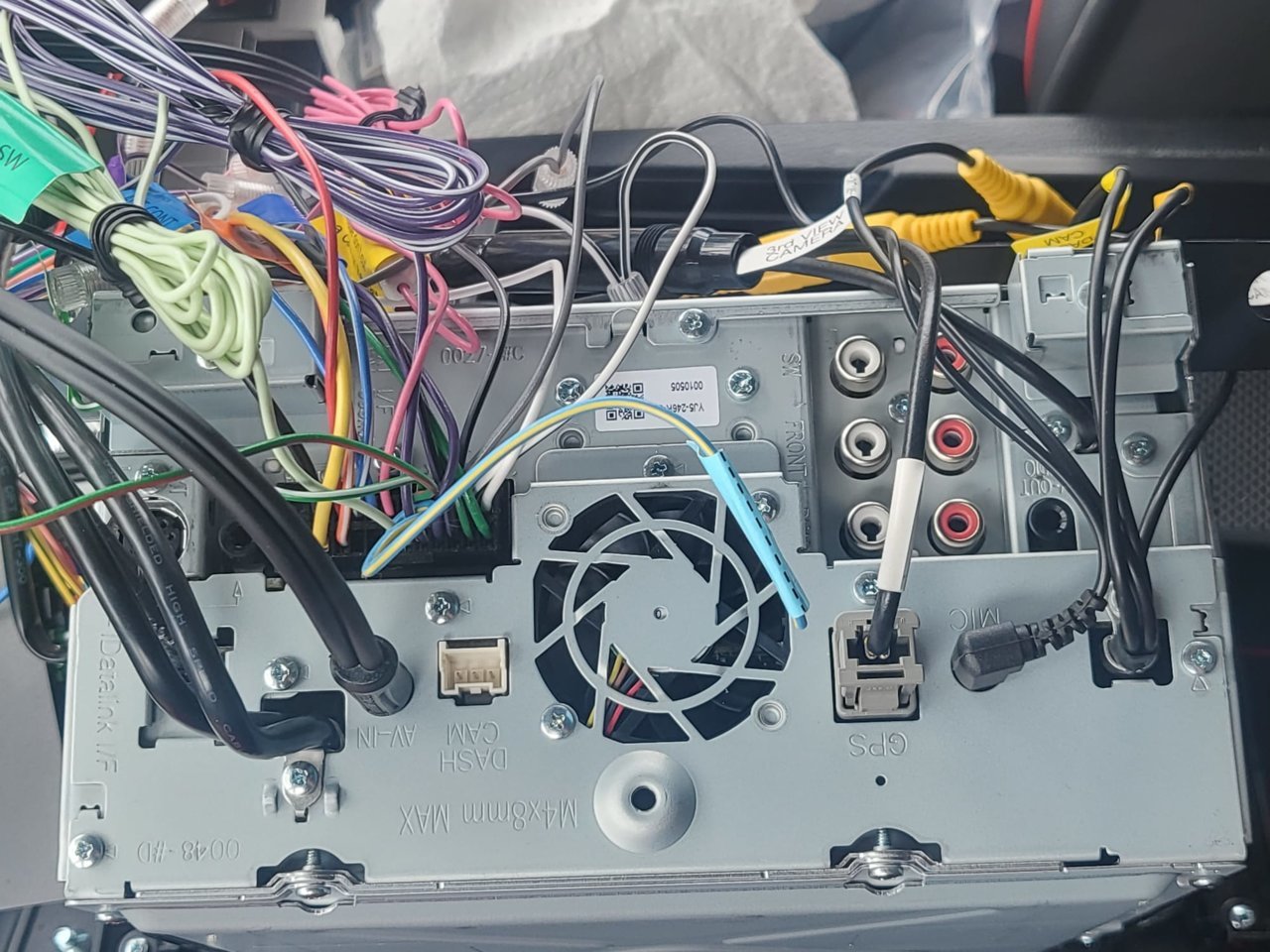

    Hi guys, i signed up here few weeks ago, and now would love some advises. Im a rookie about have a Tundra and upgrade stereo. I will try to be descriptive, for sure i'm missing something and i know you can help me guys.
    What i did:
    Connections made on the HRN-RR-T02:
    White - LF speaker +
    White Black - Lf speaker -
    Gray - RF speaker +
    Gray Black - RF speaker -
    Green - LR speaker +
    Green black - LR speaker -
    Purple - RR speaker +
    Purple black - RR speaker -
    Blue white -Amp turn on +
    Black - Ground
    Red - Accessory +
    Yellow - 12v +
    Orange - Illumination +
    Pink - Vehicle Speed

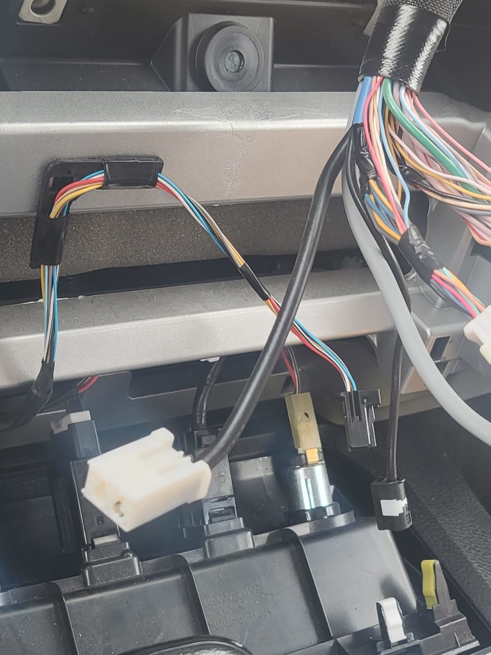

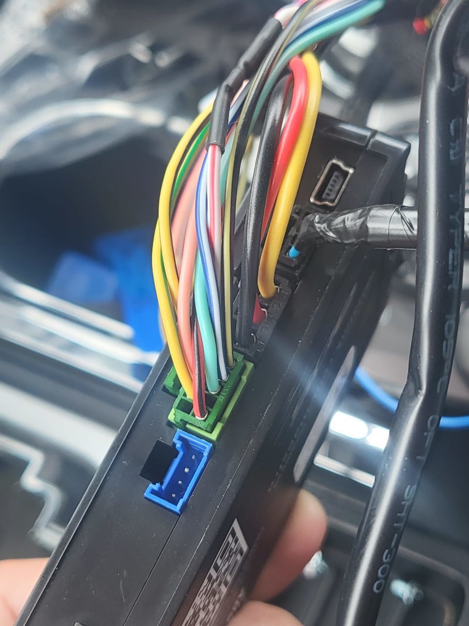

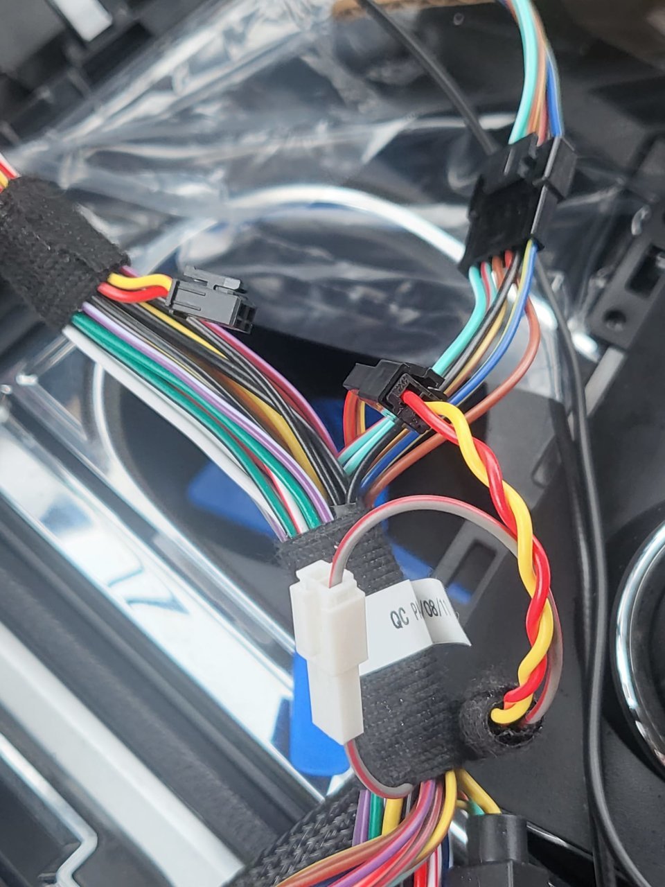

    I will provide pictures about my connections below, i connected RR maestro 18 pin, 10 pin green, 3 pin and data cable in the black port, and OBDII connection too, Antenna GPS is connected too (radio one)
    Steering wheel is out

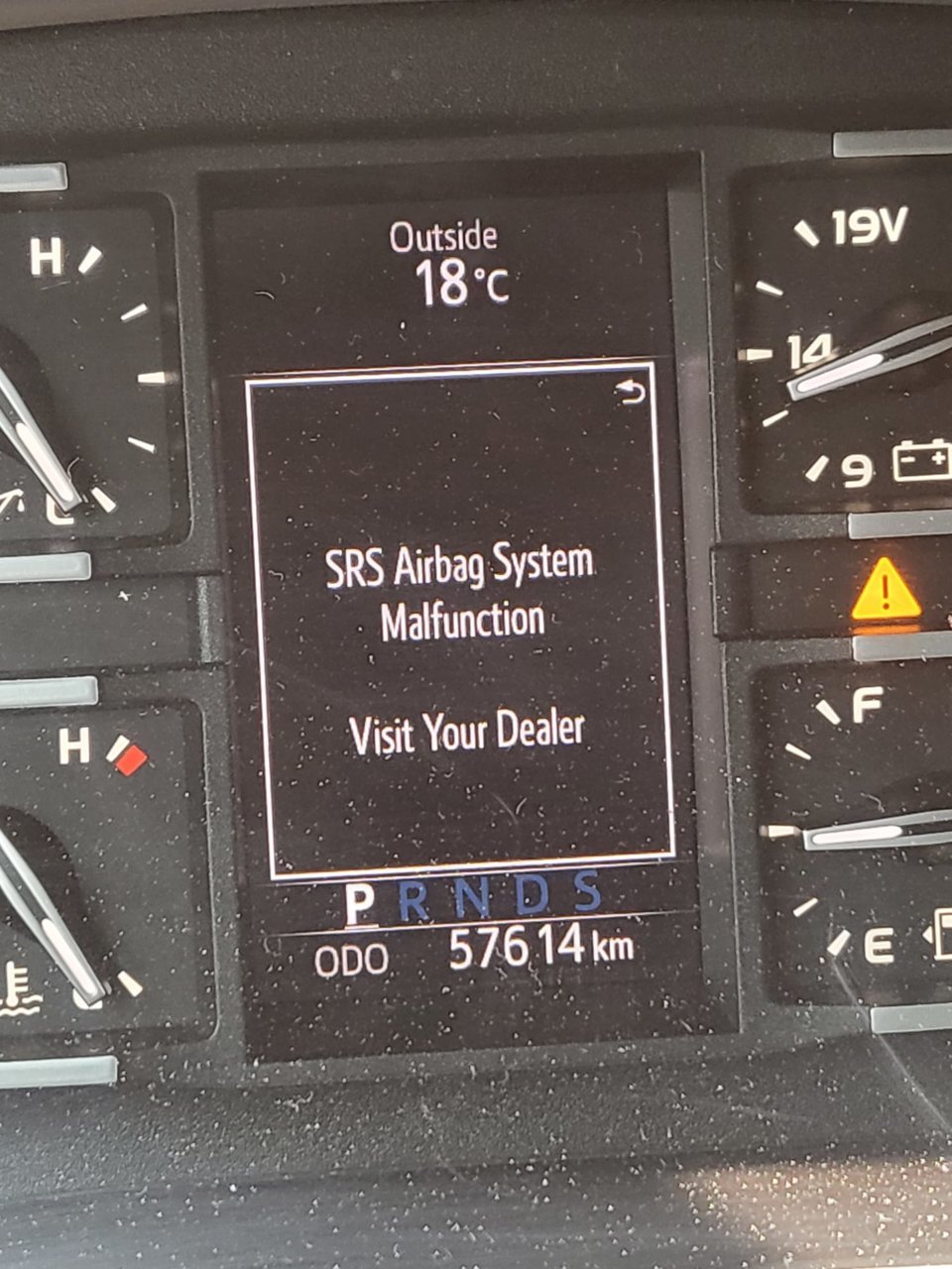

    When i connected the battery SRS alert showed up (i think that's because climate module is out)
    Maestro starts blinking red twice and stereo doesnt turn on. i Flashed with the
    ADS-RR(SR)-TOY02-DS (512) V3.8 firmware, Tundra non jbl amp. Checked twice the serial number

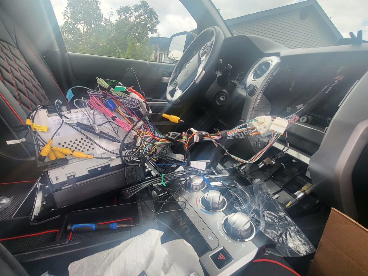

    here some pictures about my mess and thanks in advance :C
    I didnt know my tundra has an Amp, LOL

    okay So Crutchfield guys sent me another Maestro interface, i connected all wires like diagram says and boom: Worked at first try.
    So, i think i flashed wrongly on the first Maestro and from there didn't worked again or came with failure from the beginning
    Now all is working nicely
