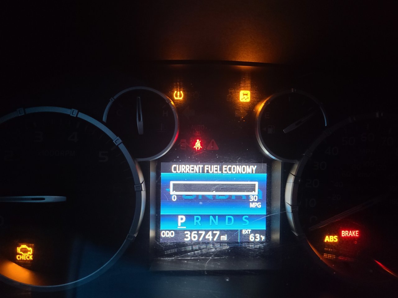

    after reading a lot about so 4hi 4lo blinking and cel and stuff i checked the fuse and it was bad , replaced it it last me 2 days and it popped again.
    someone told me to check the power outlets since they run on the same circuit so i took the plastic off and unplugged them from the back and prob going to put another fuse and run like that to see if it pops.
    but does anyone have an idea what could be causing that specific fuse to blow??

    so if i disconnect the battery and put a new fuse and put the battery back on it last for 2 days or more. if i switch them with the battery on the it takes 2 mins for the fuse to blow

    well i can tell you that my BSMS system never worked since i bought the truck but never had this issue of the fuse blowing. recently i had the light on the righr side mirror lit up for the BSMS while the one on the left didnt. so idk
    even when i press the switch it doesn't light up or anything. but never had the issue of a blown fuse like this since i bought the truck.
    dealership wanted 3000 to replace my abs module initially because when i took it i wasnt aware of the fuse and neither were they so they thought the module was bad , imagine if i take it to them.
