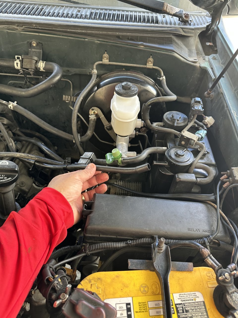

    My Tundra 2000 is leaking oil through the spark plugs on the driver side of the engine. If I disconnect the vacuum hose from that side the engine from the charcoal canister, the leak stops. Is that hose suppose to release pressure into the canister? Could the canister be clogged?

    bmf469 I thought it was that exactly and replace the sparks tube seals and the cover gasket. But it did again and the only way it stops is when I disconnect the vacuum hose from the charcoal canister.
    shify Thinking about it, I replaced the PCV valve and hose because the old pcv hose broke. Maybe the new PCV valve is damage.

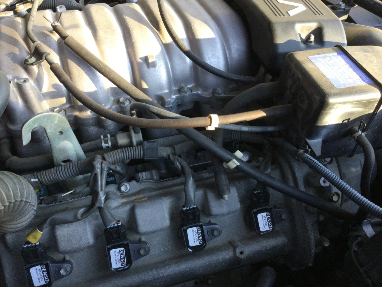

    Which hose are you unplugging? And is there a woosh of pressure? Positive or negative? V8?
  7. Mar 2, 2023 at 7:12 AM
    Shakapr
    Shakapr [OP] New Member
    Jun 8, 2016
    #3563
    12
    Rafael
    Puerto Rico
    Tundra 2000 Limited
    Mr. bee That’s the hose I am desconecting.
  8. Mar 2, 2023 at 7:14 AM
    Shakapr
    Jun 8, 2016
    #3563
    12
    Rafael
    Puerto Rico
    Tundra 2000 Limited
    Mr. bee It goes to the valve cover on the other side of the engine. It’s a V8. When I disconnect the hose I can feel pressure like pushing into the canister.

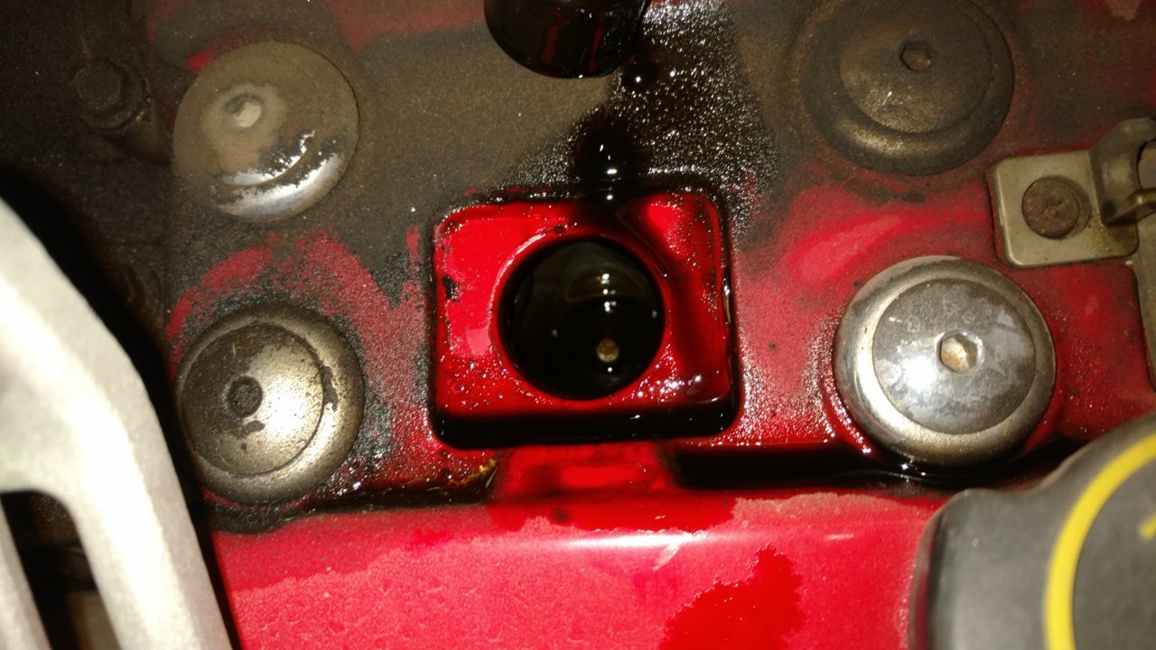

    That is reallll clean looking brake fluid or it needs some :notsure:

    Bubba W brand new break master cilinder.

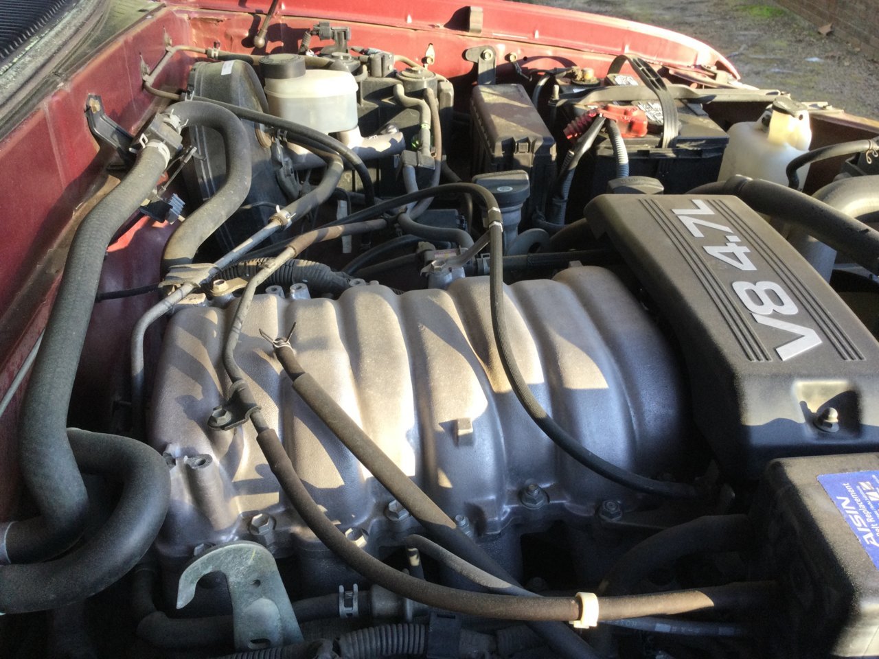

    yours is different from mine. My '02 goes into the tumor on the intake tube.
    @RUSTYNUTS or any other '00s wanna post a pic? But rusty might have a cali model, which may be different.

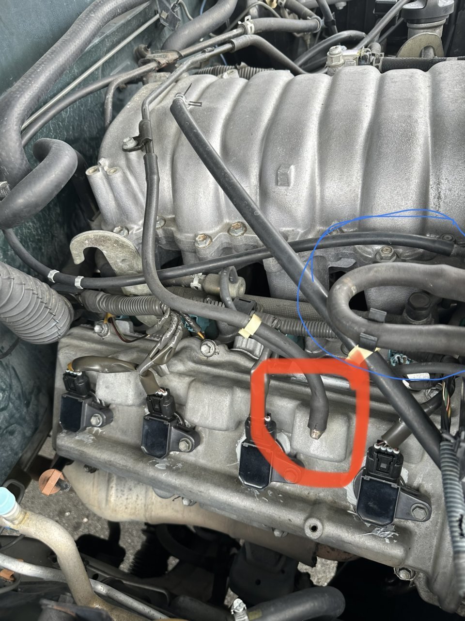

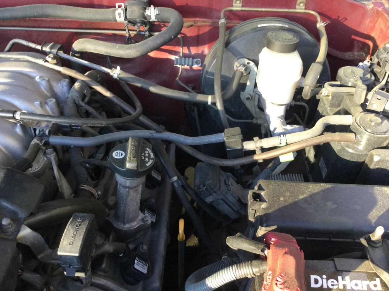

    This is what I was talking about... is this a second pcv valve?

    I havent opened the VC's but this just seems like a port that favors the pass vc and drivers side vc pcv's towards the tb.
    Front hose on my char canister does not have the port or cube baffle and also connects to the hardpipe over the 7th runnrr to the other side of the engine.

    That's because someone has put the hoses back on wrong. His needs to match yours.
    The one hose that goes back over the Intake is part of the EVAP portion for emissions(fuel) and the bigger hose is part pf the PCV portion for emissions(oil).

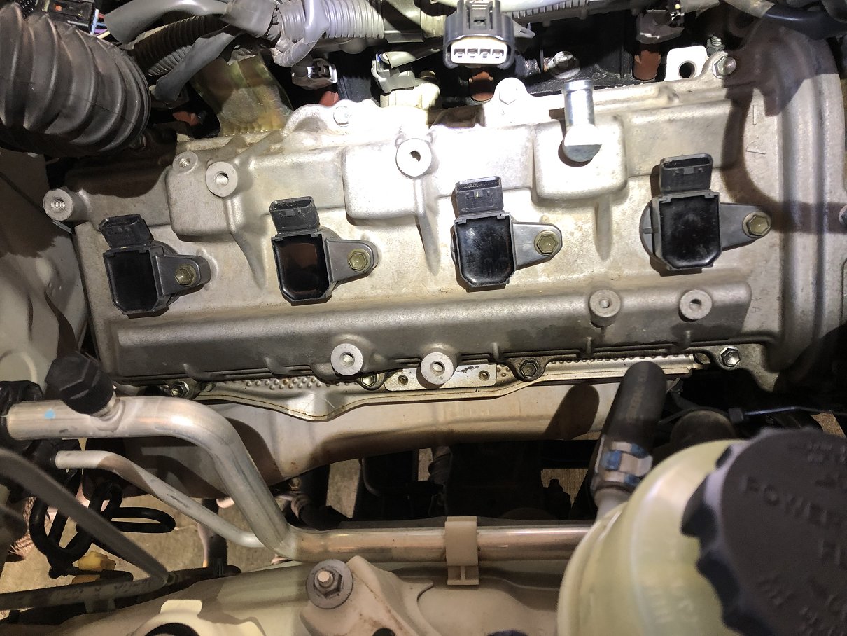

    My '06 has that too, on the passenger side valve cover, but when I changed out all my gaskets, it looked like it was just a regular 'ol port, nothing more.
    I'm glad my '06 doesn't have all that extra clutter and BS by the brake MC!
    This is the only pic I have from my gasket swap for that side:

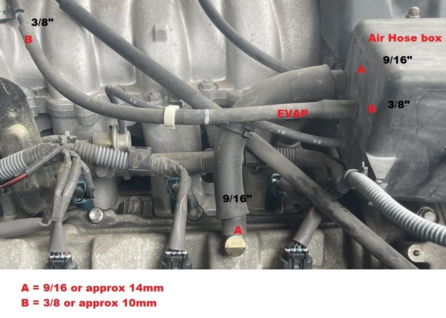

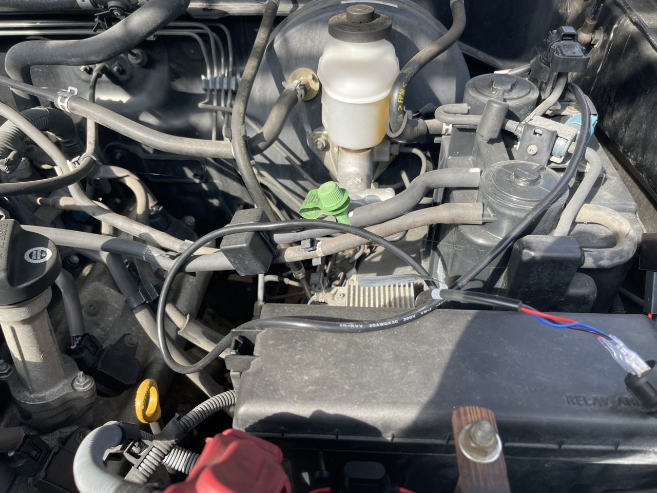

    @Shakapr , your 2 hoses need to be hooked up like this.

    BubbaW Mr.bee I told this was the solution. But tried switching the hoses, they are different diameters and won’t fit on the other ports. Still with the problem.

    They are indeed different diameters and that's the reason they don't fit properly. Your 3/8 ' hose B has been improperly placed on a 9/16" adapter A at valve cover, which enlarged it and will be loosey goosey on the 3/8 Air Hose box in it's proper place..
    Mr Bee's 2002 Air Hose box and your 2000 Air Hose box are the same Toyota part #...2000-2002 Toyota Tundra Air Hose 17880-50040 | Toyota Parts (mcgeorgetoyota.com)
    You have only a few choices...
    1) use hoses you have and synch hose A properly to air hose box with wire tie. The 9/16" Hose A should still fit properly into it's proper place to the valve cover.
    2) Go to your local Napa or wherever and get new proper hose sizes
    3) order new OEM hoses
    4) leave like is and continue to suffer consequences

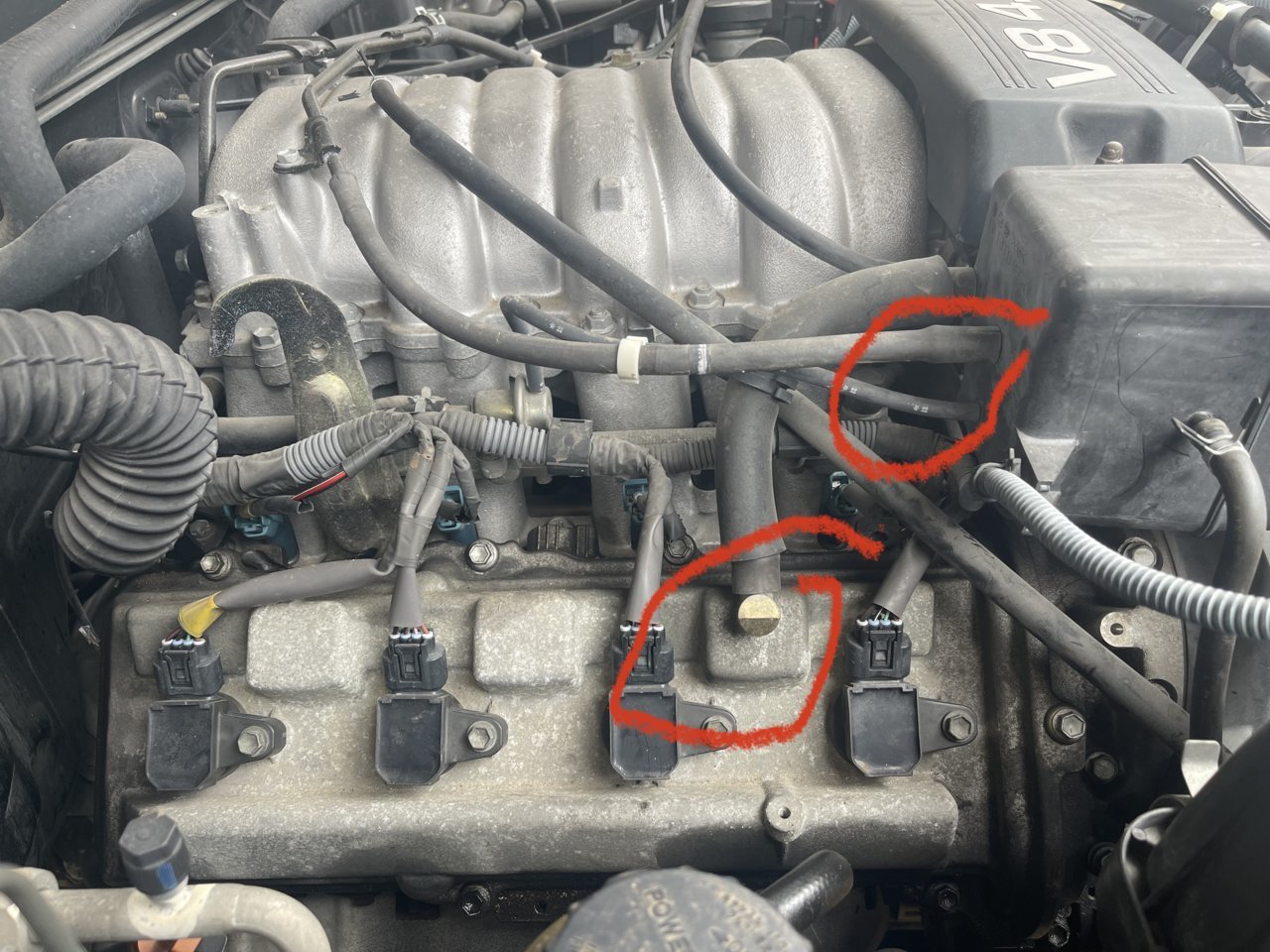

    BubbaW Mr.bee I the photo from the same angle as Mr. Bee, I do have the same connection as his truck. The problem has to be something else and I running out of ideas.

    The connections that are wrong are on the passenger side by air filter. The pic above the post you just made is the way your hoses on Passenger side needs to be.
    You’re showing hoses on drivers side

    We can’t quite see the front of the engine in your pics, but it looks like the fat hose is just looped over to where the skinny hose should be. Try moving the hoses around to match the other examples on here.

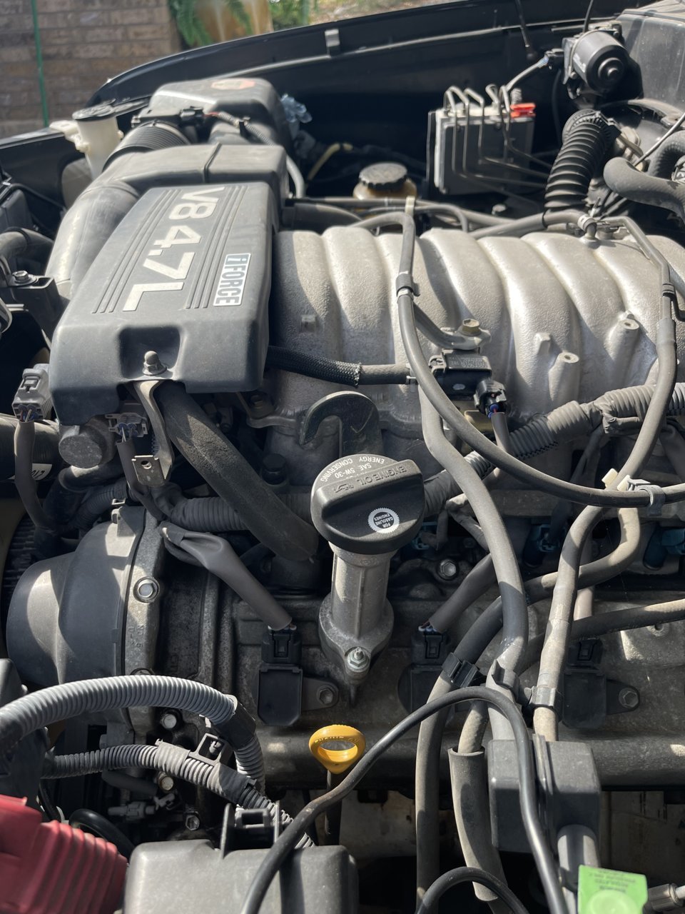

    BubbaW Mr.bee PenderBen Switched the hoses on the air filter side and the problem is solve. Appreciate all for your help!!!
  27. Mar 4, 2023 at 2:29 PM
    #27
    bfunke
    bfunke Tundra Curmudgeon
    Oct 13, 2019
    #37321
    2,400
    South Carolina
    2018 SR-5 CM 5.7, 2000 SR-5 AC 4.7L

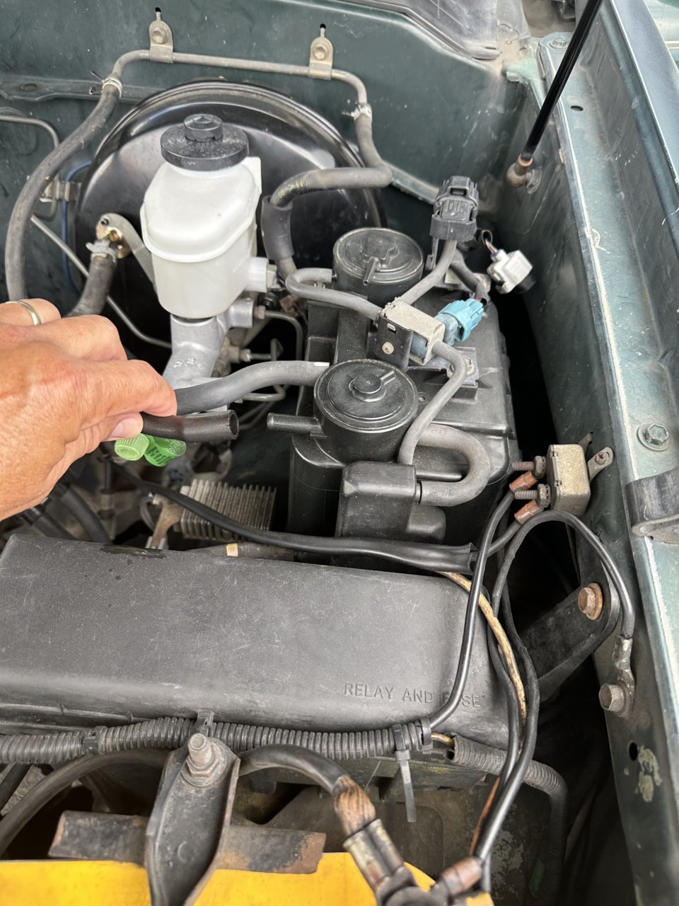

    Here are pics of my totally stock 2000. Sorry for the filthy engine but we’ve had a pollen blizzard in SC. Also noticed squirrel attack on my battery today
