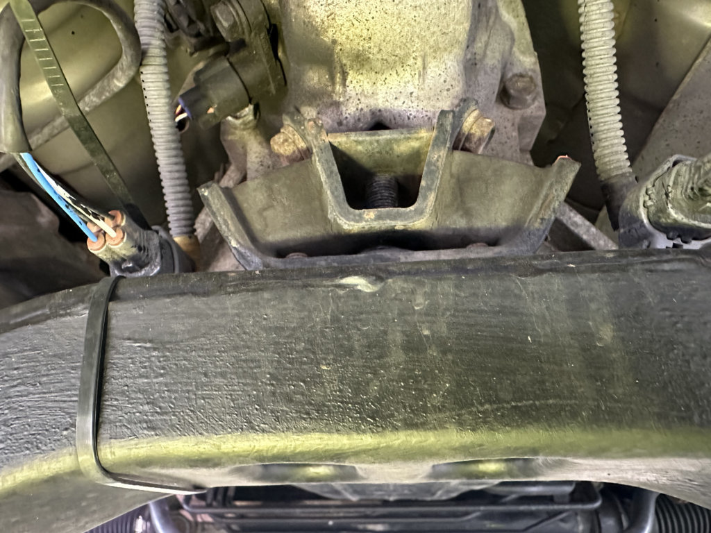

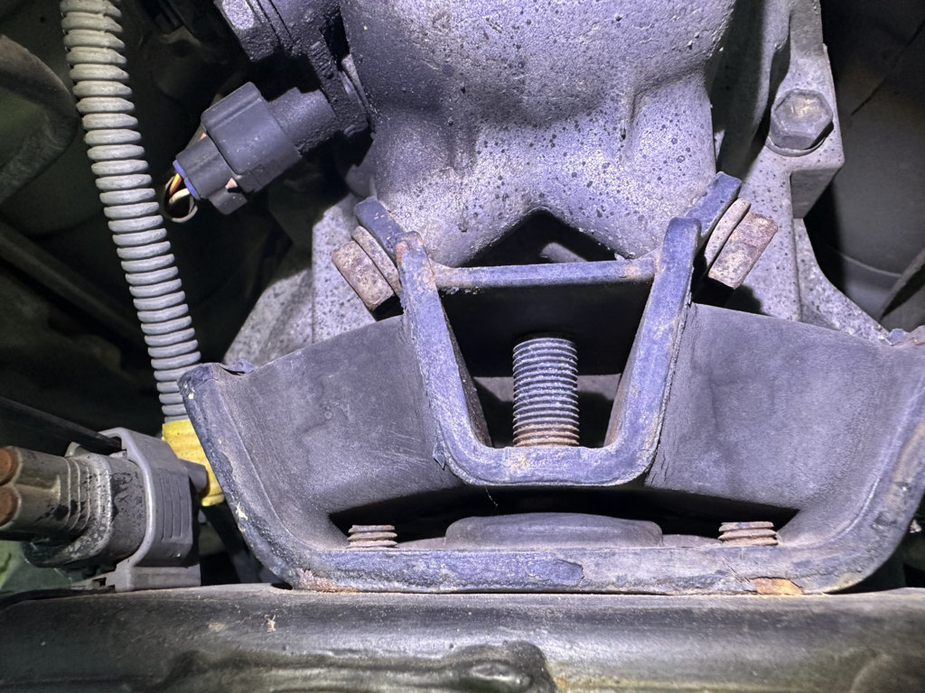

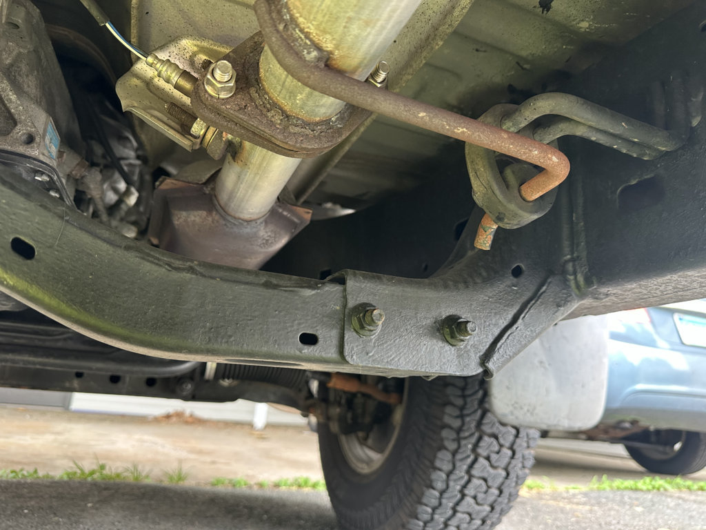

    2wd has no zerks on the driveline.
    Check the trans mount for missing/loose bolts or cracking of the crossmember. There's a TSB about it.

    Shame you did the motor mounts instead of the transmission crossmember mount. The motor mounts rarely / never fail on these. The transmission mount in 2wd trucks has a tsb as listed above by @assassin10000 . The crossmember can be cracked and often bolts are missing. Do you have the LSD rear end? Common for those to shudder when the fluid needs to be changed, or the clutches get worn.

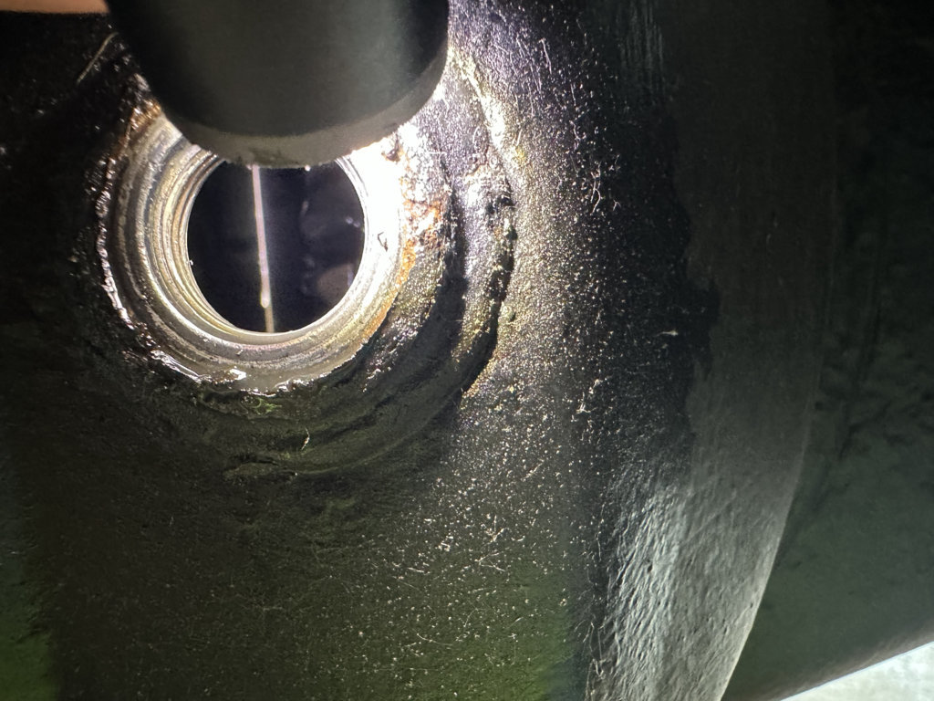

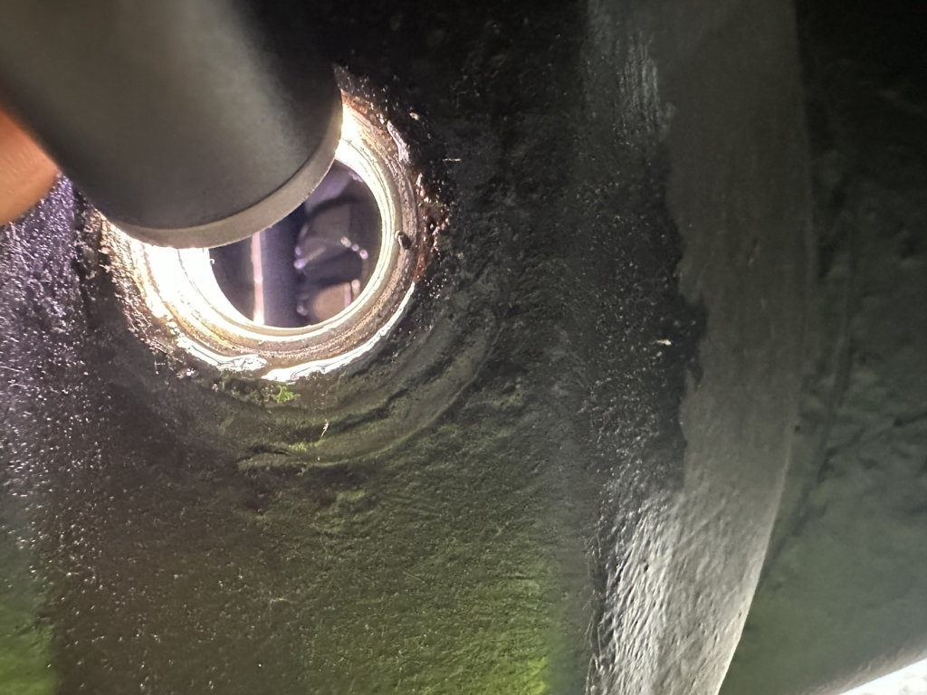

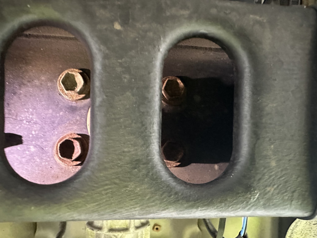

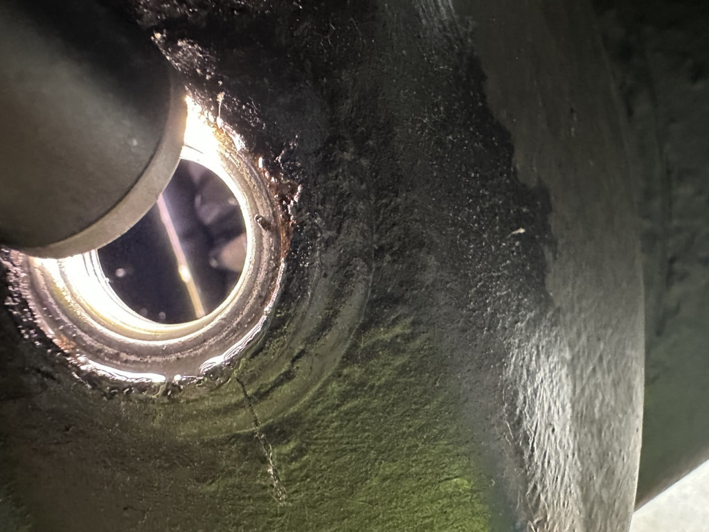

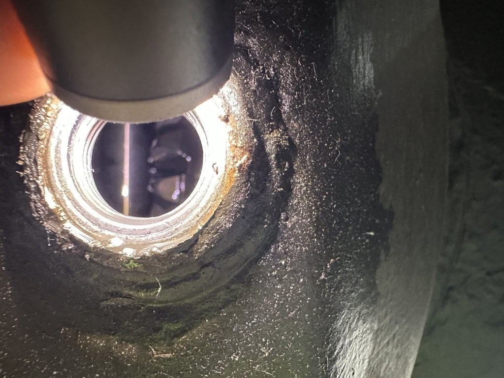

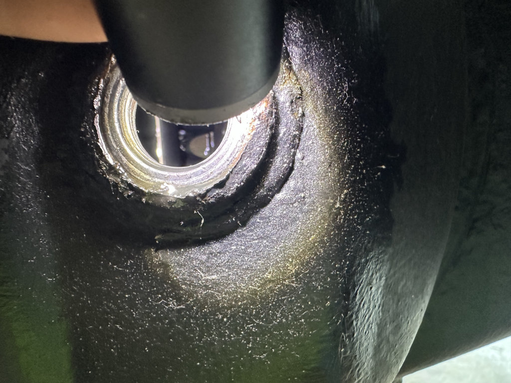

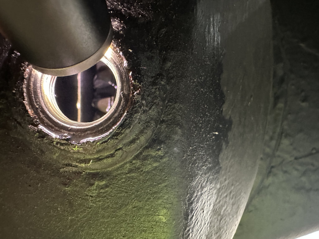

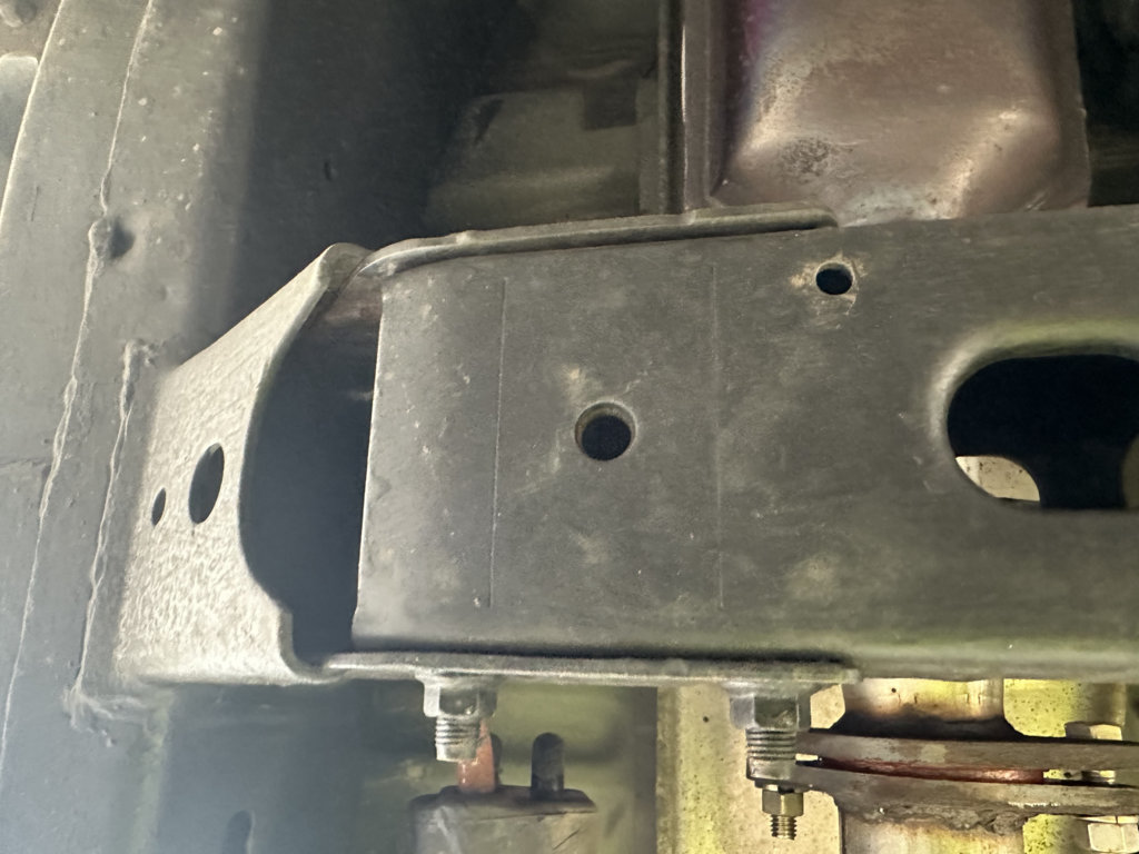

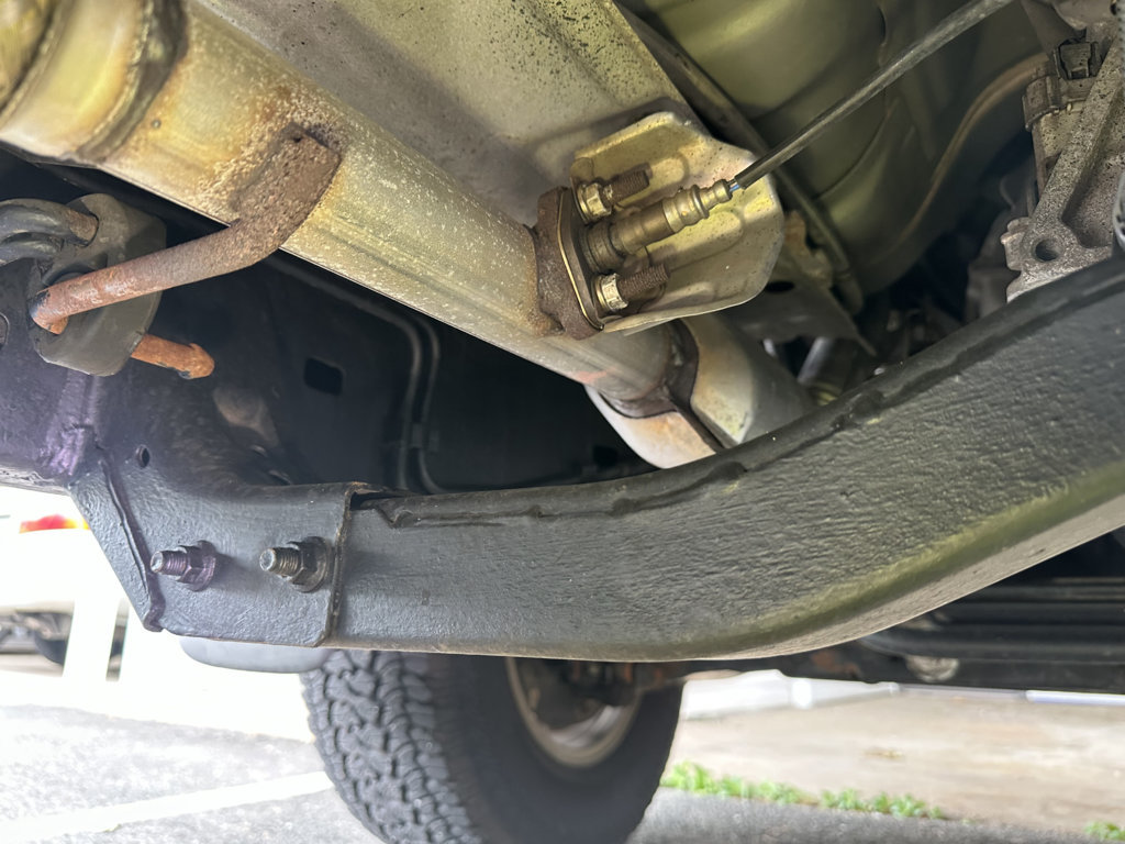

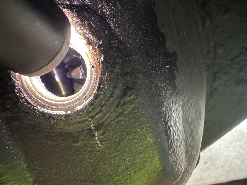

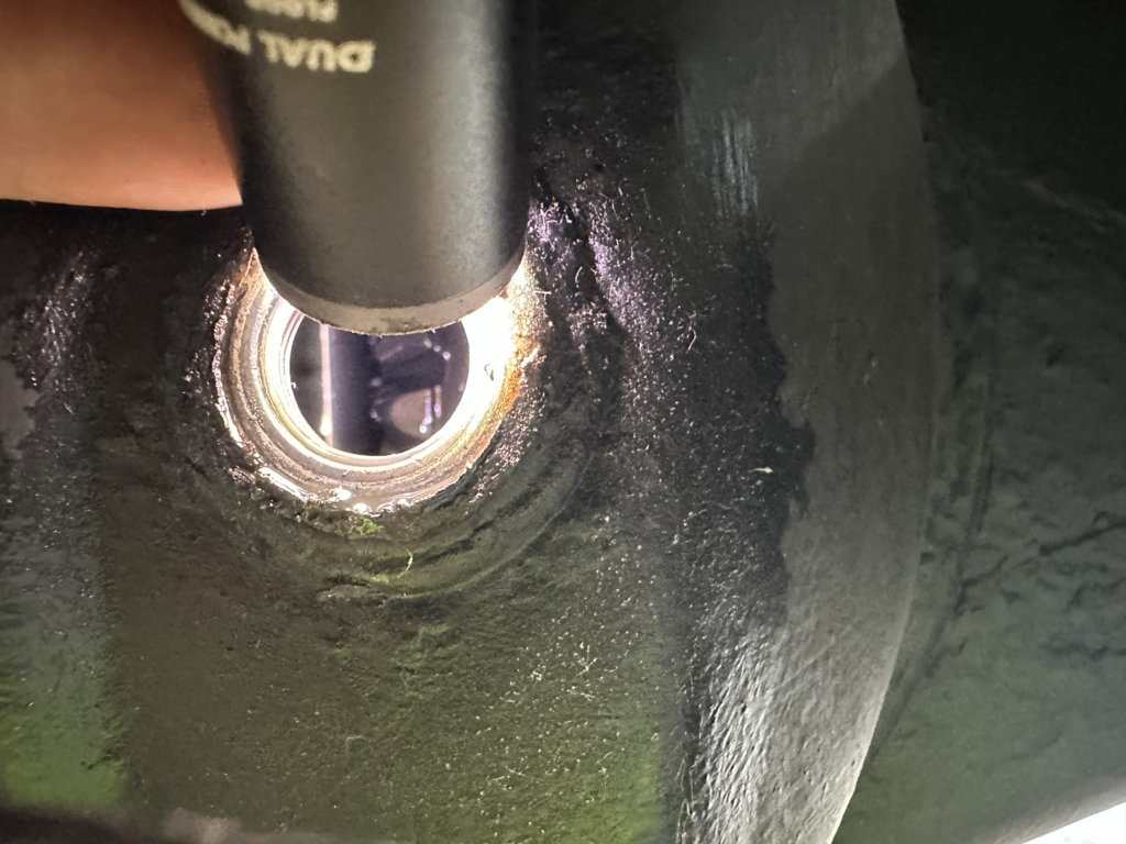

    There are no ZERK fittings, I had to remove driveshaft for carrier bearing and replaced two u-joints and the others had no play. I don't see any cracking on crossmember. As far as LSD, I cannot figure out if I have it or not, so I removed 24mm fill bolt and snapped pictures, hopefully you folks can tell by the pics. I should add, the only fluid I have not changed is the Diff bc I could figure out which Diff I had (LSD or not) and which fluid to use. Sorry for the many pictures, not sure which angle will help you best.
    Tranny mount + cross member:
    IMG_2620.HEIC.jpgIMG_2617.HEIC.jpgIMG_2624.HEIC.jpgIMG_2623.HEIC.jpgIMG_2619.HEIC.jpgIMG_2618.HEIC.jpg

    Open diff. Can see cross pin and spider gears.

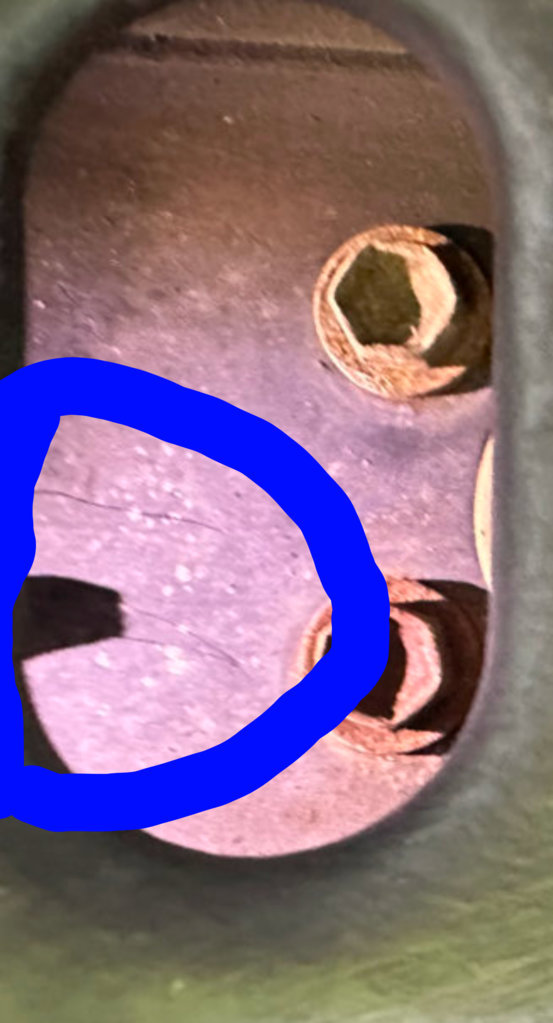

    Possible cracks:

    Yup - those black lines next to the bolts may be cracks. I would remove the crossmember to better inspect it.
